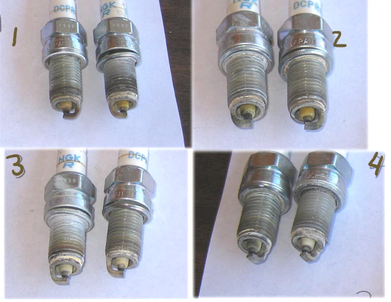

Just looking for some opinions on my plugs after 50 hours on a new 912uls. I'm running 100% 100LL with Decalin. Cylinder 2 runs 20 degrees cooler than Cyl 3 on the CHT's. Cyl 3 will run 235 at 72 degrees. And 243 at 80 degrees. The picture doesn't quite capture whiteish deposits throughout.

They look normal to me. Put them back in.
gap to .027

The recommended plug gap is .023 to .027
Usually the narrow gap is better for cold weather. The narrow plug gaps do aid in starting when cold, but usually the wider gap is better for summer running. It won't hurt to have a narrow gap in the hotter months, but it does tend to run better with a wider gap for hotter weather. If you are changing your plugs between 75-100 hours the gap shouldn't change but slightly. If you leave them in longer then they should be cleaned and re-gapped. I never leave a plug in longer than 100 hours.
