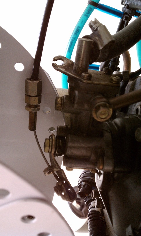

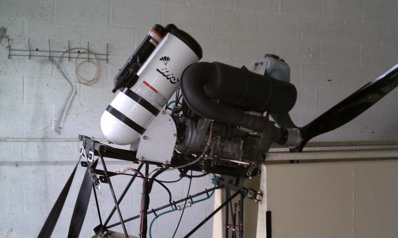

1) Recently i picked up a BRS for my firestar II and just got to trying to mount it today. I mounted it as far forward as possible as so it doesnt hit the small support tubes coming off the main tube its mounted on, had to tilt it slightly so it doesnt hit the starter....but not the oil injection pump arm cant move freely. What are people doing for this? I tried to bend the arm in a way that it would work behind it but not much luck...
What would be needed to remove the injection system all together and just premix? A block off plate or something?

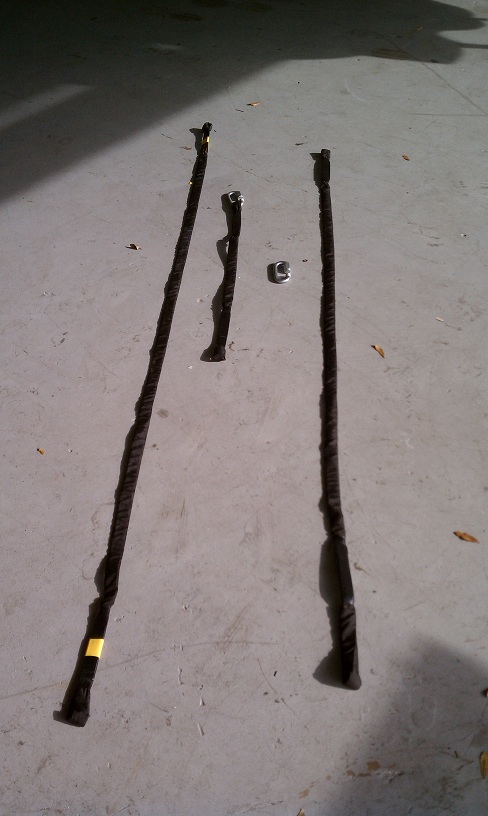

2) The brs came off of a trike and has 3 bridals and im really not sure which one to use. There is a 30", 82" and 92" with two heavy clips. Which of these (or all of them) should i use? How are your rigs setup?

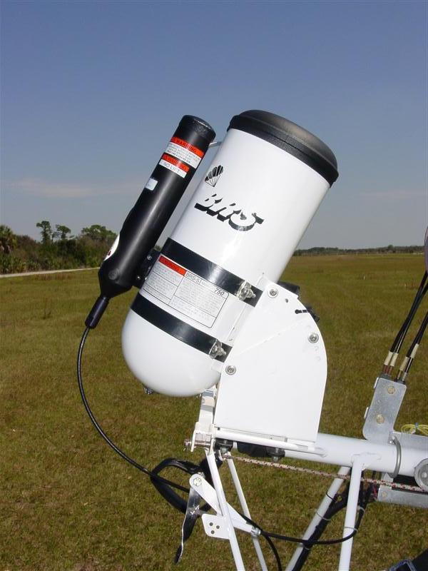

Dylan:
Mine is mounted all the way forward. Does not interfere with any of the small tubes.
Ask BRS about the bridle for your plane.

Thanks for the pic, i kind of tried it there and thought it wasnt going to fit....would certainly help a lot if it could. Ill try again tomorrow.

BRS will send you detailed instructions for mounting your chute; the instructions are make and model-specific. THEN - they urge you to take photos and send them the pics so they can advise you as to whether it's mounted correctly.
