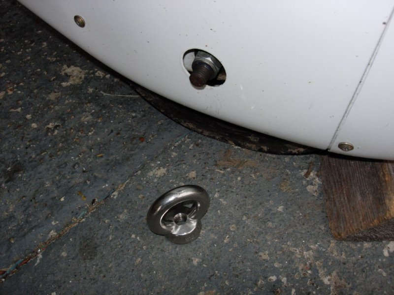

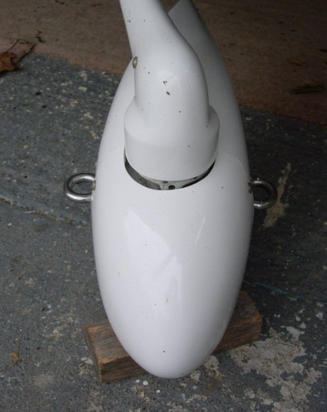

Further to my earlier email I have now photographed my tie downs and these are attached.
2564 and 2562 show the nose wheel with the bolts on and off the nose axle bolt.

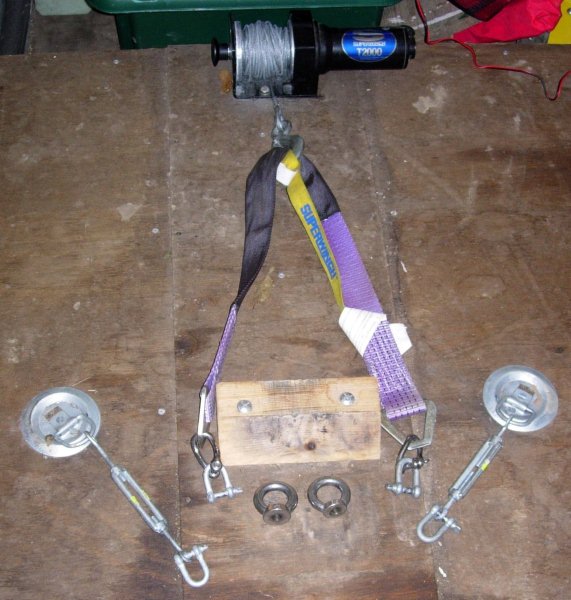

2561 shows the winch, straps and tie down bottle screws ready in place.

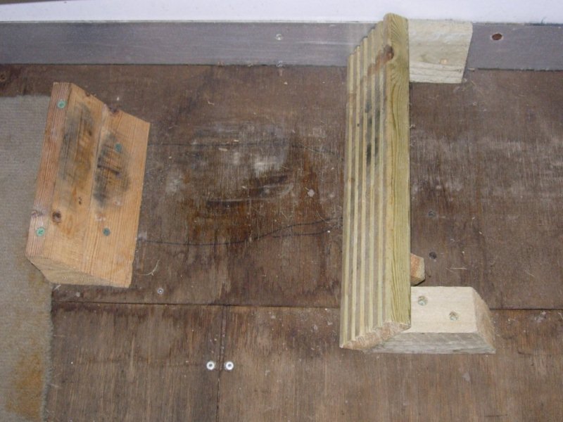

2559 is the mainwheel chocking arrangement. Nothing ties down the main wheels but the chocks hold the aircraft in place.
