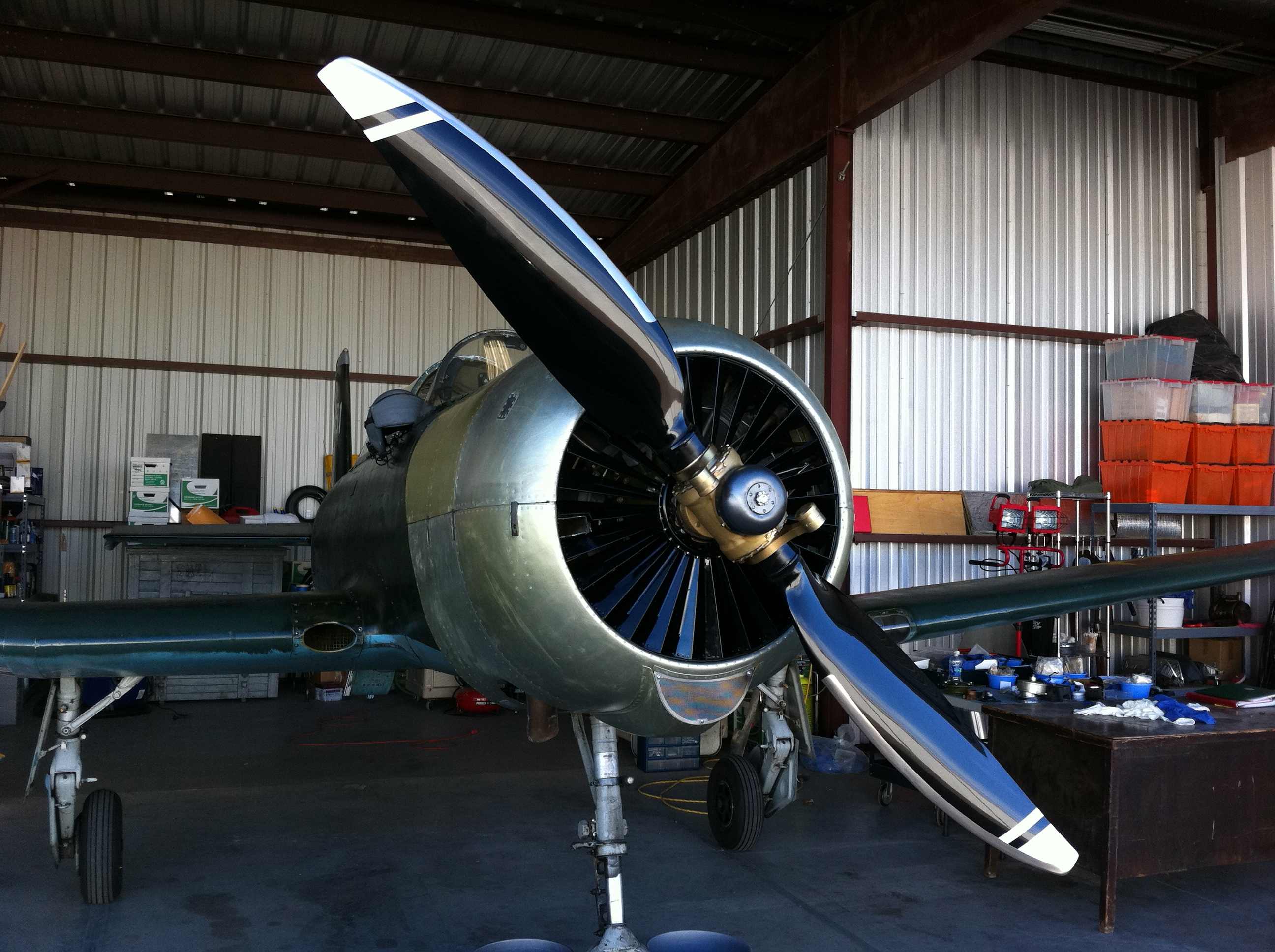

PostPosted: Mon Jan 17, 2011 6:18 pm    Post subject: Whirl Wind Prop Reply with quote
Oliver,
Flew my CJ-6A with the new Whirl Wind V530-WT composite blades for the first time on Saturday. Some observations...
• Performance is very good in the climb.
• Not a surprise, there is drag at reduced power / RPM. Landing required some power to maintain airspeed. No problem, just different.
• May require some hub changes. When Bill Blackwell did the first test flight last week, RPMs jumped up past 160 KIAS. I noticed the same. Jill and Carl will chase this for me.
Initial experience is very positive. Here is a picture with the airplane now back in my hanger at FFZ.

Theoretically, this should perform well as a cruise prop. So far, have done only one short airport-to-airport flight. Seemed to need about 600 mm manifold pressure with RPM at 82% for 120 to 140 KIAS. Will let you know the stable settings and airspeed after a cross country flight towards the end of the month.

As propeller disk size increases the static thrust increases.
As the disk size increases so does drag.
Static thrust does not directly relate to higher cruise speed.
Static thrust does increase climb performance at the cost of higher cruise speed with large dia props. Go faster add more blades and reduce dia.
No free ride. MT says that the blade shape has little to do with performance between their straight blade or curved blade.
It just depends on what you like to look at. Sikorsky developed a
variable dia rotor system for the tilt rotor that demonstrates this
in a way over the top example. It increases the cruise speed as the
rotors are retracted and disk drag decreases.

Just an observation since I'm not a CJ kinda guy but flying under square vs over square is costing you in performance. If you are setting pitch at 82% you should have your manifold pressure at 82 to 85% depending on altitude for the single stage super charger. What are the nominal prop and manifold settings for the CJ from the handbook? I thought CJs reported prop revolutions as RPM not %RPM? I do not have my YAK 52 pilots handbook at hand currently to quote verbatim from but... I use nominal 1 settings for best economy as 60-62% pitch and 60 -65% manifold pressure. Square would be 60-62% and 60-62mmHg. Nominal 2 is 64% and 65 mmHg in the RU manual as I memorized. Over square would be 64% RPM and 70%. at higher manifold pressures you have the engine pushing the prop not the prop pulling the engine AT high Rpm but low manifold pressure. You are akin to putting the car in second gear to climb a hill but giving it little gas by not mashing the accelerator so the engine loads up and stalls. If you increase mmHg (manifold pressure) to square 8o% and 800 mmHg I think your cruise speeds at the higher performance power setting will improve to around 160-170 it's range.
Now maybe I've just committed mental masturbation here if the initial post was a typo. 600 mm manifold was really 800 mm.???

Doc,
This flight was not a good test. Just from DVT to FFZ and in formation with another CJ and a T6... with purposely slower indicated airspeeds. As such the MP was all over the place for station keeping. Need to take a bone fide cross flight to better appreciate the performance. Will do this on the 29th up to Kingman to visit Jill and Carl.
Also, was flying with a zero time M-14P which now has only about 1.5 hours. Still need to do a break in.
Lots going on.
