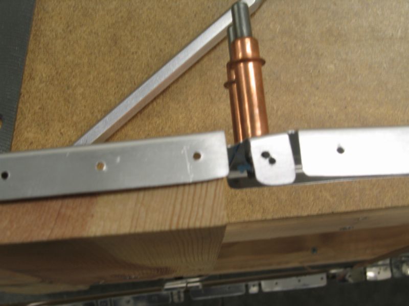

I must not understand how to search the archives correctly or perhaps what words to use for this one. I know it was discussed before. Anyway....
Problem: I have an extra hole (in my Tailcone top skin, fellas, sheesh.)
I didn't even know I had it until I began peeling off the plastic to get ready to final deburr my Tailcone front top skin. Sure enough there are two holes in the corresponding tab of the rib. Picture attached. Van's says to dimple and rivet and move on, since it's only one mistake in a long row of good holes. However, the holes in the skin are so close together that any dimpling will break through and make it a big hole. What to do?
John Jessen
~328 (this is my first mistake, of course)

recapen(at)earthlink.net Guest
Posted: Wed May 03, 2006 1:15 pm Post subject: Errant hole in top skin of Tailcone |
This looks like a flange rather than skin....you can cut off the flange and replace it with a piece of the same thickness bent to the same angle - on the inside of the rib - it'll be less visible if you're worried about that. Rivet the replacement tab with a couple of nicely spaced rivets and you'll have a new tab to drill in to ..
Been there, done that - tech inspector liked it too.......

Deems Davis
Joined: 09 Jan 2006 Posts: 925
Posted: Wed May 03, 2006 1:20 pm Post subject: Errant hole in top skin of Tailcone |
John, put a doubler of the same (or slightly larger material behind the
correct hole (make it match the size of the double drilled tab) . match
drill it and then use a longer rivet when it comes time to rivet. you
could also consider all of the above and drill for a larger opps rivet.

LIKE2LOOP(at)aol.com Guest
Posted: Wed May 03, 2006 1:59 pm Post subject: Errant hole in top skin of Tailcone |
In a message dated 5/3/2006 4:57:32 PM Eastern Standard Time, jjessen(at)rcn.com writes:
| Quote: | | However, the holes in the skin are so close together that any dimpling will break through and make it a big hole. What to do? |
John,
I did this when i was dimpling the VS skin, and it moved before i hit the dimpler, and then noticed... ouch! I flattened out the wrong hole and dimpled the correct hole, and placed a rivet. The extra adjacent hole is tiny at one edge of the rivet, and will be filled before i paint. There are more then enough other rivets to hold it together. In your case, i would NOT dimple it or the hole gets bigger and you can not fit another rivet in that close to the correct hole. This is not as critical as... say an engine mount bolt hole.
Keep on going.......
Steve

jjessen
Joined: 22 Apr 2006 Posts: 285 Location: OR
Posted: Wed May 03, 2006 2:50 pm Post subject: Errant hole in top skin of Tailcone |
Deems, thanks. I think that the problem I'm staring at is that if I do
anything to either hole in the skin, the tiny amount of metal between the
two holes will break through. I might try John G's suggestion of a metal
epoxy, which I've never heard about before this. Van's said that one rivet
will not be missed, so I think as long as the holes are deburred, if I can
even do that, so they don't split, then I might epoxy the skin to the tab at
that point and hope it holds.
John J 328

jjessen
Posted: Wed May 03, 2006 10:30 pm Post subject: Errant hole in top skin of Tailcone |
Ok. The holes are now no longer two. They joined as I thought they would as soon as I tried to deburr the original. Here's a picture. Any further advice?
John Jessen
328 Tailcone.

VHMUM(at)bigpond.com Guest
Posted: Wed May 03, 2006 11:04 pm Post subject: Errant hole in top skin of Tailcone |
As Vans says 1 hole will not be missed ....stop stressing move on and have fun....
Chris
RV6 VHMUM Sold
40388

owl40188(at)yahoo.com Guest
Posted: Thu May 04, 2006 2:49 am Post subject: Errant hole in top skin of Tailcone |
Hey John,
I will get my 2 cents in here.
As per your advice from Vans I don't think its a problem with strength. I would use one of the oops rivets here just so that the hole gets cleaned out a bit. Past that you can bond the two pieces if it makes you lfeel better but I wouldn't loose sleep over it.
Niko
40188 Fuselage floors
| Back to top |
sfdarton(at)yahoo.com Guest
Posted: Thu May 04, 2006 7:45 am Post subject: Errant hole in top skin of Tailcone |
John,
I would cleco the skin to the underlying part and
re-match drill that one hole only, larger for an oops
rivet. If that hole is elongated I would then dimple
the skin and rib together. Move on and have fun, it's
not a big deal.
Steve 40212

deej(at)deej.net Guest
Posted: Thu May 04, 2006 7:54 am Post subject: Errant hole in top skin of Tailcone |
John Jessen wrote:
| Quote: | Ok. The holes are now no longer two. They joined as I thought they
John Jessen
Hi John,
I'm not a metal working expert, nor do I play one on TV....
I think structurally you would be fine to leave it as many have suggested.
If it is a cosmetic thing (as it would be with me), perhaps use some of the
metal epoxy to fill in the hole in the skin, and in the rib, and then
re-drill it through the epoxy after it sets? I really don't know if
this will work, and
I'd recommend trying it on some scrap first. I'm also not sure about
being able
to dimple it afterwards.
I suppose you could cut the head off a flush rivet, and epoxy the
head of the rivet in the hole and then fill in the rest of the hole with the
epoxy. That should at least take care of the cosmetic part.
Or perhaps leave it as-is for now, and after you have riveted all of
the holes around this one,
you could literally epoxy an entire rivet into the hole and fill around
it with
the epoxy. You'd have to make a best effort at dimpling this hole as it
is now, though.
Dunno, I'm just thinking out loud here...
-Dj
