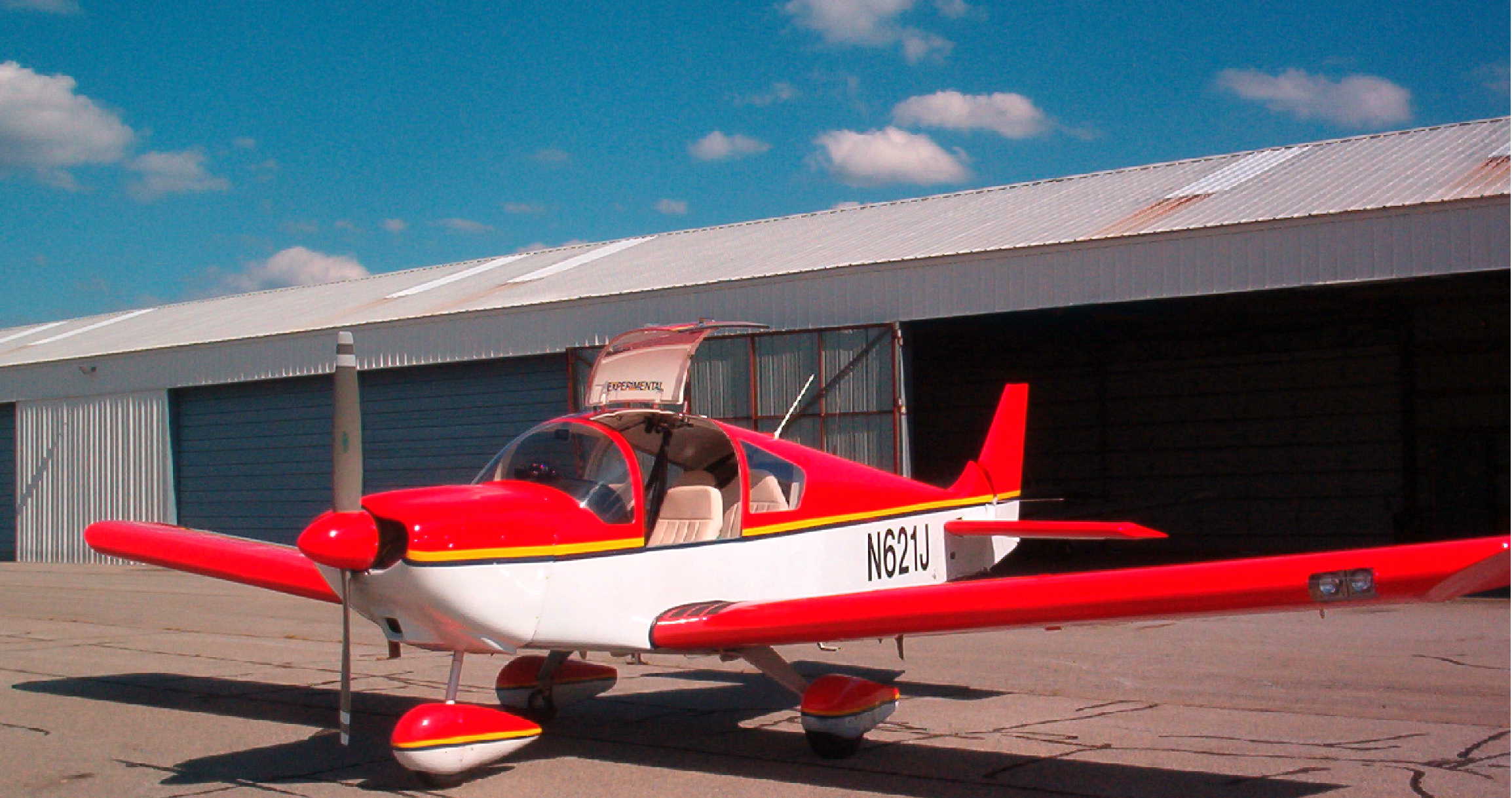

steveadams
Joined: 10 Jan 2006 Posts: 191
Posted: Thu May 04, 2006 3:52 am Post subject: Re: Paint |
I also used the AFS paints, mainly for the safety issues, it's not flammable, and it's easy to clean up.
