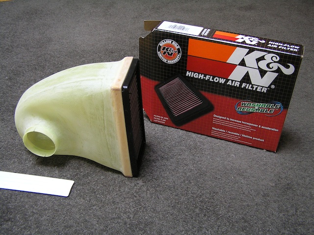

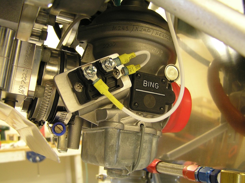

briana(at)xtra.co.nz
PostPosted: Tue Jan 04, 2011 10:49 am    Post subject: A real request not a test Reply with quote
Martin,
I've just made an air intake, and an electric carb heat system for the Jabiru 220o that is going in my Flitzer. Wondering if these might help. There are photos on the Jabiru Engines Yahoo group, but maybe you are not signed in there. The issue of being close to the firewall sounds similar, so there is not much room for an air intake box. The electric carb heat system, I'm hoping, will be OK for NZ conditions, especially for flying an open single seat biplane. UK conditions might require more attention to carb heat, although it is probably pretty warm under the Pulsar cowling.
I've attached a couple of photos. Can send more details if you are interested.
Brian

martin.board1950(at)googl
PostPosted: Fri Jan 07, 2011 7:51 am    Post subject: A real request not a test Reply with quote
Brian,
Sorry for the delay in coming back, Your intake looks very interesting and a similar sort of concept to what  I had fitted on my old Jab engine. It worked really well with no performance or engine o/heating issues. My new engine is much more of a problem and very close to the firewall. I have a number of ideas and the favourite - I think - is to penetrate the firewall with a stainless tube ( belled out cobra style) and to then come back out into the engine bay. By eliminating my current hot air system with the electric heater I gain some more space for an improved filter system,
Martin
