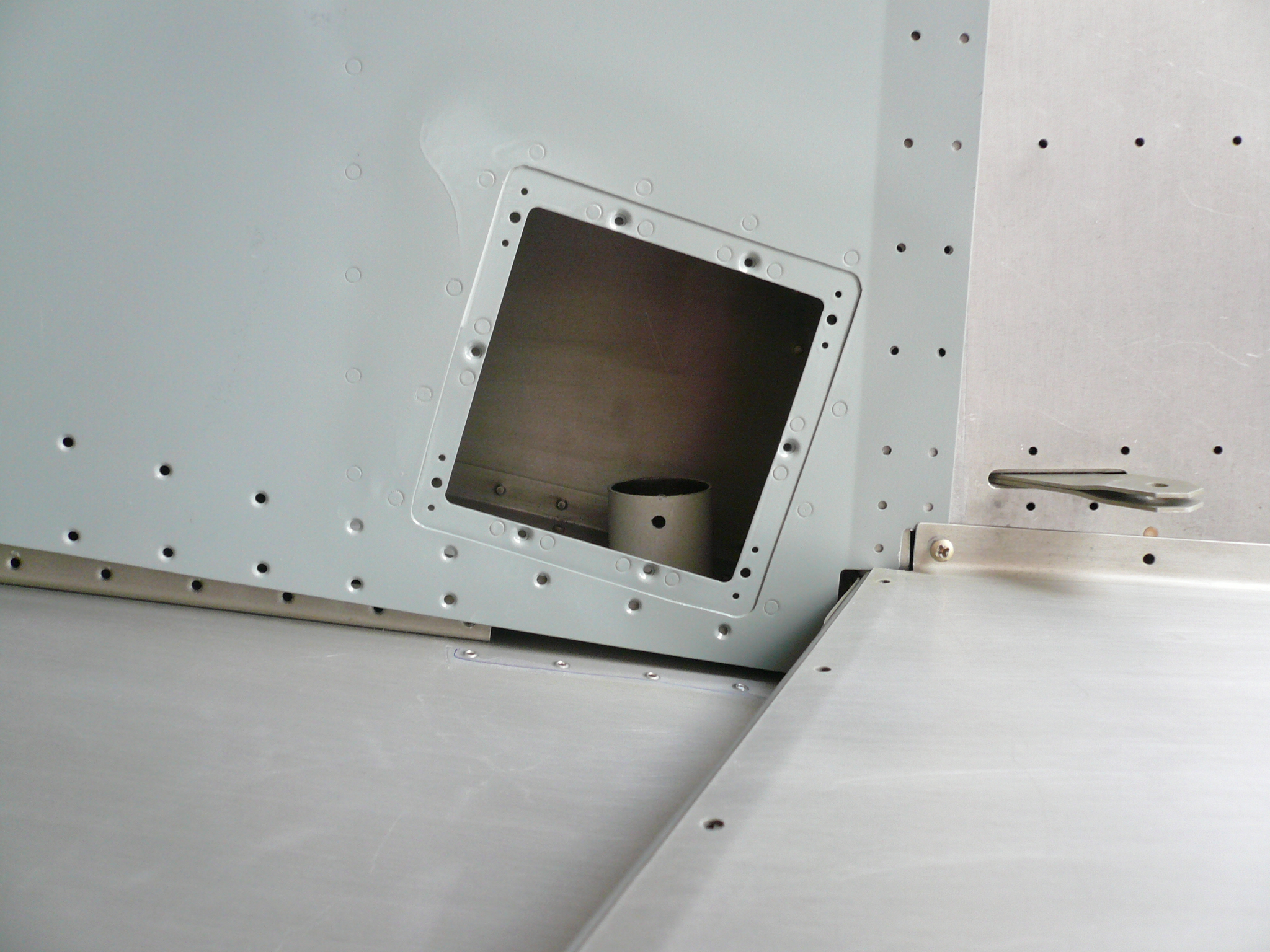

I knew that this was a problem area (had a problem with my Piper) so I did the access plate hole which provides for access to the bolt - plus an inspection cover for annual

Do you have a picture of panel and location?

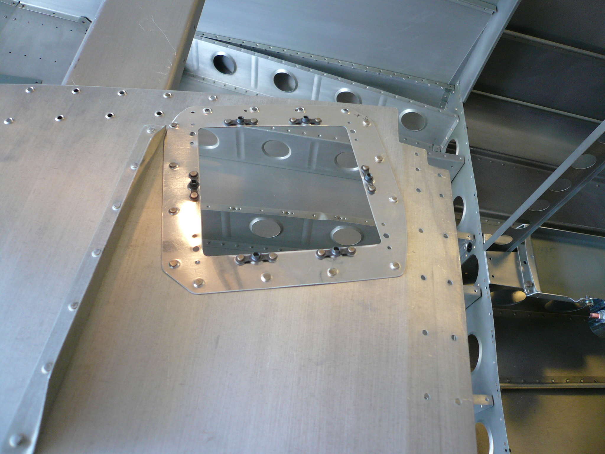

Attached is picture of the doubler plate for bolt access hole. the whole job took about 4 hrs in all. Remember that the side panel fits here so check and fit carefully. Note that the doubler is cut away. As I recall these are the same pieces as the pitot access plate on the wing.

I installed my access covers last night, and they look just like the ones in the photos above. Only difference is that I put a bit of a joggle in the doubler where it runs under the rib, but perhaps that isn't necessary.

From what is looks they are the stall warning access parts VA-195C/D
see Section 19.

I think that you are correct and the plates are actually from the stall warn access plate not the pitot access plate
