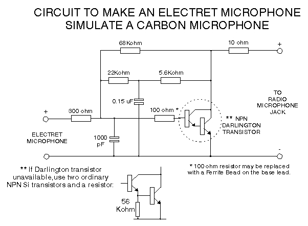

Are all electret mics the same?
The microphones are all built on the same technology.
The ELECTRONICS that converts a delta-charge into
some value of delta-voltage is super simple. Bias
the microphone element up through a resistor and take
the audio off the junction between microphone element
and resistor. Aircraft radios are unique amongst voice
communications technologies. WAAaayyy back when, the first
radio-telephone transmitters were fitted with the most
popular microphone technology of the time that was
shared with the telephone.
Like the electret mic, the carbon mike needs to be powered
by it's associated circuitry. The carbon microphone
is a relatively low impedance, variable resistance, high
output device VERY suited to the telephone which takes
operating power from the wires that come into the back
of building.
The electret is a high impedance, variable voltage, low
output device. It also needs to be powered. But to emulate
the legacy carbon microphone, it needs some electronics.
An exemplar circuit is shown below.
[img]cid:.0[/img]

To summarize what has been said,
- Its likely that an aviation radio headset output would overdrive these speakers (resulting in poor volume control and possibly poor quality output), and may suffer some damage to the radio audio amplifier (unlikely).
- To use these speakers/phones I will probably need an audio isolation amplifier (made as described in Bob's note)
- Alternatively an amp from ebay may suffice ( for $6 seems a no brainer Smile ) - but may require some power conditioning (interesting that specs say 4.5v, but legend on board says 12v), and also some gain setting resistors [how do I calculate the value?]
- To use the electret mic I will have to build a circuit per Bob's sketch.
I think there are are potentially 3 ways ahead.
1. Buy amp above and start making mic circuit (perhaps gives the ability to add an ipod input in the future)
2. Cannibalise an old headset (at least all the components should match)
3. Use the Halo headset for the time being and just figure out sticking the ear plugs in my ears with the helmet around my neck ...
Thanks for your help, Peter
sketch.
This too will need to be brass-boarded and checked
on the bench. Do you have a harness to run the radio
on the workbench?
