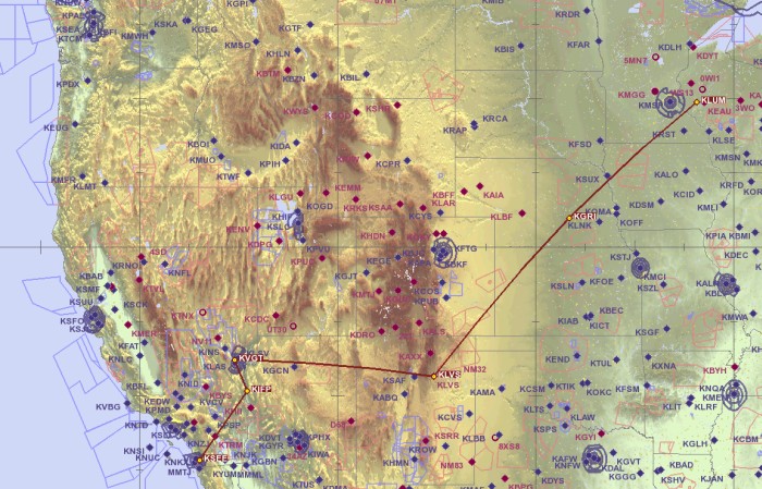

Ok, so I'm paranoid...
There's a chance that I might be forcibly ordered to fly from
Wisconsin to San Diego, CA for a wedding on July 1st. It's
*only* a 12 hour flight, so that's no problem. The problem
is, I'd be flying down to New Mexico, across the Grand Canyon,
and then up to Vegas and down to San Diego. One thing I
did some research on is the average daily temps, which get
into the 102-108 degree F range in those SouthWest states...
and that's "average". The other much more minor issue
is the mountains, as it looks like on my route my max
mountain height is 10,000'.
What I'd like to know is, can someone who lives down there
in those areas, or anywhere in between Wisconsin and there,
tell me how bad of weather and it's effects am I likely
to see during that time of year right around July 1st?
I've attached a picture of my route. It's not straight,
but that's so I can do some visiting and sightseeing.
All I know is if it was 105 degrees up where I live, the
last thing I'd want do do is climb in my airplane for
a flight. You'd be cooking up here.

Tdawson(at)avidyne.com Guest
Posted: Mon May 01, 2006 10:40 am Post subject: X/C into a convection oven |
Tim:
We were flying around NM last summer with the AF Reserve and encountered
afternoon puffy buildups many afternoons. We were up at FL300, so it
didn't bother us too much. We had some other fellas at low level and
they were getting bumped around a lot.
My advice: Get the kiddies up early, t/o NLT 0600 and get your longer
legs in before 1300 . . . (you're taking 2 days each way, I presume?)
Or extend your trip a bit, make it a circle, and come home via up the CA
coast, then back across, for a change of scenery . . .
TDT

rene(at)felker.com Guest
Posted: Mon May 01, 2006 11:26 am Post subject: X/C into a convection oven |
I live in Ogden Utah and normally fly down there once or twice a summer.
Get your flying in early and be concerned whenever the winds aloft are
greater than 25 knots, it can get pretty bumpy on the leeward side of the
big mountains. I agree with TDT make it a round trip and catch the Ca coast
and the intermountain west. Jackson Hole Wy is a beautiful destination. Or
maybe you can swing by my hanger in Ogden and show me what a finished -10
looks like....Mike Howe is right down the road also.
Also, I do not find the temperatures all that bad in the morning, a little
hot on the ground, but great at altitude. But it is a dry heat.....so in
the afternoon it is like the dry heat in a sauna.
Rene' Felker
40322
Fuselage/finish kit
| Back to top |

Tim(at)MyRV10.com Guest
Posted: Mon May 01, 2006 11:53 am Post subject: X/C into a convection oven |
There is but one woman....and I don't argue with a woman with
a gun...especially a rivet gun.
I've been reading all of your on and off list responses and
they all seem to have a common theme. The part that
stinks is if I leave from Wisconsin, I can probably
easily make Vegas in one day, but I'd have to be willing to
fly through the worst of it in the afternoon to do that.
Perhaps I would be better flying to Denver or something,
and then get up the next day and leave early? It's hard
to tell what makes a good plan. I am considering the circle
route and coming back up the coast. Actually, it may end
up being that I go down there that way and come back the
planned route, as I'm on call the following week but I'm
not for that whole week before. So I have little time
after the 1st, but a bit before.

Deems Davis
Joined: 09 Jan 2006 Posts: 925
Posted: Mon May 01, 2006 12:03 pm Post subject: X/C into a convection oven |
Tim, I'm currently living in Arizona and I've done most of my flying in
the Western US. The rule of thumb most of us use is to launch EARLY (as
early as possible) and be on the ground before midday. By doing so you
can usually enjoy a clear and smooth ride. From 10:00 on the convective
activity increases . Mid July is when we begin the 'monsoon' season,
which draws moisture up from the south and makes for some considerable
convective activity by the noon time hour.If there is any moisture in
the area at all you can expect cumulus, and not infrequently nimbus and
giganticus . Flying (at) 10-14k is the norm when crossing west to east or
visa versa. If your itinerary doesn't mandate Las Vegas, I'd suggest a
more direct route after crossing the Grand Canyon. Be advised that
flight over the GC is restricted and there are designated crossing
'lanes'. Make sure that you fly over Lake Powell and take in the
Monuments and arches before the GC. Don't worry about the temp (at)
altitude, it will be 30 degrees cooler (at) 10K, and oh yeah remember "it's
a dry heat!"
Deems Davis # 406
Joining fuse &tailcone
http://deemsrv10.com/
Tim Olson wrote:
| Quote: | Ok, so I'm paranoid...

speckter(at)comcast.net Guest
Posted: Mon May 01, 2006 12:19 pm Post subject: X/C into a convection oven |
Besides all the other tips people send in, I suggest gatoraid. I have made
the trip several times from MSP and done it both VFR and IFR. I much prefer
VFR to do some sight seeing.
I flew to Laramie WY then over the ridge and straight south to Kremling CO.
Head west to Grand Junction and follow the Colorado river down to Lake
Powell. It is very scenic and very desolate. I then went west to St George
UT and down into Las Vagas. Then west into the Mohave and crossed into the
LA basin through the EL Cajon pass. You can fly the whole route and not get
above 10,000'. Go early and beware of density altitude. It can easily get
to be 11,000' in places like Laramie. What is your climb rate at 11,000 at
full gross?
Call me if you want to chat about other possible routes.
Gary
Posted: Mon May 01, 2006 12:20 pm Post subject: X/C into a convection oven |
Tim:
You are, of course, realizing the distinction between Las Vegas, NM
(KLVS) and Las Vegas, NV (KLAS or KVGT or KHND).
I also don't recommend landing at KLSV (Nellis AFB). The Security
Forces guys might not appreciate that . . . !
TDT
