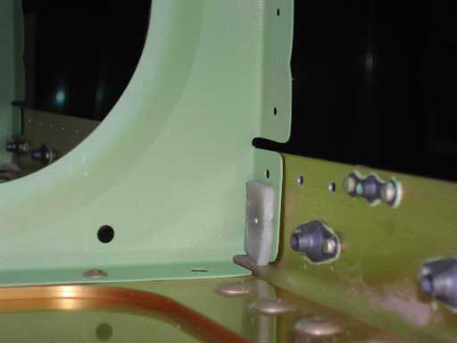

A normal (spring loaded) back rivet set is more user friendly. I have used the 12" offset backrivet set (almost identical to the one pictured, just longer and slightly offset). It is a pig to use and if you have the set at even a slight angle, you will dent the skin - ask how I know. If you must use a set like this, and there are places where it is invaluable, I would suggest slicing a soft pencil eraser block (eg Staedtler or Faber Castel) about 1/32-1/16" thick, putting a 1/8" hole in it and placing this over the rivet before it is set. It will serve the dual purpose of squeezing the flange/skins together and preventing any dents in the metal. Works real well with a squeezer also - see before and after pictures attached. Don't have the eraser too thick, the rivet won't set and you will work harden just the end.
