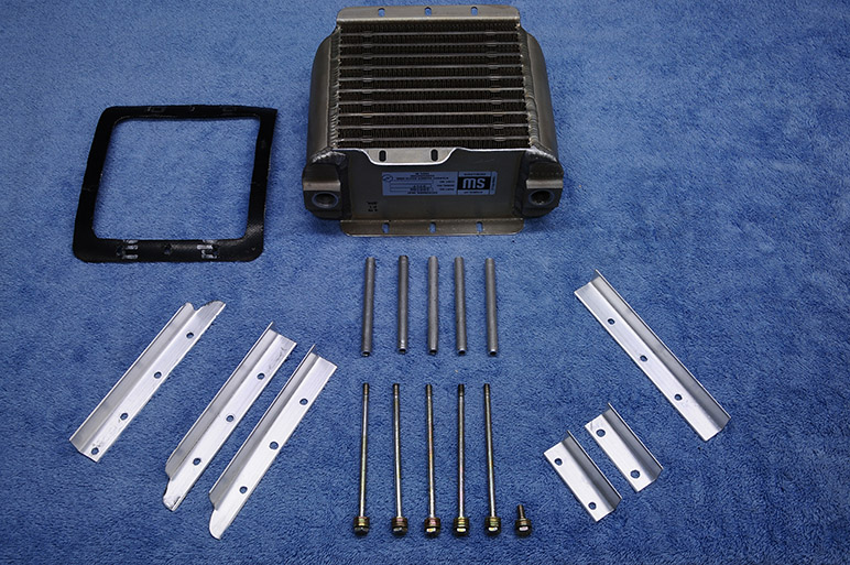

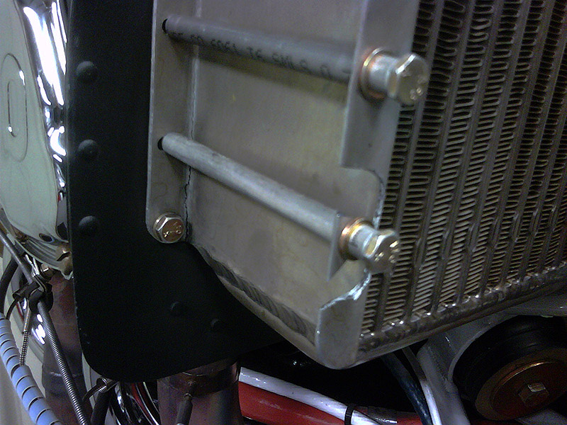

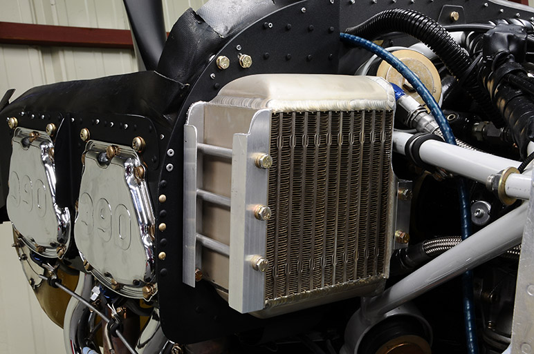

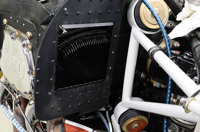

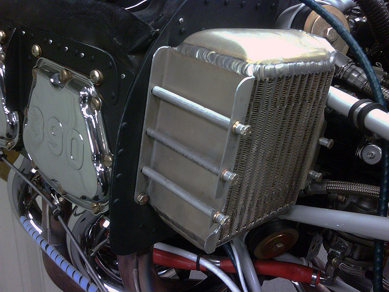

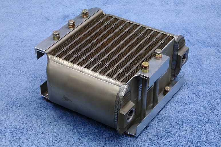

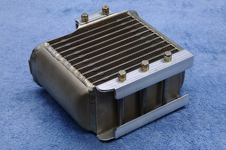

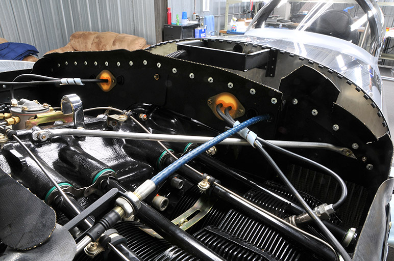

Rather than subject the Oil Cooler's mounts directly to the mounting screw's tension, I decided to craft some angle brackets that much more evenly distribute the load over the original mount. I made a set for the front and back of the rear mount and a single top bracket for the front mount that would sandwich the Oil Cooler mount to the rear baffle. I very carefully trimmed the tube spacers to exactly fit between the front and back brackets; much more precisely than the original installation. The inside rear Oil Cooler mount got the requisite top and bottom notching to clear the engine mount and this time I hogged out a bit more to give even better clearance. (A couple of people noted the scratches on the motor mount near these original notches; I believe these were from when I was filing the original oil cooler, I got a little over zealous and scrapped the power coat; I don't believe that there has been any incounters between the oil cooler and the mount due to engine shake.) I also added a few more rivets on the flanges between the rear and left-rear baffle sheet metal pieces.

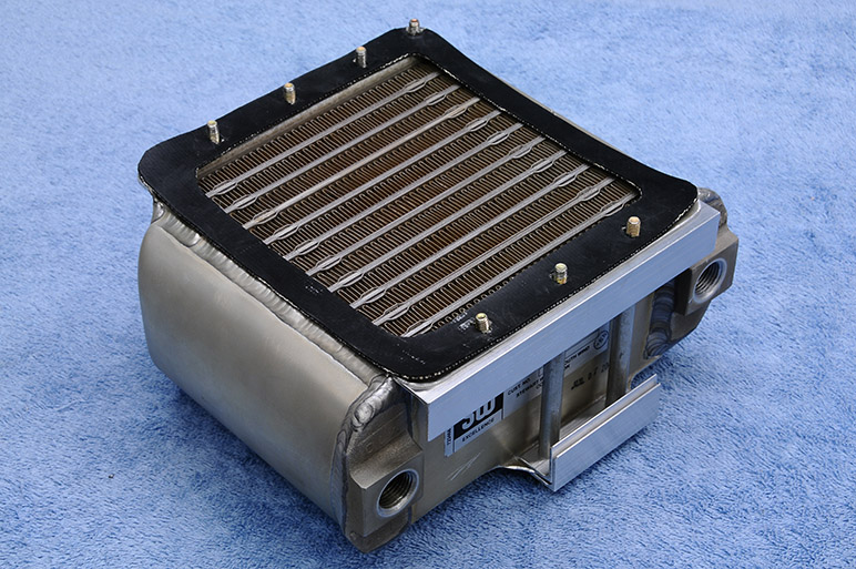

To absorb some of the engine vibration, crafted a "gasket" of sorts from the same rubber material the baffle seals are made of. This really seem to nicely isolate the Oil Cooler from the baffle/engine.

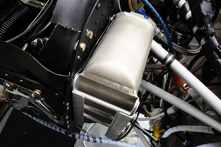

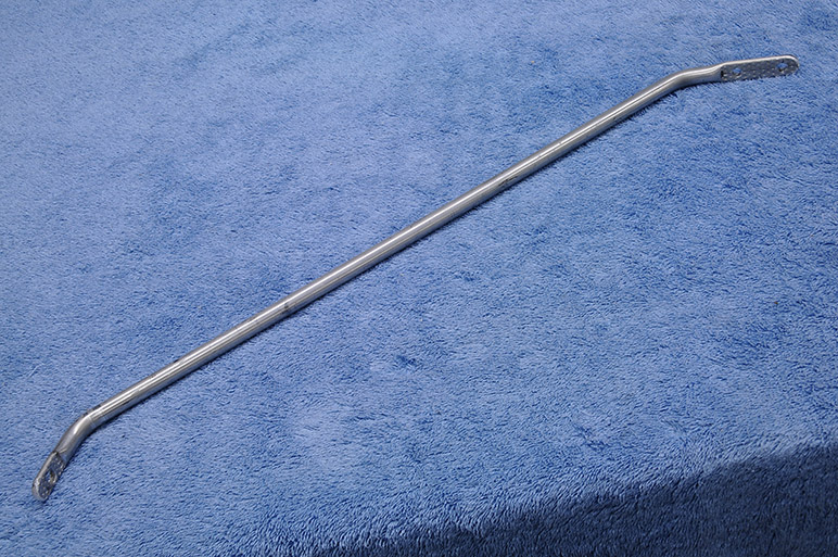

Finally, I crafted a sweet stabilization strut from aluminum tube stock to form a brace from the engine to the top of the rear engine baffle. This made a HUGE difference in the overall stiffness of the oil cooler and I'm hoping will be the final modification in solving this Oil Cooler cracking issue.
