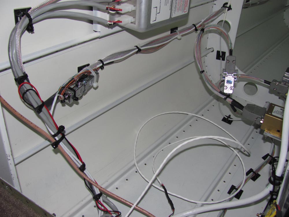

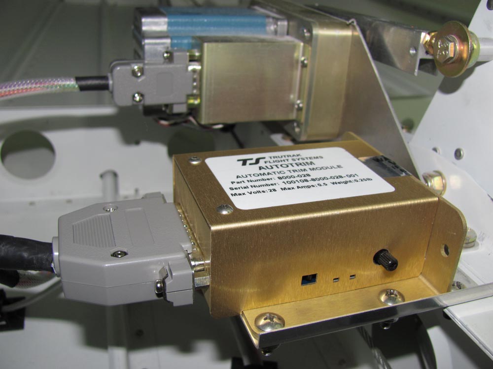

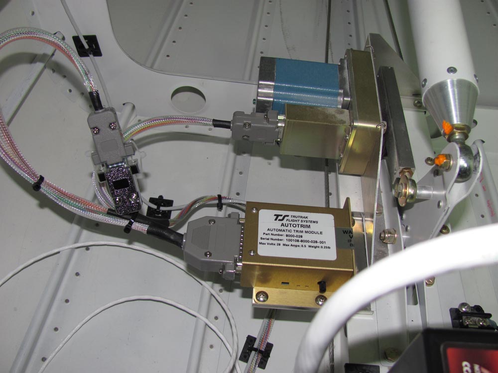

Tim and all interested. The auto trim was very easy to install. It does work
with the TCW safety trim and trims in 3 sec intervals. So far
it has be great and worth every penny as I stated before. It took about 3
hours to install. I have attached some pictures that hopefully
will help. Also all wiring was done right by the Elevator trim servo. I did
wire directly into the trim servo wires going back to the trim servo
in the aft end of tailcone.
Geoff

No I had to make my own wire harness. Pretty easy
Geoff
