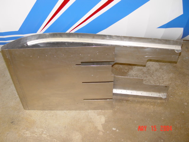

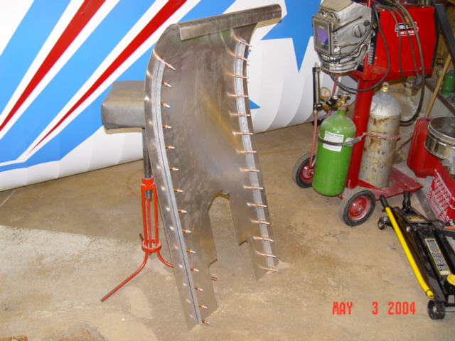

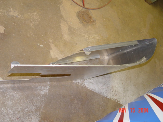

People have put rubber spacers in there, just to keep the vibrating noise down....
Do you have a GAP SEAL that goes between your wings ??? every picture that I've seen of your plane is missing it...( important Item )

PostPosted: Wed Jan 11, 2006 2:33 pm    Post subject: Re: Wing Attach Spacers?... Reply with quote
Mike: That is a darn good looking gap seal. I like it.

WOW!... I answered this, hit the send button and lost the BBS... I'll try again...
Mike, I have the gap seal, I just didn't have it installed in the pictures...
