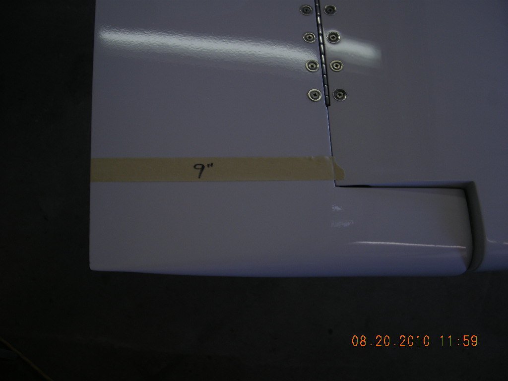

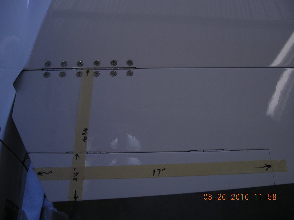

Attached are pictures of my horizontal stab. showing its dimensions. I extended the cord of the elevator, but I forget how much. For me, I have plenty of authority. The trailing edge is about 3/32" thick. The trailing edge of my flaps and ailerons is 3/16" thick.

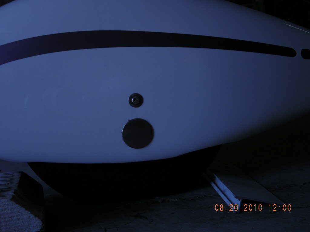

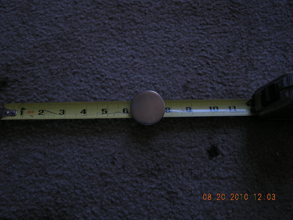

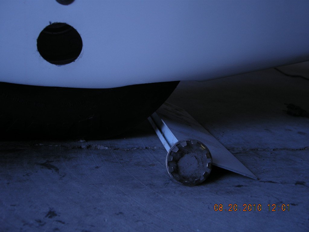

"OC" the pictures of my wheel pant are showing how I plugged my holes with chrome caps from Home Depot.
