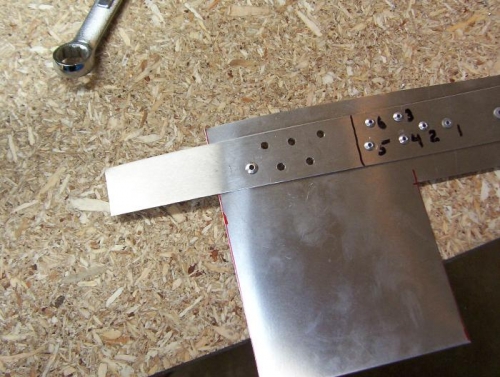

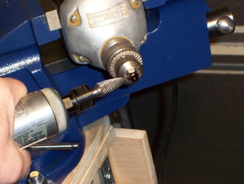

PostPosted: Wed Apr 26, 2006 7:08 pm    Post subject: Re: Enco rivet gun on sale Reply with quote
To modify the noses pieces:
3/8 Drill motor, Bench Vice, Die Grinder, Acorn shaped carbide bit.
Make sure you have centered the nose piece in the chuck by spining it. Put some color on the nose piece before begining the grinding. It lets you see better where the tool bit touches.
Start the drill motor and lock it on, start the die grinder and touch off in the center. Use a light touch and stop to see if it is really centered. If OK continue to shape untill it is about right, then test it. Once the tests prove good, use sandpaper and red scotchbrite to polish out the tool marks.
It really is easy and if you go to deep just grind it flat and start over. Using the carbide burr no heat is required.
River test strip.

3/8 drill motor held in vice. Die grinder with acorn shaped carbide burr.
