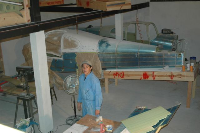

We took one of the boxes, I think from the wing kit, and put legs on it at
different lengths so they support the tail at a normal angle the entire
length. That works really really well to hold the tail and support the
fuse. We have the main gear legs on, without wheels, and have those
strapped onto wooden blocks and sitting on the floor. That makes it really
nice to work on without having it want to roll around on you.
Jesse Saint

PostPosted: Wed Apr 26, 2006 8:44 pm    Post subject: Weight in the front Reply with quote
Here's a pic. It really works well this way and isn't in the way. Also a
great place to put the water picture and cups.
Do not archive.

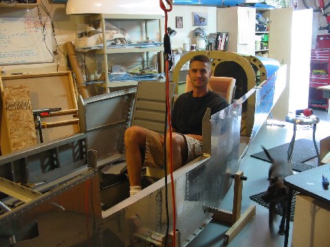

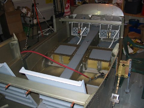

Sean,
Keeping the plane off the gear and lower is a great option after you mount the tailcone. I used temporary gear until it was almost time to mount the engine. In the front I used a piece of plywood bolted to the wing spar to mount a piece of steel with swivel rollers on them. In the back I used a steel pipe through the step holes and supported it with a 2x4 stand. Not very good explanations, but here are pictures of what I'm talking about.
And yes, based on my extensive testing pictured here, the back seats ARE very comfortable.
Jim
