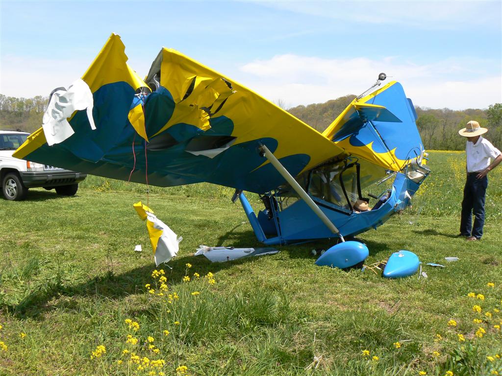

I think if there is zero binding with the measurements as you describe, you have fixed your problem.
Of course, you need to bear in mind where I am coming from. What I am working on putting back together doesn't have anything level in it's cage either...
As Dear Old Dad used to say, "A man on a horse at thirty yards probably won't notice it."

Richard,
Is that your Kolb? That's the one that hit the fence and went nose over correct? I think it's going to need a new tail boom!
I think I will stop worrying about a .5" and go flying.
