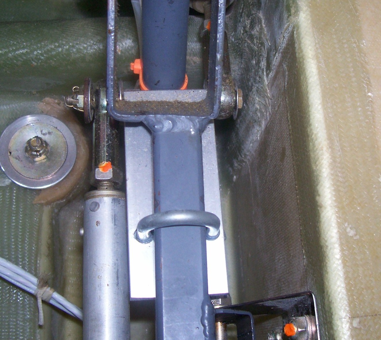

Hello Fellow KIS TR-1 Builders, Here is a follow up on aileron control
stops:
1) I wrote: " Aileron: I installed two flat pieces of aluminum, each one
held in place
with a U bracket on the control stick cross over control rod. The aluminum
pieces butted up against part of the control stick support brackets and
could be adjusted by loosening, moving the aluminum pieces, and retightening
the U brackets."
Attached is a picture of this arrangement.
You can see that my description above is not entirely correct. The aluminum
pieces are U bolted to the square cross section mounting cross bar, not the
cross over control rod, and the stop is actually created by the stick itself
hitting the end of the aluminum piece.
2) Keith Miller wrote: "for the ailerons the sticks come with a bracket for
this specific function
(or at last mine did) , so no need to invent something"
Hello Keith, Can you please elaborate on this a bit, maybe a picture? Maybe
I missed something. Thanks.
'OC' Baker Says: "The best investment we can make is the time and effort to
gather and understand knowledge."
Time: 07:07:57 AM PST US
Subject: Re: Control stop summary?
From: Keith.Miller(at)esa.int
Ted
my simple pitch control stop is illustrated in this picture.
Aluminium "L" Bracket attached to side of the console tunnel and two
fully
repositionable hose clamps on the main elevator control rod . ( i think i
copied this from Ray Clegg)
(See attached file: DSCN0760.JPG)
for the ailerons the sticks come with a bracket for this specific function
