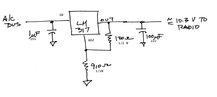

So I think it's a pretty safe bet to design a
noise free (linear) step-down regulator set
for say 10.5 volts using an LM317 regulator
from radio shack.

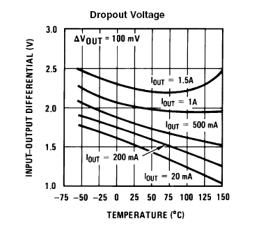

The data sheet for the LM317 . . .
http://cache.national.com/ds/LM/LM117.pdf
. . . says that with
a 200 mA load at 50C case temperature on the
device, the dropout voltage (differential
between input and output where it looses
regulation) is on the order of 1.6 volts.
[img]cid:.0[/img]
This means that a 10.5V regulator crafted
with this part would maintain regulation
performance with an input supply as low
as 10.5 + 1.6 = 12.1 volts which certainly
covers all operations with the alternator
working . . . and if the alternator is not
working, one can reasonably expect the
radio to work fine on internal batteries
for the time it takes to comfortably put
wheels on the ground.
I'm 99% sure that crafting the circuit
below will produce a power source that
will operate the radio. It may not charge
the battery . . . so use the radios normal
charger(s) to top of batteries before flight.
[img]cid:.1[/img]

Excellent observation Dave. An alternative solution
was proposed wherein a series of diodes were
placed in series with the supply line. Each
diode contributes its own forward conduction
drop on the order of .6 volts per diode. This
approach simply tosses off a relatively fixed
amount of voltage.
The problem with both of these configurations
is that the output voltage to the radio is
not very stable for all conditions. This
is why most designers will include some sort
of active regulation in their external power
adapters.
The switchmode device that started this
thread is the most efficient and can be quite
small for it's capabilities. But these
necessarily include POWER oscillators which
can and do behave like little transmitters.
The minimum-risk approach for the electronic
handy-man is some form of linear regulator . . .
which demands consideration for "head-room"
or "drop-out" voltage. This is a characteristic
of all step-down regulators that defines
how well it performs as the input voltage
falls toward the same value as the output
voltage.
The diagram I posted yesterday promises
good output regulation with an input as
low as 1.6 volts above output. There
are specialty regulators that offer lower
dropout voltage but as long as we're not
attempting to charge batteries or get
rated performance with a dead alternator,
then the diagram posted offers good value.
