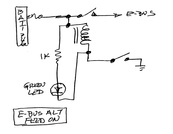

I would like to include an Off/On indicator light (LED) for the E-Bus alternate feed when using a relay as in Z-32 for a heavy duty E-Bus Alternate Feed. I understand that the LED will have to include a series resistor in any case.
My questions are regarding both the plus 14V. source for the light and the pull to ground for the light. Can the plus 14V. come from the power to the relay or must it be a separate source? Can the ground side of the LED be tied to the ground side of the relay coil going to the switch or must it be separate? Can these be mixed and matched in any way.
I have illustrated the 4 combinations using Z-32 as a basis. Please see the attached drawings.

Suggest you wire the LED in parallel with the
relay coil. If the light is lit, at least there
is power to the coil terminals and it's because
the switch is closed. Further, if you put the
LED current limiting resistor at the relay, then
potential fault current in the LED "hot" wire is
inherently limited by the resistor and no fuse
or other protection is called for.

Therefore I assume it is OK to tie the ground sides from the LED and the relay coil together through a single pole switch.
PostPosted: Wed Jul 28, 2010 7:00 am    Post subject: E-Bus Off/On Indicator Light Reply with quote
At 09:43 AM 7/28/2010, you wrote:
<gordonrsmith921(at)yahoo.com>
Sure . . . as long as multiple loads (coil and LED)
that share ground through switch also share the same
source of power.

What's the design goal for this light?

The design goal for this light:
This light is to be an indicator that the E-bus alternate feed switch is in the on position even though in most cases there would be other indications.
My thought go to shutting down and exiting the aircraft. Although I would never do this some pilots have been known to leave the master on. The LV warning light would be an indication that the master is on.
The exiting check list would be "All Lights Off!"
I am also considering the use of a Brownout Battery employed as in Z10-8. I envision turning the E-bus alternate switch on to load flight plans, communicate, etc. before turning on the master and starting the engine. The E-bus alternate feed would be left on during cranking to start in order for the anti-brownout feature to function. The light would be a reminder to turn off the E-bus alternate feed switch after start. Although, I guess it would not be a great sin if it were left on continuously during aircraft operation.

Okay, the idea is to annunciate a closed
switch that controls a relay. The best
way to do that is put the lamp across the
coil of that relay.
