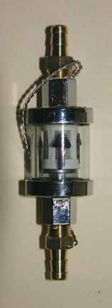

Rick's point... "Mount it on the pressure side and you get a stream of gasoline spraying about your airplane." is well taken. I had the same fear myself...
So I safety wired the sucker...
IMHO a fuel filter is most effective when it stands between the carbs and all sources of contamination, including fuel pumps.
I fly the same fuel filter set up I have used for decades, with great success, on my motorcycle... My bike is rather old and the engine is hard mounted (no rubber mounts) to the frame... So if the filter is going to vibrate apart, I'm sure it would have done so by now.
Just my experience... Your mileage WILL vary.
