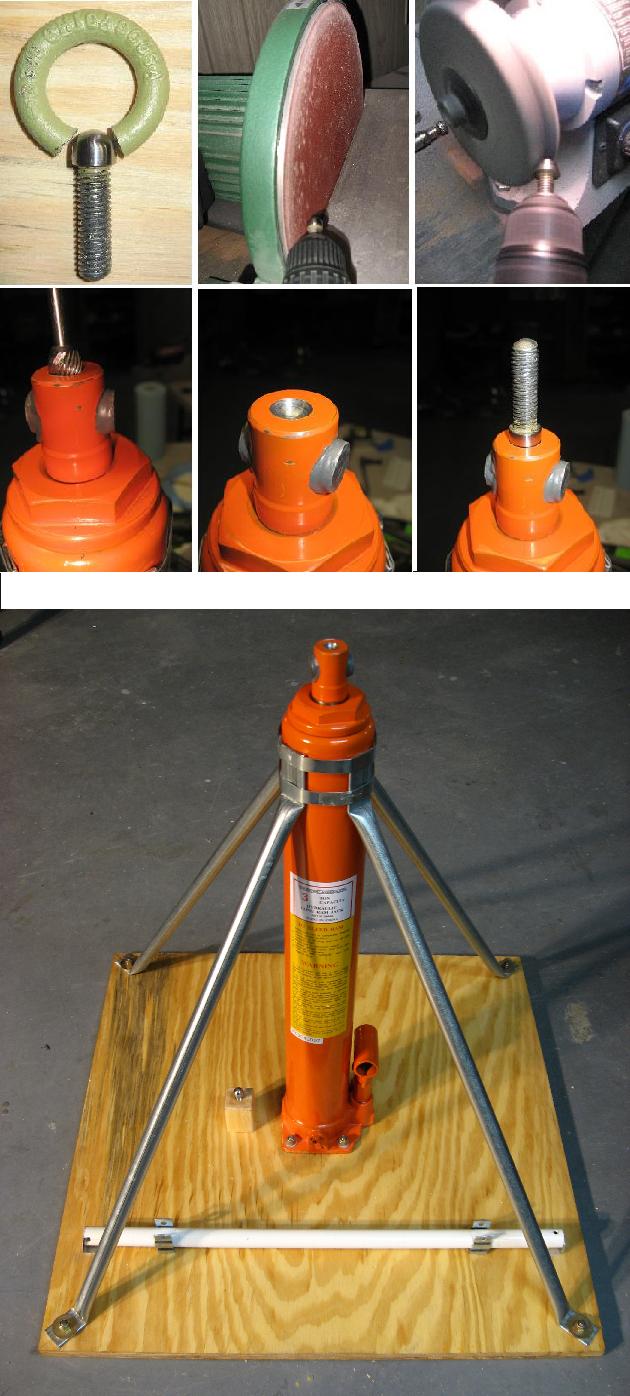

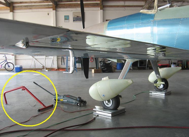

Hey Matt,
I use two entirely different methods to jack up my RV-8 and both systems work very well. The first method uses a commonly available bottle jack from Harbor Freight. Many builders before me have made their own version of a wing jack based upon the HF bottle jack and my interpretation is no exception. Investing just a few hours work using off the shelf parts, the Harbor Freight bottle jack be quickly transformed into a very useful wing jack.
http://tinyurl.com/7eb5ed
The second method I use is the "Handy Jack."  Using leverage, it too is a quick and very easy way to lift an RV8 wheel clear of the floor.
http://www.rvtraining.com/html/atp//html/products_pics.html#RVJACK
Rick Galati
RV6A N307R
RV-8 N308R
 Filesize:  122.7 KB
 Viewed:  10741 Time(s)
 Filesize:  68.25 KB

PostPosted: Thu Jul 01, 2010 4:23 am    Post subject: Jacking Point Reply with quote
Rick,
Did you make any kind of stabilizing frame for the bottle jack or use them
as purchased? Would be interested in pictures or description if you made
stabilizer.
I too have a set of the HF bottle jacks. A "pocket" was created on the top
of the shaft to fit the plastic screw in buttons in the tie down fixtures
( from Van's) Did this with a large counter sink tool. This makes a secure
point at the wing. But, I am always a little concerned about the jack
tipping while jacking or if I bump the airplane while on the jacks - even
with the other wheel chocked.

Rick Galati
Posts: 91
Location: Lake St. Louis MO.
PostPosted: Thu Jul 01, 2010 4:45 am    Post subject: Re: Jacking Point Reply with quote
Dale Ensing wrote:
Rick,
stabilizer.
Dale,
I made up the jack in about 4 hours using a 2'X2'X3/4" precut piece of plywood as its base, two 3-1/2" band clamps and one 10' stick of 1/2" electrical conduit all purchased from Home Depot. In practice I find the jack to be very stable. Perhaps it helps that the ball joint I fashioned from a spare tie-down ring is allowed a small degree of movement within its socket on the jack itself and that allows the ball to find its own center under load while lifting the wing.
Rick
