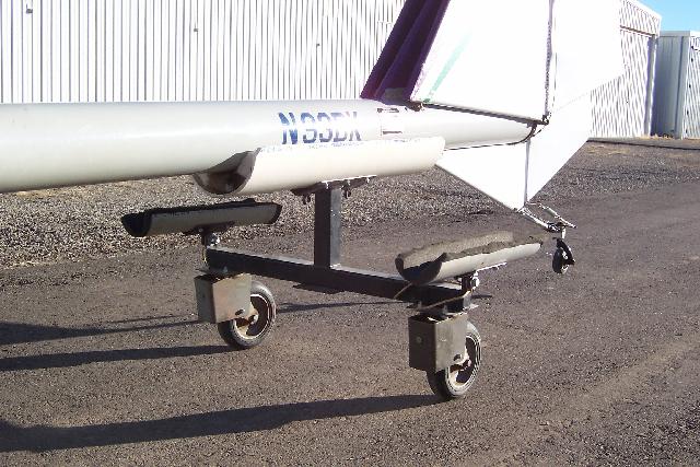

I have an open, flatbed trailer that I use to transport my Mark-3 occasionally.
For ground handling and for transporting, I built a tail support dolly, which also contains padded saddles for the wings when they are folded. The wheel assemblies (2) on the dolly have some shock absorption in the form of springs, and this is plenty for the usual in-and-out of the hangar.
But for trips on the trailer, I place an old car tire, with partially-inflated inner tube, under the dolly. This provides superb shock dampening for the airplane. I designed the dolly specifically to be able to straddle a car tire for this purpose.
Check out George Alexander’s excellent website, where he has a folder with a collection of various Kolb trailering ideas. Good luck with your boom tube repair!
Dennis Kirby

I found the pictures of your rig on his site, I like the tire idea. But I still don't understand how you keep the wings in their saddles going down the road.
Chris
