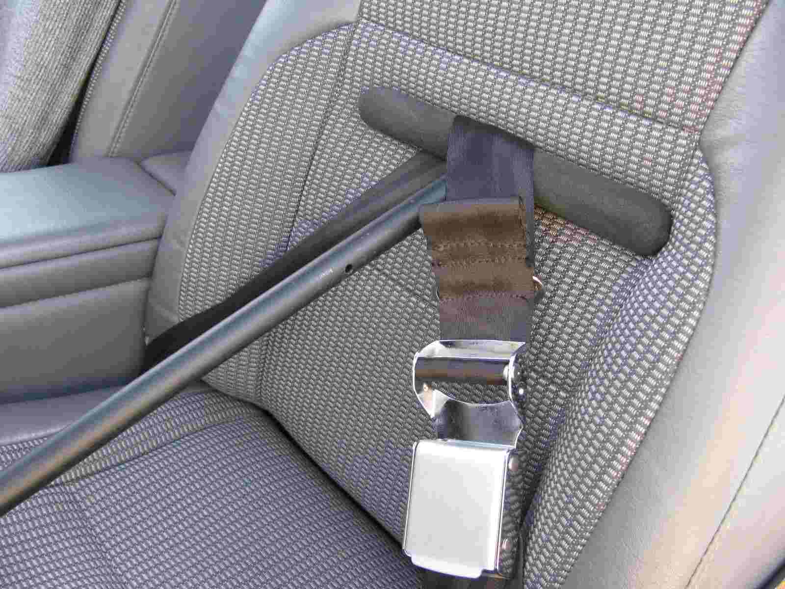

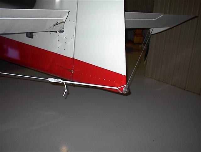

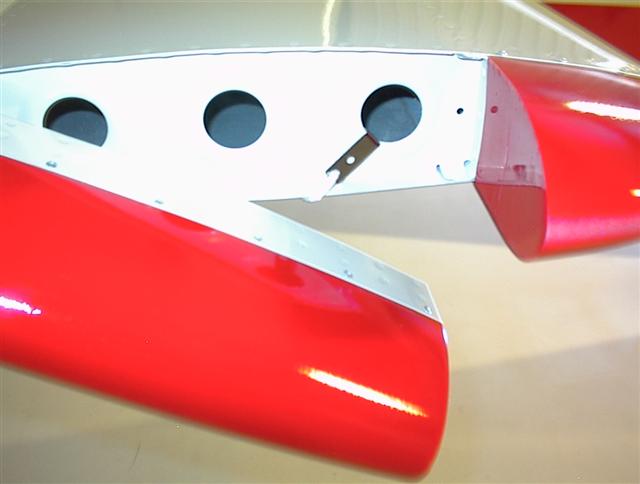

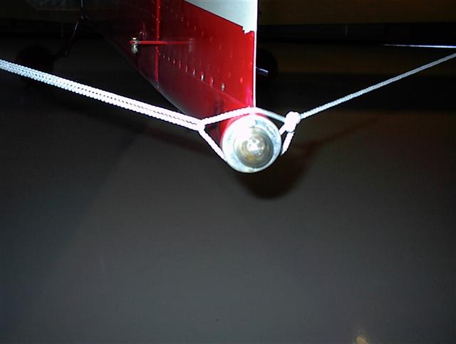

If you like simple and cheap but effective this might work. After strapping
back the stick I install this restraint. I used it on my 9A also. On the 9A
I started out with the clip installed that others have pics of (holding the
rudder pulled completely to the side) but liked this better.
Albert Gardner
N991RV
Yuma, AZ

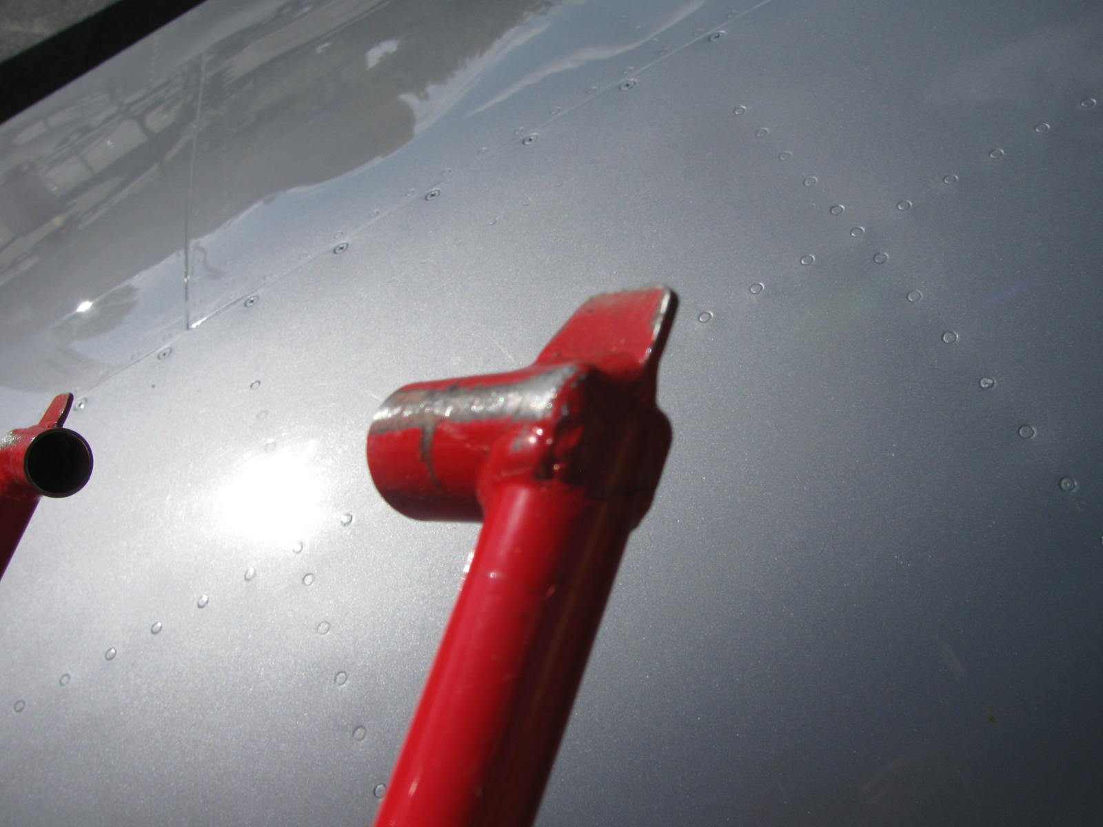

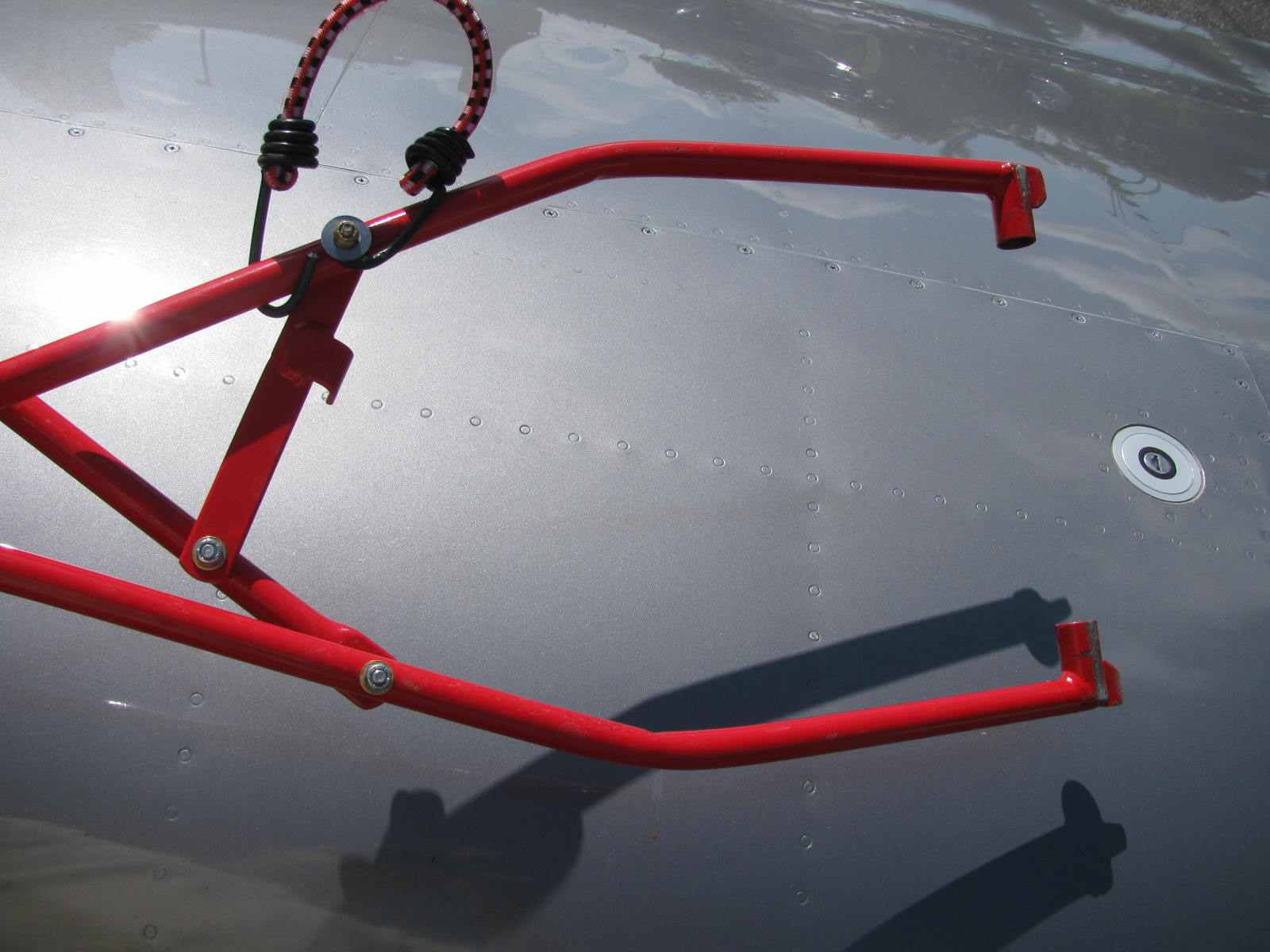

Here's our latest iteration.  Best one we've used yet, simple, cheap.
Dave Saylor
AirCrafters

PostPosted: Thu Jun 10, 2010 1:47 pm    Post subject: Re: Misc topics... First flight, Insurance, Rudder lock Reply with quote
Thanks for the input.
Dave, is the only modification to the tow bar welding a tip that fits between the brake pedal and the rudder bar?
Doug
