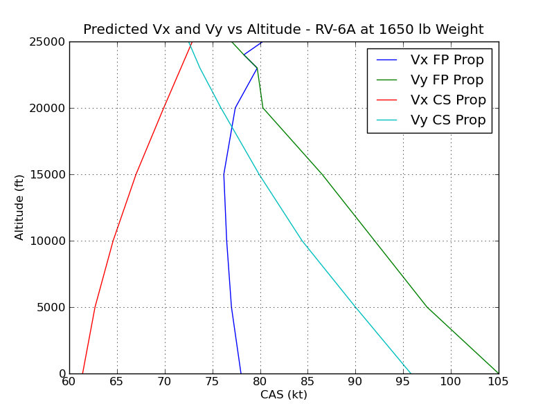

khorton01(at)rogers.com
PostPosted: Fri Jun 04, 2010 4:39 pm    Post subject: some approx V speeds Reply with quote
I was messing around a few months ago, making some charts to illustrate a magazine article on climb performance that I intend to finish someday. I used the combination of CAFE Foundation drag vs speed data for the RV-6A, Lycoming O-360 power charts and some Hartzell prop efficiency maps. I used that data to predict climb performance at various altitudes and speeds. I didn't have any fixed pitch prop efficiency data, so I used the Hartzell data, but forced it to use the same pitch for all conditions. The pitch was selected to give 2700 rpm at full throttle at 8000 ft.
The attached chart shows how Vx and Vy are predicted to vary with altitude for both fixed pitch and constant speed props. You will note that Vx and Vy are quite a bit faster with fixed pitch props, as the rpm and power increase as the airspeed is increased. You will also note that there is a significant variation of Vx and Vy with altitude.
I caution that this is a very crude prediction. It may not match the actual performance at all, so use at your own risk. It is interesting to note that the predicted fixed pitch Vy at sea level (105 kt, or 121 mph) is close to what Ed found. That may be blind luck.
Kevin Horton
Ottawa, Canada
