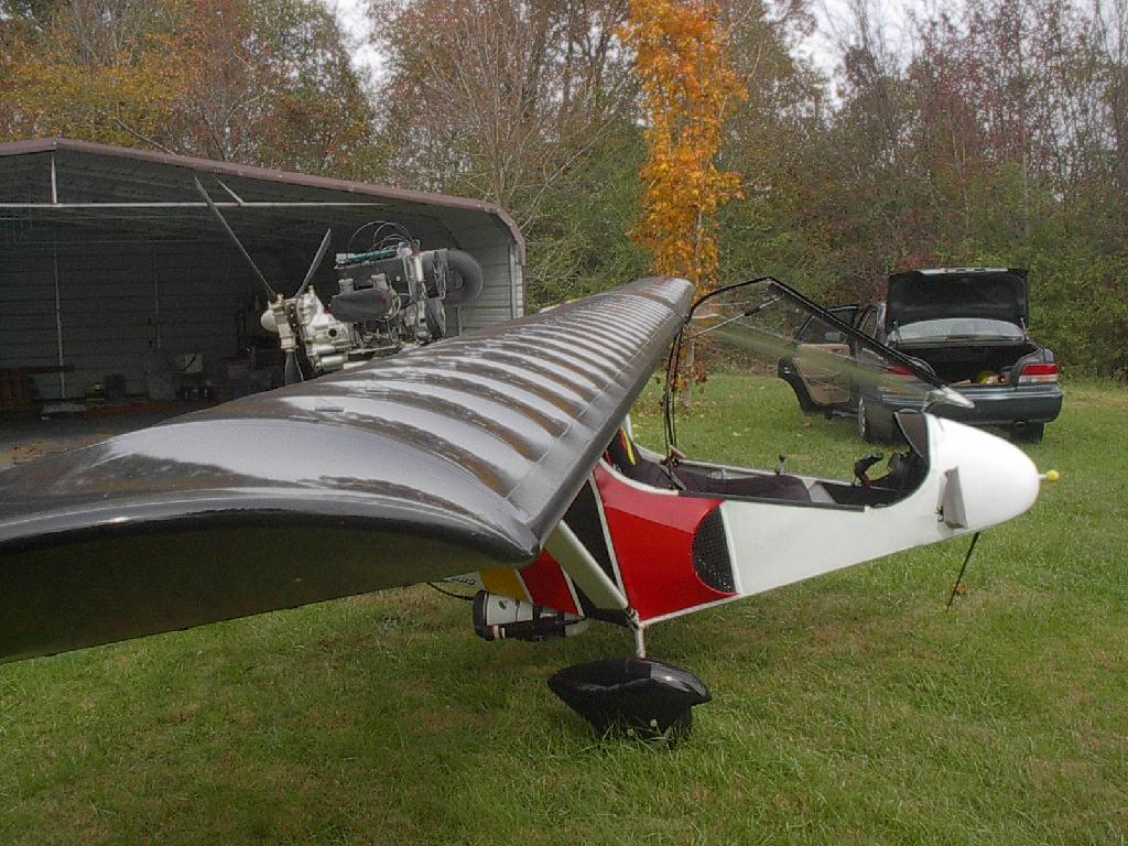

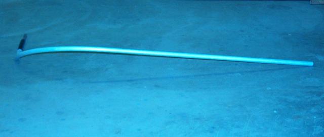

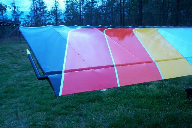

PostPosted: Fri Apr 21, 2006 12:50 pm    Post subject: Re: Shorting the bow tips Reply with quote
mustangsally(at)semo.net wrote:
Has anyone shortened the bow tips on the wings of Firestar? Seems to be a lot of drag out there. Doing some measuring, 6" could be done pretty easy. That would be 12" less of nonlift producing drag gone.
Jerry

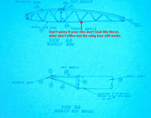

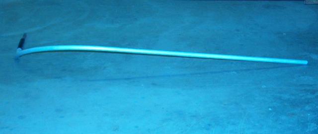

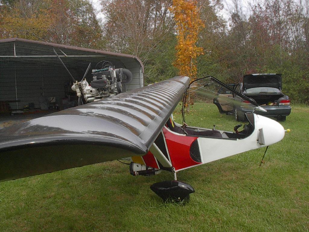

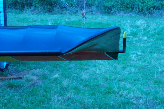

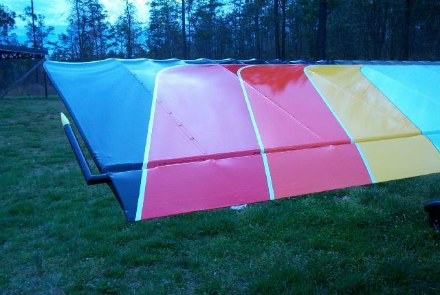

I did - to 26'9" - I'll send some pictures. I think it works fine. I have standard Kolb Ribs (built on a wooden jig - the old fashion way) - different wing bow ...a few other things different but not with the wings though - execpt VGs.

Thom Riddle
Posts: 1597
PostPosted: Sat Apr 22, 2006 3:50 am    Post subject: Shorting the bow tips Reply with quote
If that Hoerner Style wing tip does to a Kolb what they do for a
Cherokee, the results must be wonderful. Of course the original shape
of the Hershey bar wing tip on the Cherokee is not as good as the
original Kolb wing tip.
Thom in Buffalo
