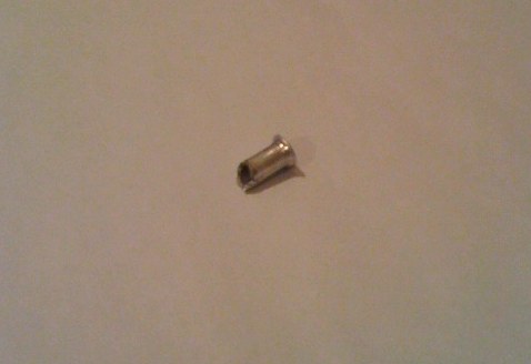

What went wrong? The short version: a fuel line broke.
The long version: During final assembly it came to my attention that people with the Fuel Flow transducer in the “Tunnel” where experiencing FF fluctuation when using the electric pump. The fix? Move the FF Transducer to between the Fuel Injection Servo and the Spider. Well, that’s what I did. When I relocated the Transducer I had to fabricate a line between the Servo and the Transducer. The line I fabricated was Ľ inch aluminum, that was the flaw. That line broke just outside the fitting. When I made that line I made sure it wasn’t under any stress, in a natural position, etc. Apparently that was not enough. Now, I will say this. This was the one component of the airplane I was never quite happy with. It just “didn’t look right”. I had some other builders take a look, half heartedly hoping they would tell me that aluminum was bad and I should change it, but no one did. So it stayed, and worked fine for 58 hours.
I blame no one but myself for what happened. A part of me knew that that line wasn’t right, yet I talked myself into believing it was fine. Don’t ever short change your gut… most of the time its got good instincts!
She’s now grounded, awaiting Stainless Tubing so I can make the fuel like the way I originally envisioned. Parts should be here next week, and the adventure will continue.
The long version: During final assembly it came to my attention that people with the Fuel Flow transducer in the “Tunnel” where experiencing FF fluctuation when using the electric pump. The fix? Move the FF Transducer to between the Fuel Injection Servo and the Spider. Well, that’s what I did. When I relocated the Transducer I had to fabricate a line between the Servo and the Transducer. The line I fabricated was ¼ inch aluminum, that was the flaw. That line broke just outside the fitting. When I made that line I made sure it wasn’t under any stress, in a natural position, etc. Apparently that was not enough. Now, I will say this. This was the one component of the airplane I was never quite happy with. It just “didn’t look right”. I had some other builders take a look, half heartedly hoping they would tell me that aluminum was bad and I should change it, but no one did. So it stayed, and worked fine for 58 hours.
<image001.jpg>

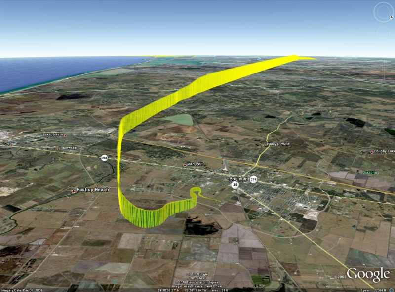

In case anyone wants to know how fast this happens. Total time from Me turning on the Fuel Pump to wheels on the ground: 2 Minutes 46 seconds.
<image002.jpg>

Kind of cool to see the flightaware trip.
http://flightaware.com/live/flight/N569JC

I started my decent out of 4, down to 3000 going direct the IAF… At 3400 ft, that’s when the adrenalin started pumping. Now I’ll be honest, I don’t’ know if I heard the prop fluctuate or not, but something got my attention. I did a quick engine check and saw that EGT’s where high… very very high. I knew immediately I had a problem, but I had no idea just how bad the problem was. Training kicked in and Mixture to rich, boost pump on, tank switch. The EGT’s came down, but they didn’t stop coming down. When I saw them drop below 200 or so, and I was getting no reaction what-so-ever from the throttle… Well, Houston We Have A Problem.
I declared the Emergency… If you ever want to hear a frequency go totally quiet, just use those words. Informed Approach of a total power failure and requested vectors to the nearest airport. Houston Approach was for the most part absolutely wonderful. Without missing a beat they informed me that Brazoria was 7’Oclock and 5 miles. I IMMEDIATELY started the turn and realized that with my now wonderful tailwind turned headwind, there was no way I was going to make it.
Let me back up just a bit… All this is happing IMC. I entered the overcast layer at about 3800 FT, bases are reported anywhere between 1000-1500 depending on which ASOS you listen to.
Continuing on…. Not going to make Brazoria, I know I have to do something. Glancing at my EFIS Map I see that ľ a mile away is a private strip that Center probably didn’t even know existed. I turn directly at that airport (7R9), informed Approach where I was going, then I waited, and waited, and waited…. Not much else I could think to do at the time. Still IMC. Engine Out. I didn’t really think I’d be in this situation, ever.
Ľ mile from the airport, at 1300 ft I break out. Guys & Gals, I haven’t been so happy to see a perfectly mowed grass strip in my life! A quick turn away to burn Airspeed and Altitude, slip to final, and down we come. The landing went perfect, it was downwind. I didn’t care, the airplane didn’t care. The prop finally quit windmilling in the flair, telling me that it really was dead, as if I didn’t know.
I managed to get us (me and the plane) on the ground, unhurt, out of that situation. Is it all skill, well I’d like to think so… but I know better! I got lucky, very lucky.

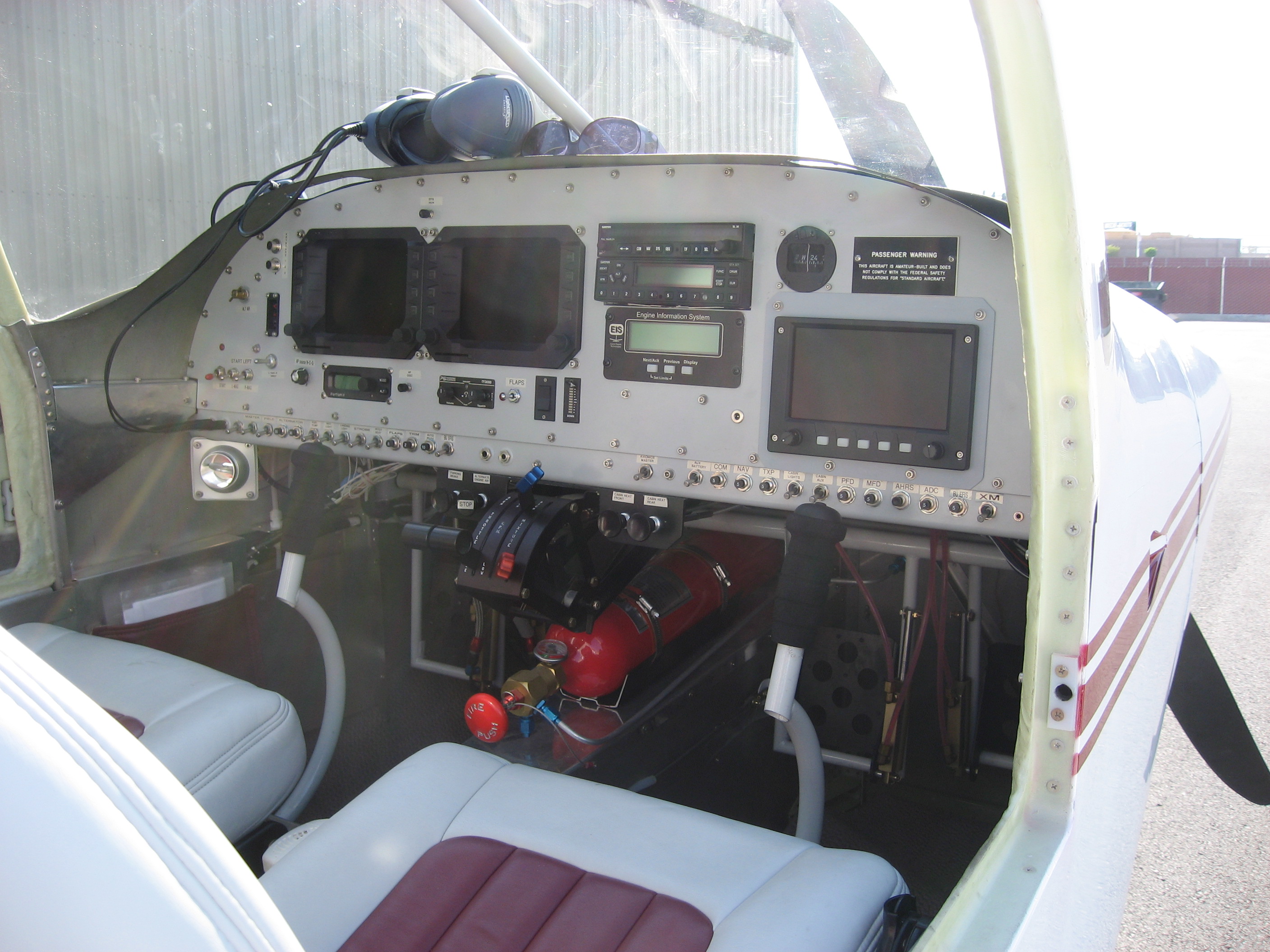

All the more reason for a fire bottle; note the fire handle in the picture.
System is plumbed to two sprayers; one over the engine and one aft of the
rear cylinder baffles
