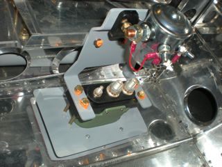

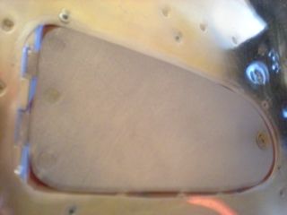

I mounted an AN2552-3A power receptacle ($69 from Spruce) on the belly on the starboard side of the battery. Door on bottom. Sorry for the out of focus photo of the door, someday I'll take a better one.
