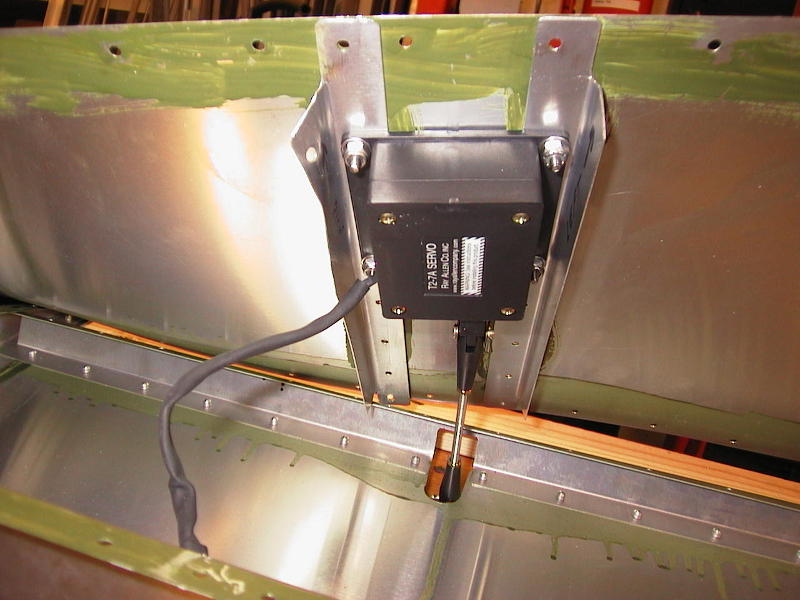

PostPosted: Tue Feb 16, 2010 10:14 pm    Post subject: Re: aileron trim servo angles Reply with quote
I let the ends of the L angle go under the skin and trim tab piano hinge on both ends of the L angle. Since the skin was only 0.016" , I wanted some extra stiffness at the end of the L angle. It ended up looking like this. The angle is bent out a little so the edge won't catch on the servo wire when it is fit together.
 Filesize:  68.39 KB
 Viewed:  5531 Time(s)
