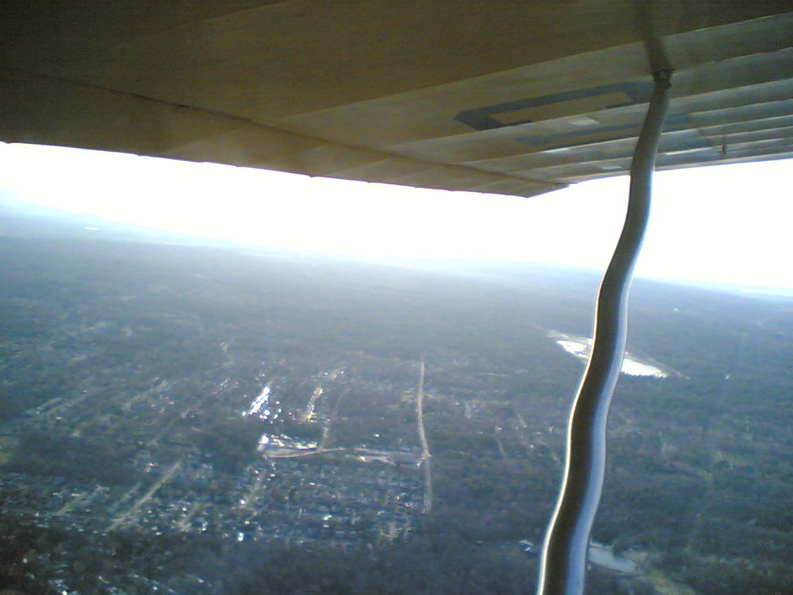

I have often noticed some vibration of the wing struts of my Twinstar MK II .
This happens at a given RPM when the strut seems to hit a "resonance" point and start to vibrate. This never bothered me too much as it seems to only happens at a RPM of around 4500 .
Now ... i took some picture with my camera phone while flying yesterday
that happens to "catch " these vibrations on the picture.
I have been quite surprised when i saw that picture with the apparently quite large amplitude of the vibration ! Quite amazing ... but it could also be
an optical "effect" created or amplified by the relatively low shutter speed of the camera ...
In any case i am now thinking of installing wing strut fairings to try tio fix the "problem" .

My '04 and 503 powered Firestar II does the same thing depending on how the
503 feels like eating it's oats. I have the strut fairings too...same deal. I
let the sumbitch vibrate. If the strut fails, I got the 'chute.

Look's as though the strut is distorted from your lexan being photographed
through, you do have a canopy on right. Look at the landscape you will see
your straight lines are distorted also. Just my guess though.
