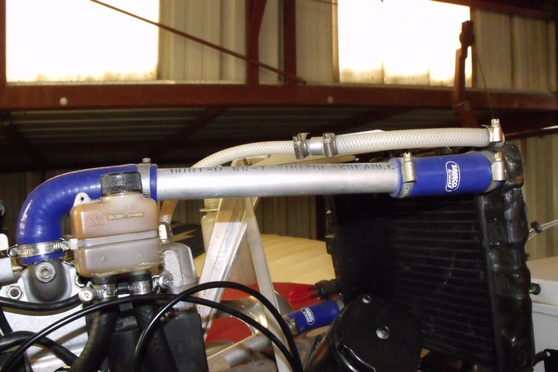

Hi all,
While we're on the subject of coolant hoses....
Does anyone know of a source for the aluminum pipes specified by Rotax for extending/splicing coolant hoses? This is in the installation manual in section 12.6 "Requirements on the cooling system" - they mention aluminum pipes with bulges on the end.
I'm utterly unable to locate anything like this or even an equivalent and I'm getting tired of the blank faces staring back at me when I ask about these locally or anywhere for that matter.
Where on earth can one locate pipes suitable for use for splicing coolant hoses? I'm starting to get desperate because this really needs to be done on my plane ASAP and I need these to make proper fitting hoses...
Even equivalents without the bulges would be fine - anything, I don't care. I just need something that meets the temp/pressure/corrosion requirements for coolant...
LS

Lucien, Send me the specs for what you need and I'll see if I can round up the material and make them. Here's a photo of mine on my 582.

What we do: Buy the appropriate piece of Al tubing from Aircraft Spruce then take it to the radiator shop and have the bead it on both ends. If the radiator shop does not have a beader call around to various auto & machine shops.

ah hah!... thanks gentlemen.... I think I've finally made the mental leap here...
What is the appropriate grade tubing to use? Rick, in your picture I see what I think is 6061-0 printed on one of your tubes?
Let me see how long of a length I need for the top tube, Ill try to measure what I need this week.
I'll look for a radiator shop, but it's doubtful (Santa Fe is kind of like living on Mars as far as things like this go). Maybe down in Albuquerque....

A muffler shop might even have that kind of expander ( worth a call!) Way up here in the bush I have seen people (me) weld/tack a little piece of strapping on the pipe then push the hose over and put the clamp on the other side of it, works the same with the same results

I've thought about just flaring the ends myself if I could find an appropriate tool. Smoothing it off and then pushing the hose over that.
What thickness of tubing you guys think would be sufficient? I guess 6061 on the grade is probably good enough, just wondering about the thickness?
If I come up snake eyes, Rick, I'll just have you make a pair of em for me Wink

Another thought.. Take a piece to the 6061 to the muffler shop and have them expand a little ring heat it up at home and shrink it onto the pipe!

I checked the spruce tables for 3003-O. They say 1" X .035 wall has a pressure rating of 305 psi with a safety factor of 2. I think the Rotax coolant system at 17 psi isn't going to phase the tubing at all. I used 1" X .065 6061-O because that was what was available at the Yard Store. I do the beading with a Parker tube beader.

Lucien a good FBO should have an expander... only takes a few seconds to put
a bulb in a tube.

Do you really want to trust aluminium that has been heated... unless you are a specialist welder. Even comparatively low heating can ruin the crystalline structure of the metal.

Lucien, This is Spruce's table for 3003-O tubing. The least of the tubing used for lines. For formability, I'd go with 5052-O, it's not heat treated and you can get it both in .035 and .049. I'd be perfectly happy with the .035. If you aren't worried about weight, go with copper tubing and polish it up. When I ran air lines in my shop I checked the spec on the thinest wall copper in 3/4" and it was rated to over 1000 psi.
Rick

5052-0 .049 is what I went ahead and ordered with the beader, so that's what I'll be using. I thought about copper but I've also heard about possible corrosion problems with it. And I'm probably not going to need lengths that long to justify it, so just went with Al.
Hope to get it before the weekend so I can get the job done....

What is wrong with using automotive hoses on the Rotax? Many of the late model vehicles have very creative hose assemblies and if you visit the warehouse section of your local auto supplier you can quite often find a very nicely shaped hose with just the right preformed bends that eliminates many of the connected elbows necessary when using straight hoses. It seems to me that one fairly continuous formed hose if safer than connected bits. After all, how many of us change out our auto hoses every few years and how many actually fail. I believe the pressures would be quite similar to modern vehicles. Comments?
Well that's the problem. I've not been able to find any pre-formed coolant hose that'll fit my particular installation. My blood pressure now just starts going into the yellow zone when I try to find these, so I've just accepted that I'm going to have to manufacture my own.
JD (the original builder) got lucky on the radiator-to-water-pump hose originally but the top hose is fabricated with a bypass valve for a cabin heat system. I can locate 90 degree and one 135 degree bend (needed on the top hose) tho but nothing that'll fit alone.
Rotax actually recommends using pipes in the installation manual for longer runs instead of long hoses so I don't feel bad about splicing them.
As for the type of hose, Rotax dealers have told me to just use a good quality automotive radiator hose, there's no Unobtainium material requirement here fortunately, just regular automotive stuff suffices.
I prefer Gates and fortunately that's available locally (gates is what's on the plane right now and it's still in good shape except for the one tube that's a little chewed up on one end). The specs on the hose are in the installation manual too.
Looking forward to finally getting this done when I get the tools. That one hose has been a splinter in my mind for a while and it'll be good to finally extract it Wink
