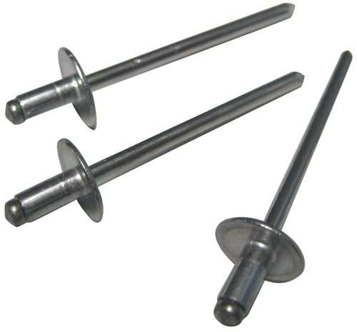

While on the topic of rivets. What type of rivet is used to hold fabric on the wing ribs etc? Is there a AN number?

Ray, attached is a picture of Poly Fibers fabric rivet. Spruce has them, but you might be able to find the same thing at a better price at McMaster Carr or other industrial supplier.

PostPosted: Mon Jan 18, 2010 7:29 pm    Post subject: Rivets used in lexan installation Reply with quote
I feel much better using Poly Fiber Fabric Rivets on my airplane.
