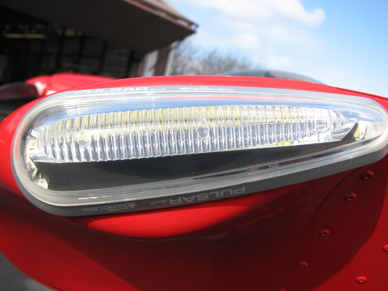

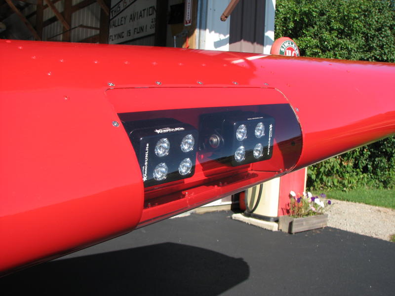

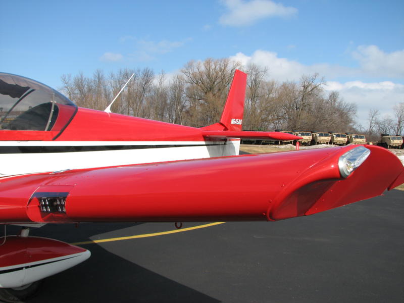

PostPosted: Tue Jan 12, 2010 6:59 am    Post subject: LED Landing lights Reply with quote
Hi Chris,
I have an HDS with a Jabiru 3300 that has been flying for five years. I made my own holder for my Landing/Taxi lights, but I think it is about the same as the "Standard Zenith light holder". I installed standard aircraft Landing/Taxi lights (I think they were 4509's). I also had Aero flash Nav/Strobes (Double flash) with a tail light in the rudder. When flying at night I had to manage the use of the lights so I woud not run the battery down. If I was doing touch & goes and then shut the engine down there might not have been enough power to restart.
I changed to AEROLED's Landing/Taxi lights a couple of years ago. I had the old lights setup like this (One for landing angled down and the other for taxi set level and angled to the right slightly). I would use one light at a time. I set the Led's at the same angles but use both at the same time. They also have a WigWag feature built in. I use the Landing light switch to power both lights for landing and the Taxi light switch for WigWag. They don't draw hardly any current and they are brighter.
I also installed The AEROLED's Nav/Strobe/Tail light combo when they became available. Even though I now had tail lights in the wings I also installed aan LED tail light in the rudder. Now I do not have to manage my power consumption like "The old days".
See attached Pictures.
AL from Oshkosh
