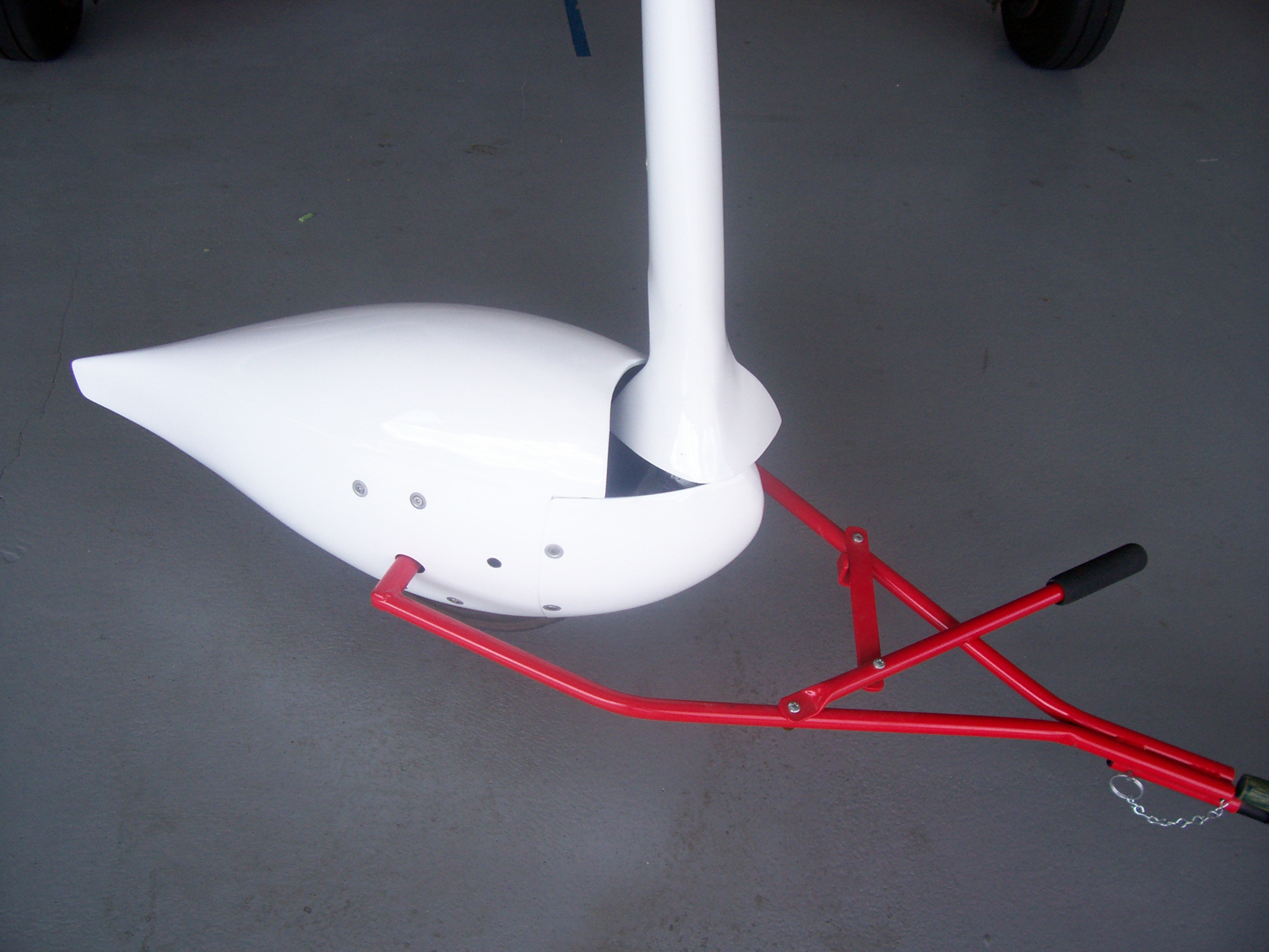

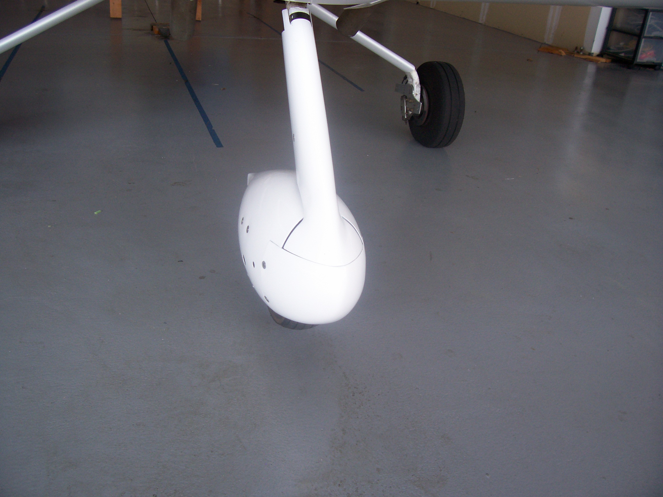

Hello Fellow Builders, Attached are pictures of my version of a nose wheel
strut fairing and nose wheel pant for my KIS TR-1.
This arrangement was created from a Glastar nose landing gear strut fairing
and a Van's nose landing gear wheel pant.

PostPosted: Mon Jan 11, 2010 11:04 am    Post subject: Nose Wheel Fairing Reply with quote
Hello 'OC',
They look very nice!
Have you had a fellow pilot take a picture or look to see that the wheel
pant is exactly in trail when in flight? I understand some are offset by the
prop blast. If yours is, it might be creating drag from air going into the
pant past the strut fairing?
Tim
bakerocb
Joined: 15 Jan 2006
Posts: 727
Location: FAIRFAX VA
PostPosted: Mon Jan 11, 2010 11:40 am    Post subject: Nose Wheel Fairing Reply with quote
1/11/2010
Hello Tim, You wrote:
1) "They look very nice!"
Thank you.
2) "Have you had a fellow pilot take a picture or look to see that the wheel
pant is exactly in trail when in flight?"
Not yet.
3) "I understand some are offset by the prop blast. If yours is, it might be
creating drag from air going into the pant past the strut fairing?"
Could be. My nose wheel steering swivel is very stiff so I kind of doubt
that the prop blast could displace it. More than likely it will remain
pointed in the direction it was in when the nose wheel lifted off.
But supposing one determined that an offset nose wheel pant was an ongoing
problem. How would one correct that? There was a KIS plane (maybe a 4
placer) at Sun n' Fun several years ago that had two long bungees going from
points on each side of the fuselage to the aft end of the nose wheel pant. I
suppose the idea was to keep the nose wheel pant centered while airborne.
Looked a bit tacky and would not work with my stiff swiveling nose gear.
'OC' Says: "The best investment we can make is the effort to gather and
understand knowledge."
PS: I have sort of a vague scheme in mind to seal off both the vertical and
horizontal openings in the front of that wheel pant, but not a strong enough
motivation to do so yet.
