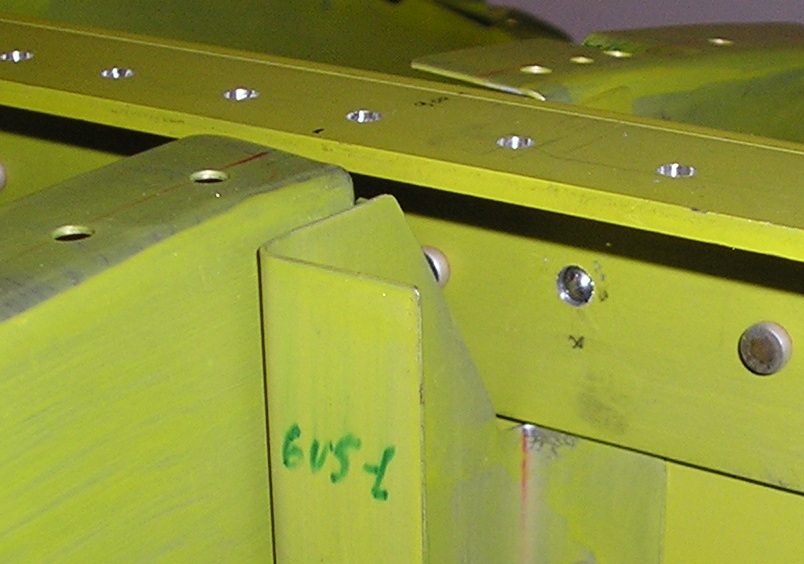

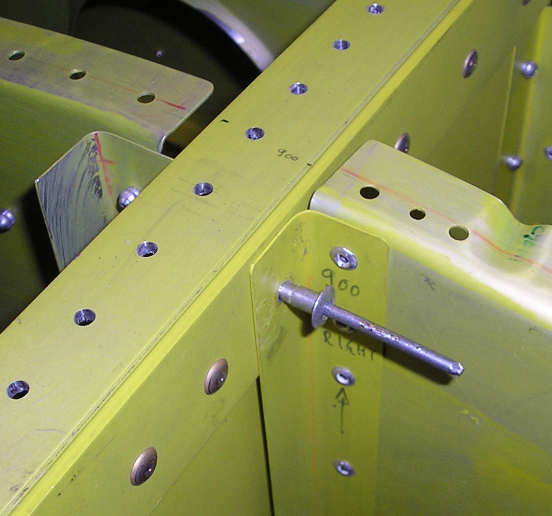

I am stuck. Literally. See pictures - this is an A6 pop rivet. It won't budge, in or out.
Access from the back is rather difficult, as the rear and front rib are already riveted. The A6 is one of the two last rivets in this station.
I can remove the rear rib, but that's my last option - and I still will have a stuck A6 after I remove the rear rib.
Suggestions?
Carlos

Hi Carlos,
The only idea I have is to use a dremel cutoff wheel to cut the
middle of the rivet. Then either pliers or drill it out.
Paul

Hi Carlos  get on the band saw Cmake a two pronged tapered wedge
from some scrap aluminum so that it fits snugly around and under the head of the stuck rivet  first apply some wax around the rivet warm (not hot) with apropane torch C then tap wedge aggressively while still warm this is how i unstuck several a6 stainless rivs   good luck

<?xml:namespace prefix="v" /><?xml:namespace prefix="o" /><![endif]--> Hi Carlos,
I would try to drive the center mandril out through the rivet, pull it through with pliers or use a small punch to get it out. Then you should be able to drill the rivet out or maybe twist it out with pliers. Just a thought.

I use a spring loaded center punch to drive the rivet stub out. Lot less pressure than driving out with a hammer & punch .

Dan, this is a 601-HD - you might be thinking 601-XL...?
The A6 are used to hold four L angles against the centre wing spar.
These L angles reinforce the attachment of four nose ribs to the spar at the landing gear stations.
Here's a close up, bottom right in this picture:
http://zodiac.pcperfect.com/images/CWing/cwing12.jpg
In this picture, you can see the ribs in question: the two outer ones, on each side. Four ribs, 2 rivets on each one.
http://zodiac.pcperfect.com/images/CWing/cwing15.jpg
BTW, the pictures are from Don Honabach's project.
Carlos
