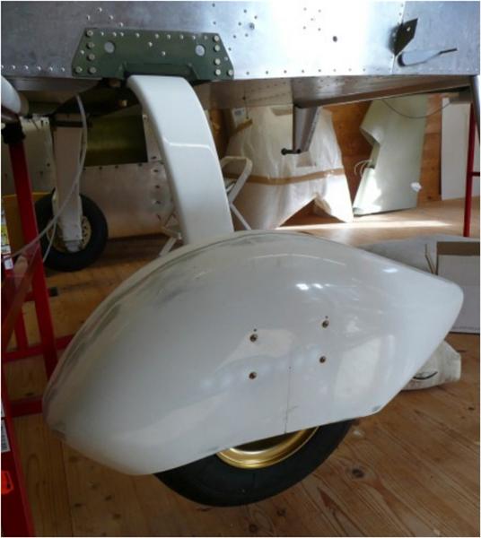

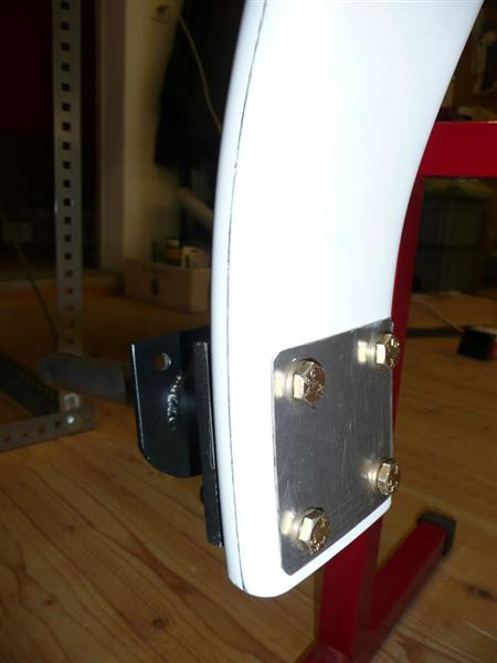

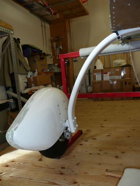

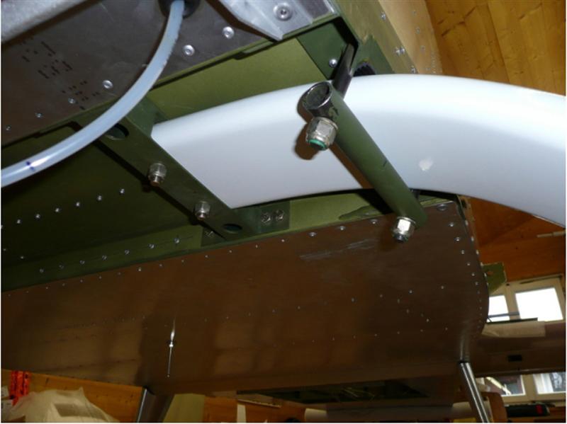

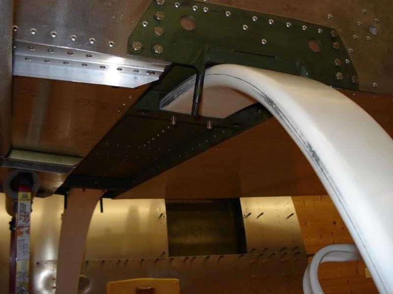

That sounds like a good price to me, assuming that he is talking about the
complete CZAW attachment package. I have been collecting information on the
CZAW gear attachment. I'll attach a couple of photos that I got courtesy of
Martin Pohl. One thing that I hadn't anticipated is that there appears to
be a steel channel all the way across the bottom of fuselage. That would
probably take something away from the weight advantage of the composite
gear, but I don't know how much. Another thing is that the CZAW axle mount
includes a standoff. Presumably that is to provide a bit of separation
between the gear leg and the (potentially) hot brake disk. Note the
composite gear leg does not go inside the wheel pants, unlike the standard
aluminum gear. Hopefully, Mat would include that in the package.
Terry

Hi, Terry, and thanks for the photos! They really do explain what the composite gear is all about in the 601 installation. I can certainly see how this configuration saves beaucoup weight over the stock, or even Grove, metal gear.
Certainly not as visually clean an installation, what with the axle stand-off, but it's always about trade-offs, isn't it? I can't tell if the installation is all blind rivets and bolts, or if there are solid rivets through the outer brackets.
