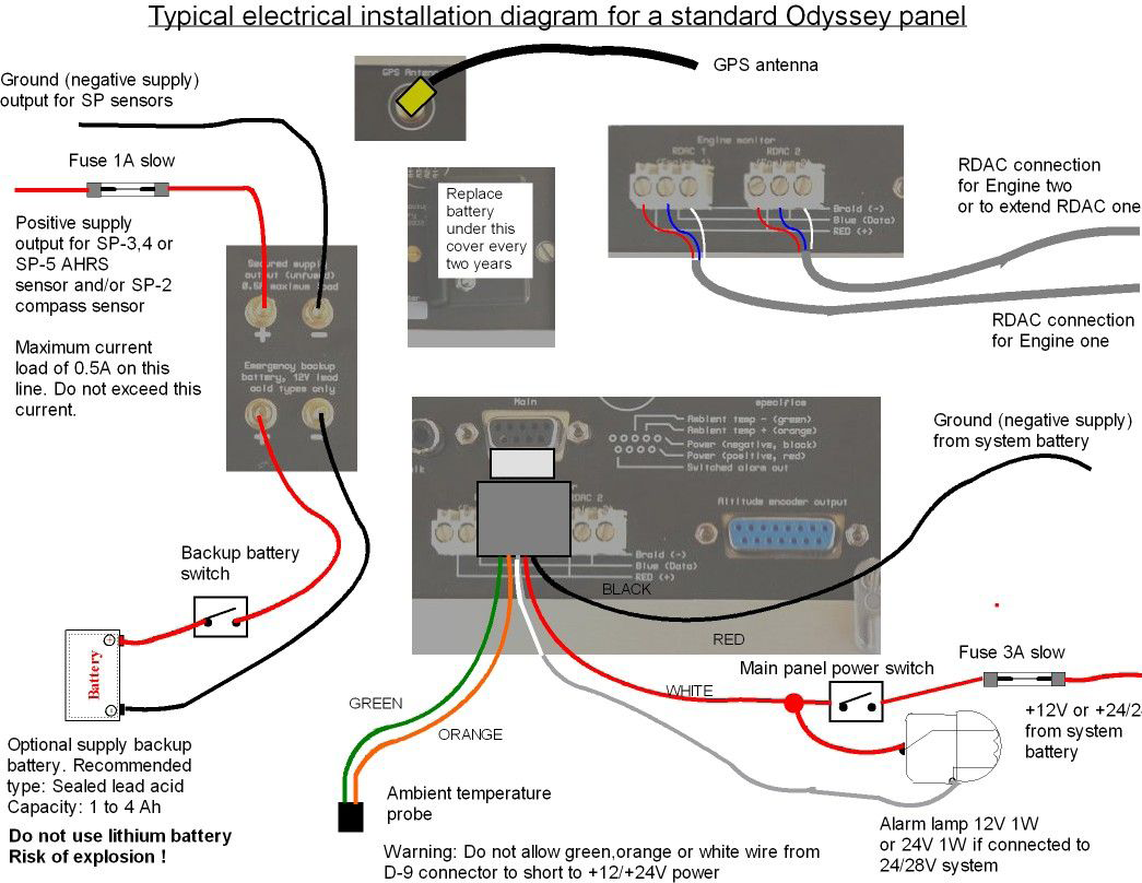

From the manual:
"...One power switch for the main incoming 12 or 24 V feed (switch in positive supply lead),
another for the backup battery.
In flight, both switches would be “on” allowing the charging of the backup battery.
Preflight check would involve switching main power on, then battery power on. Check of
battery power would involve switching main power off and verifying that Enigma continues
to operate. Voltage on the backup battery should be measured by means of the backup
voltage readouts which can be placed on any display..."
Imaged referred to attached.
 Filesize:  2.42 MB
 Viewed:  18500 Time(s)
Dan

In simple terms... if the backup battery is not on its own switch it won't charge. Two switches is simple. Trying to find a special switch to do all things at once leaves you with a non-common fix if it fails away from your home airport.....
Two switches lets you troubleshoot power problems, and lets the EFIS be powered fully during a voltage drop, like during an engine start.
