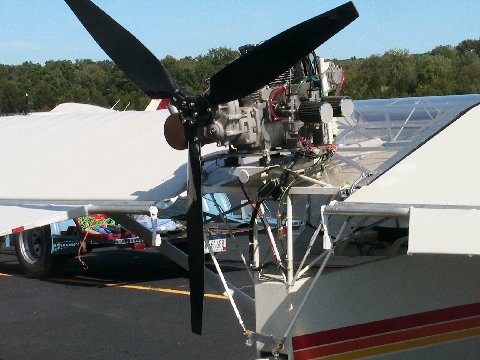

Herb, I have a Rotax 582. When I rebuilt the airplane I incorporate a mix of the 582 and 618 mounts to get the thrust line down as low as I could get it while running a 66" prop (the original factory recommendation). Then I added a 1/4" spacer at the rear to change the angle of the thrust line to the wing. I have about 1 1/2" of clearance from prop tip to boom. Seems to work for me. I'll send you pics if you'd like.

[quote="rickofudall"]Herb, I have a Rotax 582. When I rebuilt the airplane I incorporate a mix of the 582 and 618 mounts to get the thrust line down as low as I could get it while running a 66" prop (the original factory recommendation). Then I added a 1/4" spacer at the rear to change the angle of the thrust line to the wing. I have about 1 1/2" of clearance from prop tip to boom. Seems to work for me. I'll send you pics if you'd like.
Rick Girard
Rick, I am also using a 582 but with the stock thrust line. So you have raised the aft end 1/4" and the changes you have noticed are...? Details please? And the 582 and the 618 mounts differ how?

Sorry, I guessed I missed that part about the difference. It seems to take a lot of the pitch change with throttle out of it. The big difference I remember without getting the plans out is the the vibration dampers are mounted with the deep side up on the 618 mount and the short side is up with the 582.  Okay, I got the plans out and checked. Originally my plane had a version of the mount that was a bastardized version of the 618 mount, short side of the isolator up, a 2" spacer tube and shim plates. Now it just has the isolators long side up and no tubes. The overall effect was to lower the engine about 2", although it is still about 1" higher than the plans call out for the 582.
I seem to remember it was John H. who mentioned changing the thrust line by putting shims between the engine plate and the aft isolators, but my memory could be playing tricks there, too.

Herb Graff
Joined: 21 Sep 2009
Posts: 12
PostPosted: Mon Nov 09, 2009 6:22 pm    Post subject: Trim System Question Reply with quote
Yes Rick,
I'd surely would like to see your engine setup. Please send direct to my Email. Our Kolb, (a small club project, though I'm the only one flying it so far), uses a 3/8 interposer plate to translate the hole patterns, for an otherwise standard engine mount. This plate also has heat bent tabs to mount the muffler to. It took two MAP Gas torches to apply enough heat for the bending operation. A not very good picture of our engine arrangement is here:
If I get a chance I'll take a better close-up of the mount, though there is really nothing extraordinary about it.
