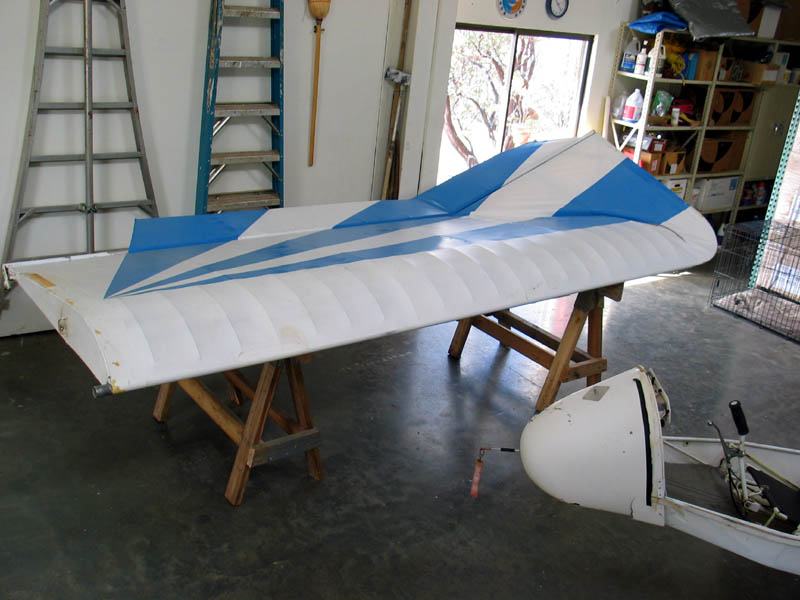

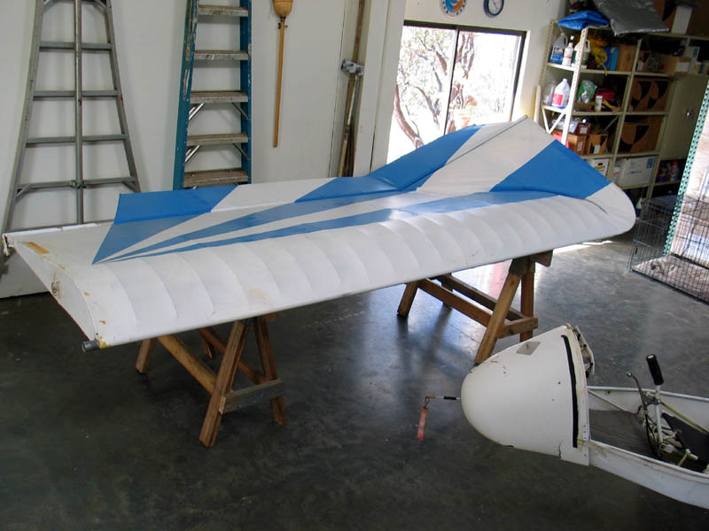

On the left wing and ailron thats damaged, I will be splicing the 1 1/4" tubing with a peice of 1 1/8 tube .058 wall and another peice of .028 wall 1 1/4" peice that I cut about 1/4" out of, down the lenght of it so it wraps around the 1 1/8" peice for a nice tight fit. then I will rivet, like four rows of rivets on about 1/2" center. It will be plenty storng, but it is going to ad some weight in that area. Should I try to add about equel weight somehow on the left wing in the same area? Or do you think it will matter?
The damaged area of the wing is between the first two ribs from the wingtip. How long do you guys think I should make the 1 1/8 peice for the splice? I was thinking about 14" for both the wing and the aileron.
here is a pic of the wing thats damaged.

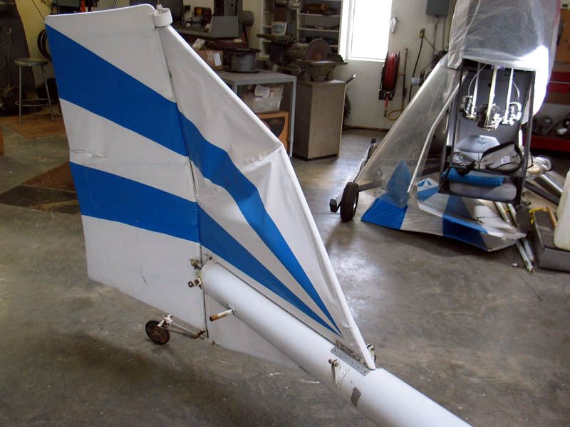

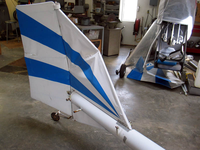

Here is a pic of the vertical stab & rudder. Mike mentioned that I might want to build a more flowing curve shape when I re-build it. Does anyone have suggestions on this, Maybe even a pattern of such I could use?
Thanks very much for your time and input, in advance.

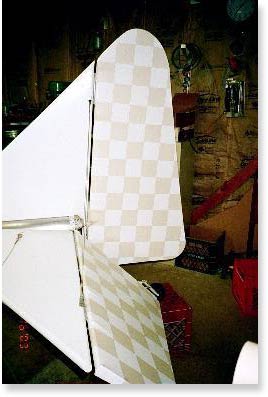

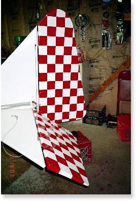

Here's a couple pictures of the Rudder......
