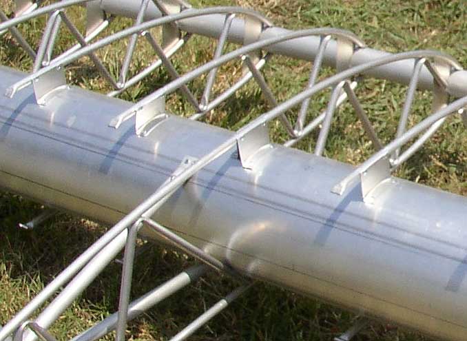

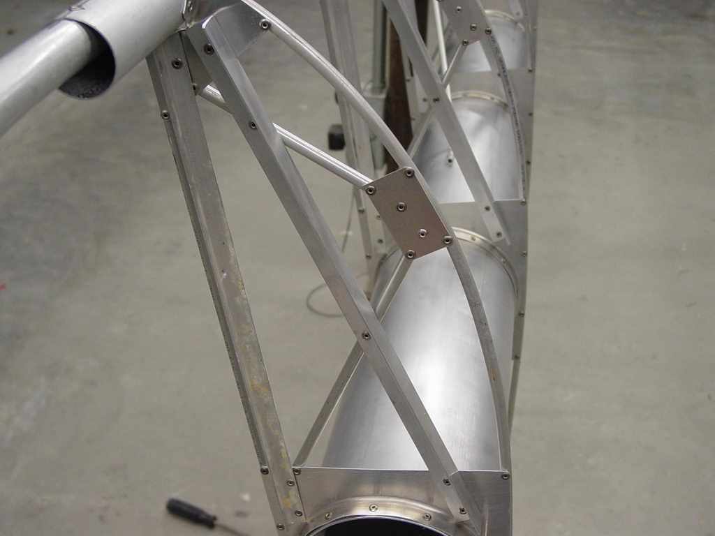

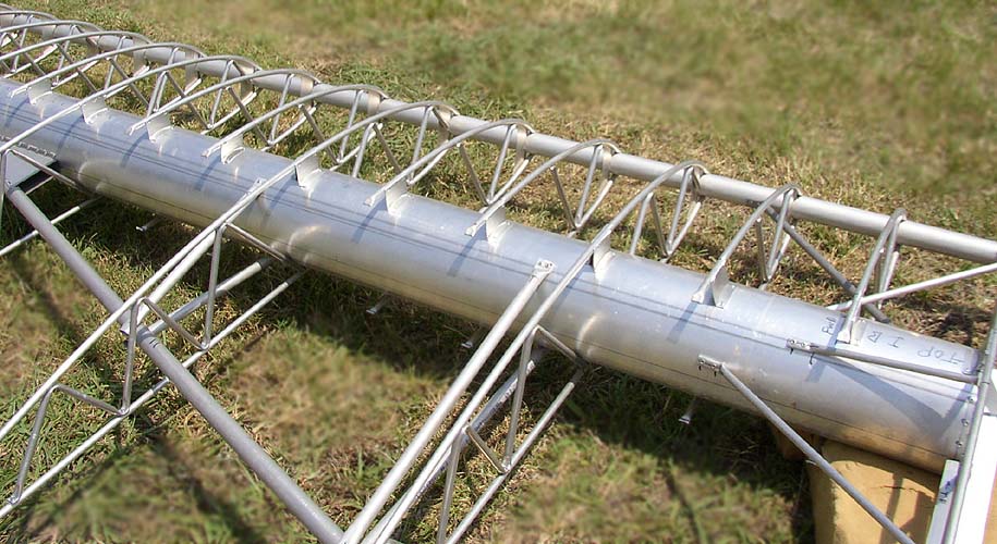

Eugene Zimmerman
Joined: 10 Jan 2006 Posts: 392
Posted: Sat Apr 08, 2006 12:01 pm Post subject: Converting Five Rib Wing To 10 Ribs? |
Bill.
It could be possible.
I would want to keep the top and bottom tubes of the ribs all one piece.
You may be interested in seeing how the Kolb rip off guys make their
ribs.
Check these wing details.
http://n5.se/sK
http://n5.se/sQ
http://n5.se/sR
Please understand I'm not recommending this, just showing you some
ideas.
Gene

Eugene Zimmerman
Posted: Sat Apr 08, 2006 1:20 pm Post subject: Re: Converting Five Rib Wing To 10 Ribs? |
Sorry about the dead links.
I'll attach the actual photos.

a58r(at)verizon.net Guest
Posted: Sat Apr 08, 2006 1:23 pm Post subject: Converting Five Rib Wing To 10 Ribs? |
re: http://n5.se/sK etc. "Document Not Found"
regards,
Bob N.
| Back to top |
Eugene Zimmerman
Posted: Sat Apr 08, 2006 1:34 pm Post subject: Converting Five Rib Wing To 10 Ribs? |
Sorry Bob,
I was trying to avoid using the "F" word but it didn't work as intended.
Trust you can open the attachments.
Gene

slyck(at)frontiernet.net Guest
Posted: Sat Apr 08, 2006 2:10 pm Post subject: Converting Five Rib Wing To 10 Ribs? |
That is a nice wing. The tip bow could use an anti-shrink support in
the
last half.
No flanges! they don't worry much about twisting moment.
-BB do not archive

planecrazzzy Guest
Posted: Sat Apr 08, 2006 4:58 pm Post subject: Re: Converting Five Rib Wing To 10 Ribs? |
OK,
In the Kolb plans....Your NOT suppose to rivet on the "TOP" or
the "BOTTOM" of the wing spar.....because it would weaken it.....where it
does it's flexing..... you have rivets all over that area.....why ?
Is that a Kolb wing ?
Gotta Fly...
Mike in MN
| Back to top |
planecrazzzy Guest
Posted: Sat Apr 08, 2006 5:04 pm Post subject: Re: Converting Five Rib Wing To 10 Ribs? |
Oooops,
I see it's a Fergie.....Still , a bad place for those rivets...

WhiskeyVictor36(at)aol.co Guest
Posted: Sat Apr 08, 2006 6:22 pm Post subject: Converting Five Rib Wing To 10 Ribs? |
In a message dated 4/8/2006 5:23:42 P.M. Eastern Standard Time,
etzim62(at)earthlink.net writes:
Thanks Gene,
I see that they have the ribs attached by a bracket or gusset riveted to the
very top of the main spar. This is one area that "Kolb" recommended no
holes be drilled.
Bill Varnes

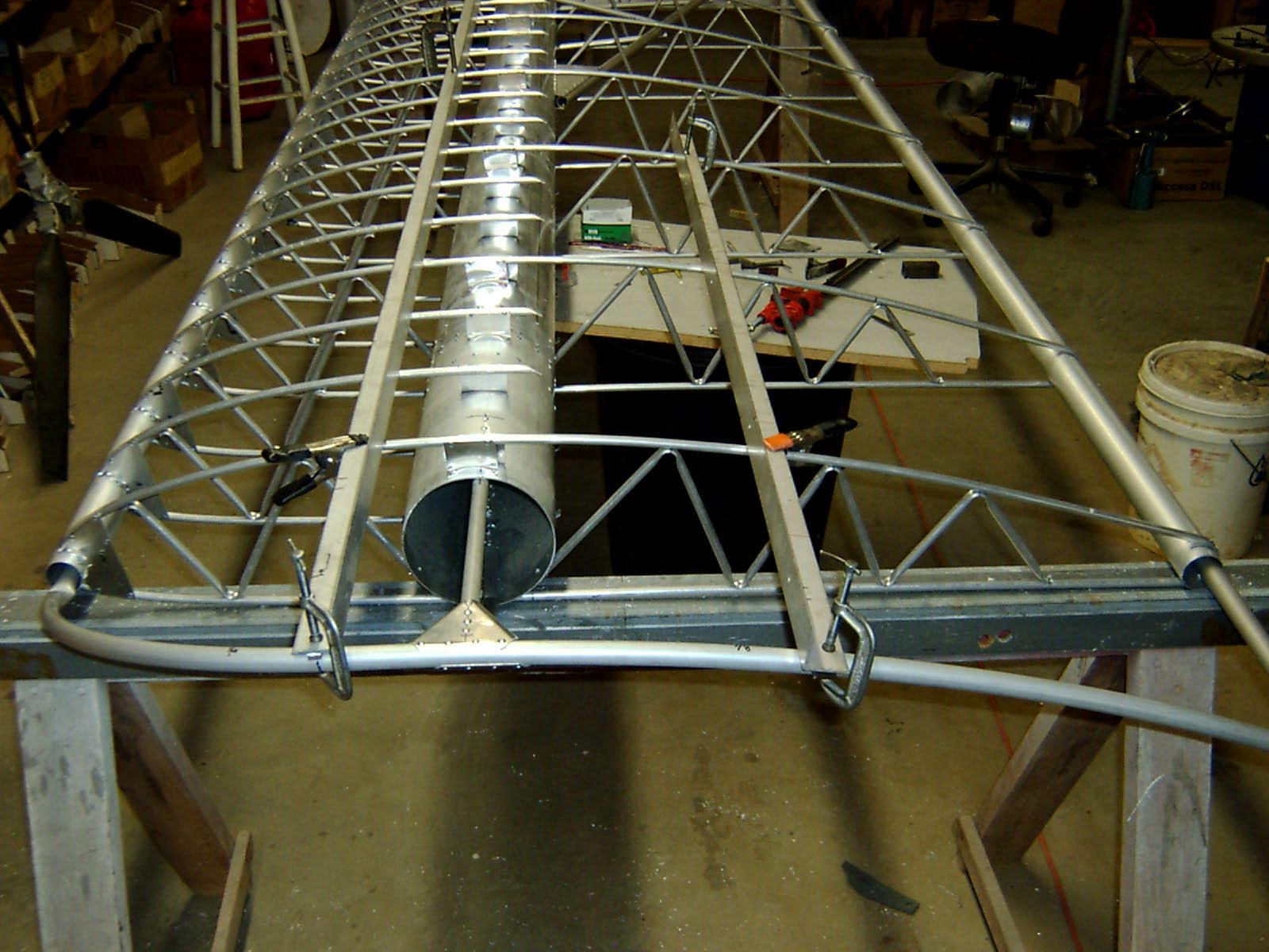

Possum
Joined: 12 Jan 2006 Posts: 112 Location: Georgia
Posted: Sat Apr 08, 2006 10:17 pm Post subject: Re: Converting Five Rib Wing To 10 Ribs? |
| Eugene Zimmerman wrote: | Sorry about the dead links.
I'll attach the actual photos. |
Here are some better ones.
| Description: |
| Filesize: |
110.96 KB |
| Viewed: |
555 Time(s) |
| Description: |
| Filesize: |
191.18 KB |
| Viewed: |
610 Time(s) |
| Back to top |

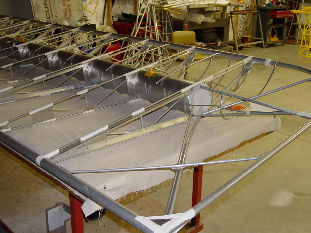

JetPilot
Joined: 10 Jan 2006 Posts: 1246
Posted: Tue Apr 11, 2006 8:56 am Post subject: Re: Converting Five Rib Wing To 10 Ribs? |
I really like the idea of douling the number of ribs in the wing. That will only add a few pounds and will make it a lot stronger.
If more ribs becomes to daunting a task, streingthening the existing ribs is also a possibility. Attached are some pictures of my MK-III wing with rib streingthening.
I would also suggest streingthening the wingtips while you are at it. There have been a few reports of wingtip flutter at high speeds, and also that is just a fragile area that gets a lot of abuse and handling. Streingthening that area is just a good idea.
