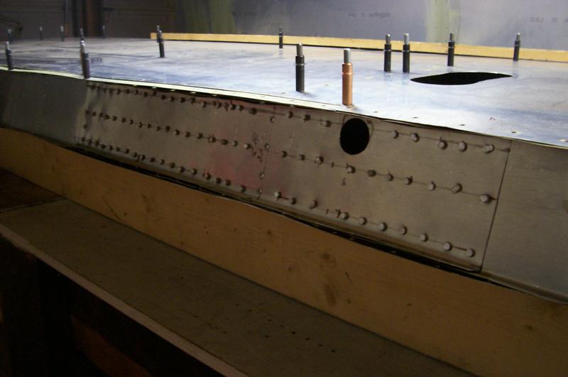

Interesting information. The location of failure is for sure a weak spot on the wing. I noted this weakness before my plane even flew. I always thought it odd that such a large hole would be placed in a critical component but I figured someone knew that it was OK; maybe not...

PostPosted: Fri Oct 30, 2009 10:10 am    Post subject: Additional NTSB Documents Reply with quote
This is what I did to beef up that area. I'm not advocating this for anyone else..use your own discretion.Terry Turnquist

I didn't like the looks of this hole when I built my 601, but didn't make any changes. I am actually happy that this inspector has followed up on this. Seems that this could be a problem especially with any quick aileron inputs with the piano-hinged ailerons.
This is certainly a lot easier to fix than counter-weights on the ailerons.
The strength is in the top and bottom (like an I beam) so an extra plate on the top and bottom of the wing would be all that would be required.

I used the leftover outboard rear spar cut-off to "double-up" the rear spar aileron rod hole area. The holes do not need to be that large but they need to be close to the bottom of the rear spars to clear the aileron rods.

Why use a hinge part instead of just cutting some aluminum to
reinforce the rear channel?
Also, why not reinforce both sides of the rear channel - both the top
and bottom? After all, the web has been essentially removed in that
area. Perhaps it is the web that should get a doubler rather than the flange.
Paul
