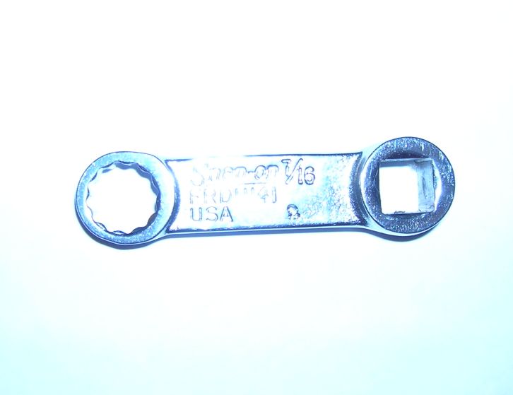

Mike, all, a little late to help with your engine, but it might save someone else some grief. Snap On Tools has torque adapters like the one pictured. They're available in metric sizes of 10, 13, 15, and 18 mm. Like all Snap On stuff they're pricey, $30 for the 13mm. On the other hand a 3300 lists for $16,500. Cheap when you consider what can go wrong. Snap on makes them so it's 2" (50.8 mm) between centers and includes formulas for calculating corrections in torque readings when the adapter is used in line with the torque wrench.
Rick Girard
 Filesize:  56.21 KB
 Viewed:  10310 Time(s)
info(at)flylightning.net

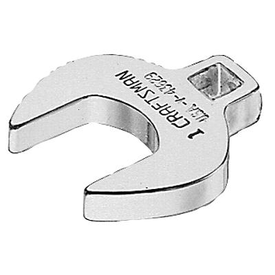

PostPosted: Wed Oct 28, 2009 6:20 am    Post subject: cylinder nuts Reply with quote
Also called a “Crows-foot” wrench if ordering from other places.
Nick

The correct size is 7/16" C not 13 mm.

PostPosted: Wed Oct 28, 2009 9:55 am    Post subject: cylinder nuts Reply with quote
Nick, this is a crow foot wrench, I did a search for a box end crow foot and found only one source, available only in a set and the drive was wrong for using a torque wrench with them. If you go to Sears and ask for a crow foot this is what you get, and as Mike experienced they don't work out too well. The first picture I posted is the torque adapter I bought to torque the heads on my Shovelhead Harley about 15 years ago. Always gives a correct reading and never rounded a head bolt. Do what you wish, it's a free country, but I buy tools as good as the project. Saves money and time in the long run to do the job right the first time.
Rick Girard

PostPosted: Wed Oct 28, 2009 10:49 am    Post subject: cylinder nuts Reply with quote
The question than begs what is the project?
nick

PostPosted: Wed Oct 28, 2009 11:16 am    Post subject: cylinder nuts Reply with quote
In this case it's loosening and torqueing cylinder, or in my case, head bolts.
Rick

PostPosted: Wed Oct 28, 2009 12:52 pm    Post subject: cylinder nuts Reply with quote
Meant what aircraft are you building?
nick

PostPosted: Wed Oct 28, 2009 12:59 pm    Post subject: cylinder nuts Reply with quote
Oh, I have a Kolb Mk III that desperately wants a 2200. Smile
Rick
Rick Girard
On Wed, Oct 28, 2009 at 11:51 AM, Naftali Horowitz <naftalih(at)hotmail.com (naftalih(at)hotmail.com)> wrote:
The correct size is 7/16", not 13 mm.
