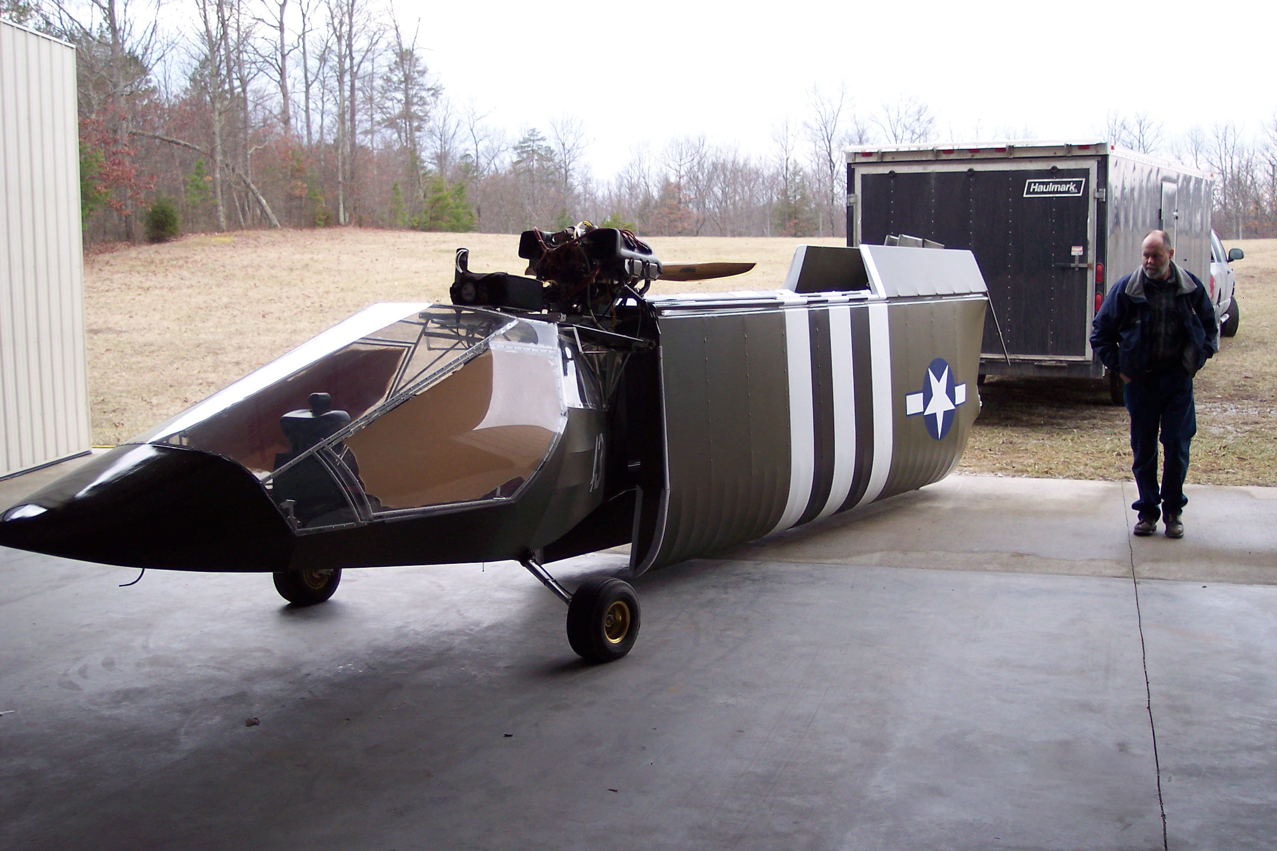

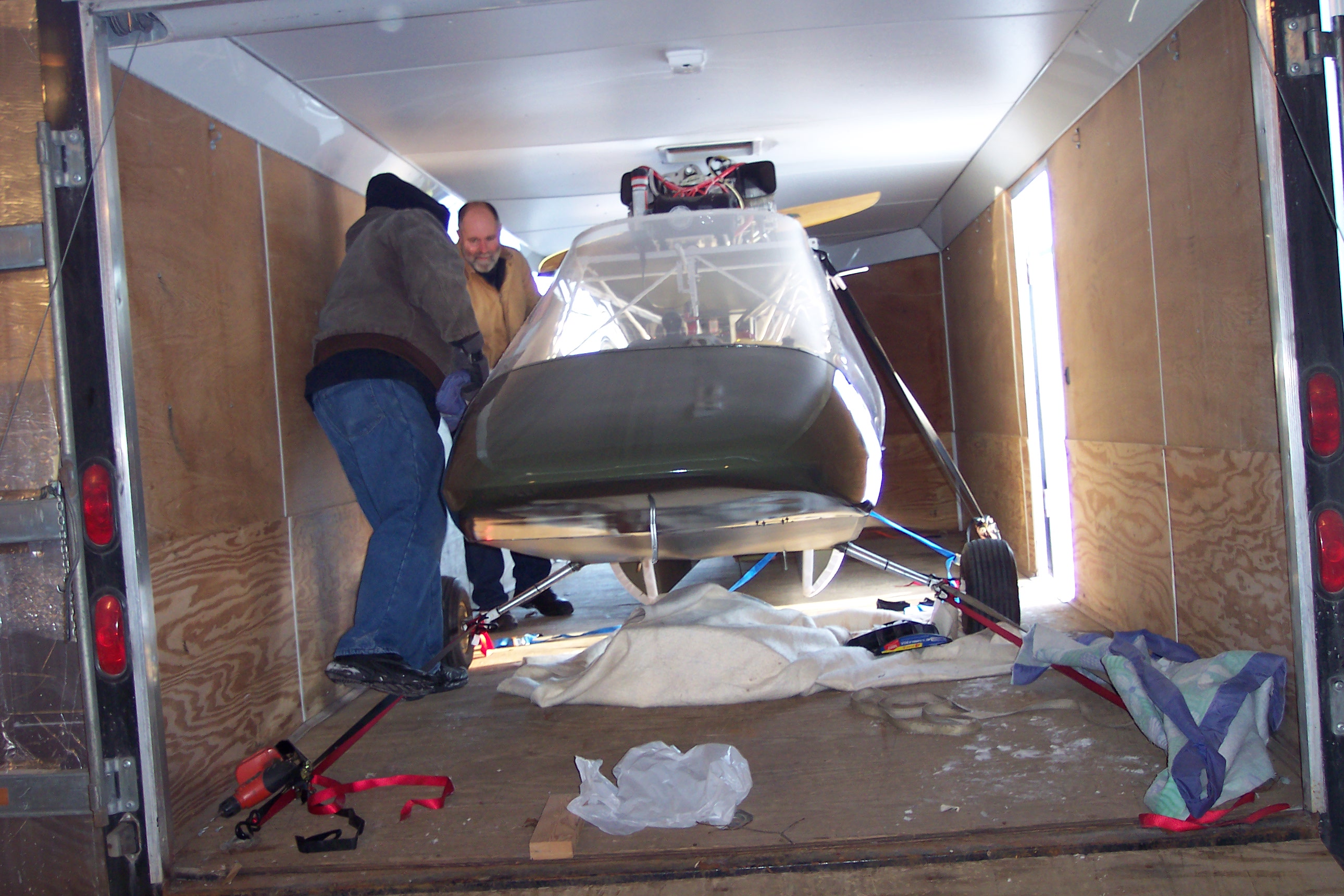

Hello....I brought my M3X home from London,Kty last January to Houghton Lake Mi with a 25' enclosed snowmobile trailer and it was to small ....a 27-28' trailer would have been perfect.If you are building it ,make sure the header coming in the back is at least 6' tall.I got mine in,but we had to leave the door open a bit in the back and seal it off for the trip.Also I would take the wings off and mount them on the sides of the trailer.we didn't putting it in and we had a hell of a time getting it in...when we got home,we took the wings off and everything came out real nice.I will post pictures tomorrow of the plane in the trailer.I'm sure everyone else has a better way,but thats how I would do it....

Here are a couple of pictures....

Don`t want to teach my granny to suck eggs and you have probably done this
by now but a couple of battens laid a few inches apart on the floor of the
trailer enables the tail wheel to be guided into position while pushing the
plane from the front.

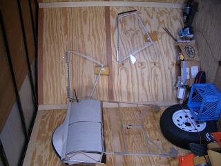

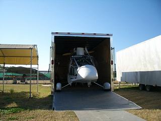

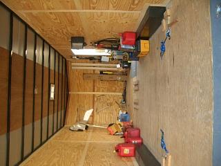

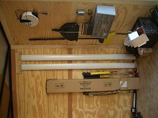

A couple more picts
G.Aman MK-3C over 9000 miles trailering the plane with wings folded with no damage.
zeprep251(at)aol.com
PostPosted: Fri Oct 23, 2009 6:53 am    Post subject: Building Kolb Mark 3 enclosed trailer sizing? Reply with quote
Powerglider,
Need the V-nose to have enough room even for the C model.Basic trailer is a car hauler 24"plus the V nose.
G.Aman MK-3C Jabiru 2200 495hrs

PostPosted: Fri Oct 23, 2009 6:57 am    Post subject: Building Kolb Mark 3 enclosed trailer sizing? Reply with quote
Powerglider,
You need the V nose to clear even the C model comfortably.This is a car hauler with 7' opening and 24' length plus 30" or so added by the V nose.
