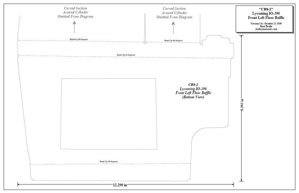

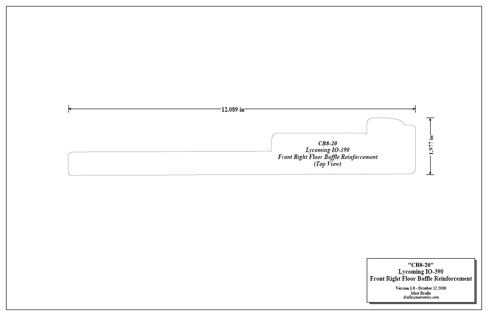

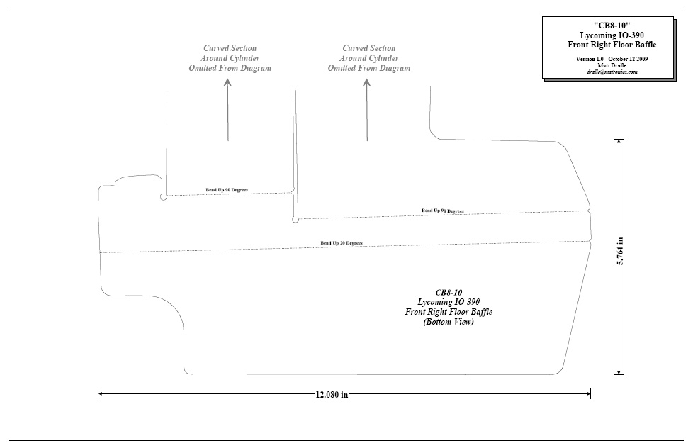

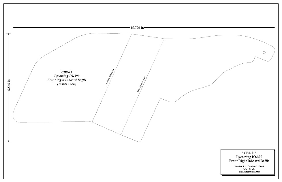

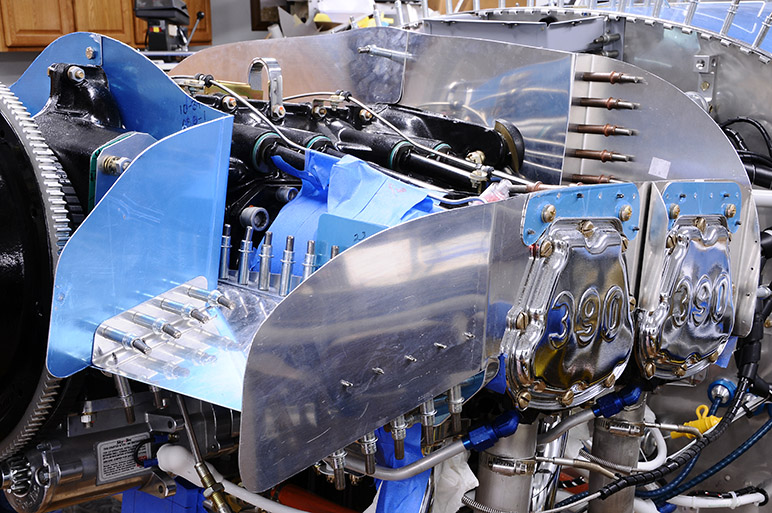

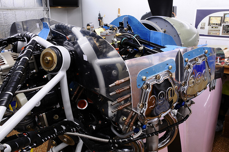

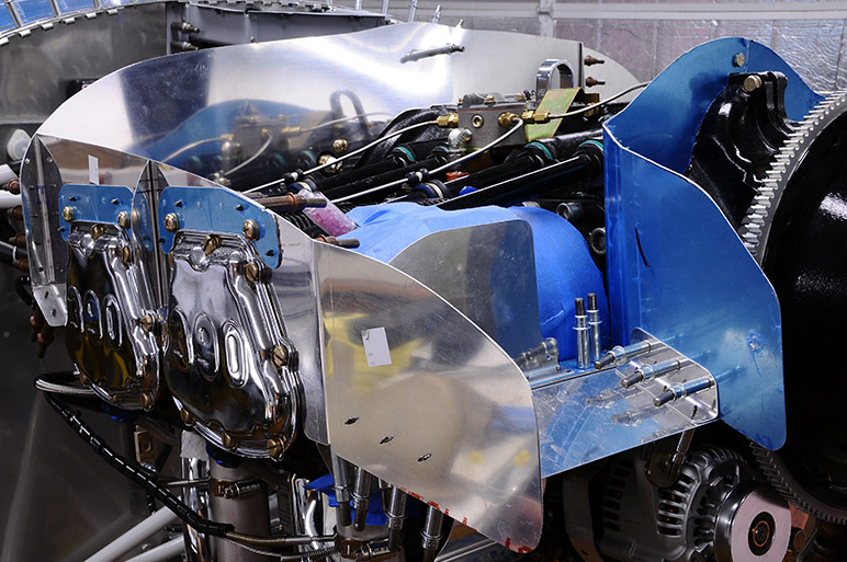

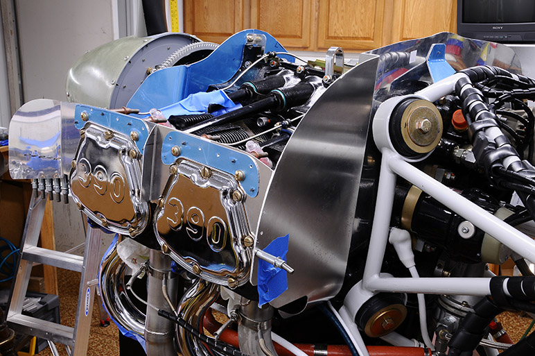

Dear Listers,

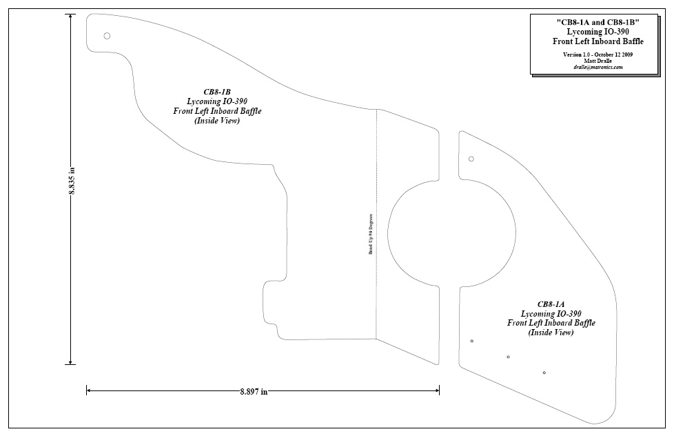

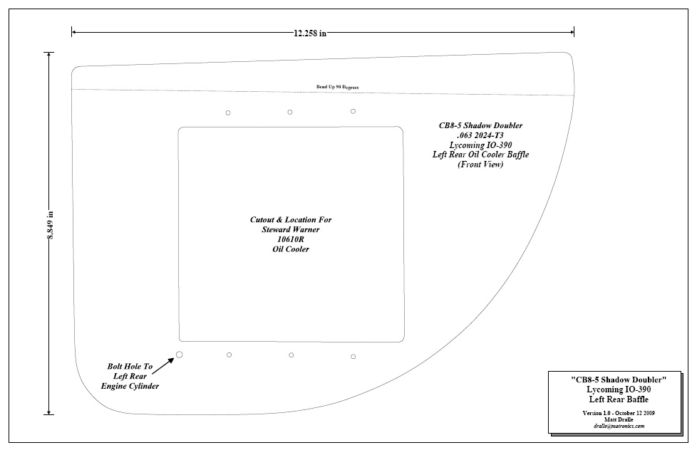

I have created CAD drawings of the custom baffle pieces I made for the Lycoming IO-390 installation on my RV-8 project. Other builder's utilizing the Lycoming IO-390 in their RV-8 or RV-7 should be able to use these templates to greatly speed up the baffling installation. Note that these templates also include the cut-down for the top cowling installation. Builders may want to leave the tops longer than the templates to assure they get a good fit to the cowling.
Attached are the low-res, non-scale JPGs of the templates for reference only. The high resolution, full-scale PDFs can be downloaded from my RV-8 web site:
http://www.mattsrv8.com/users/display_log.php?user=MattsRV8&project=638&category=2972&log=90450&row=2
The PDFs are meant to be printed 1:1 on 11x17 paper. Be sure to use the reference dimensions in both the X and Y to verify that your printer is creating scale diagrams.
Note these pieces worked on my installation, but they may or may not work on others. No guarantees that they will fit any other installation.

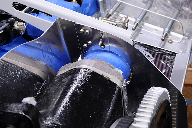

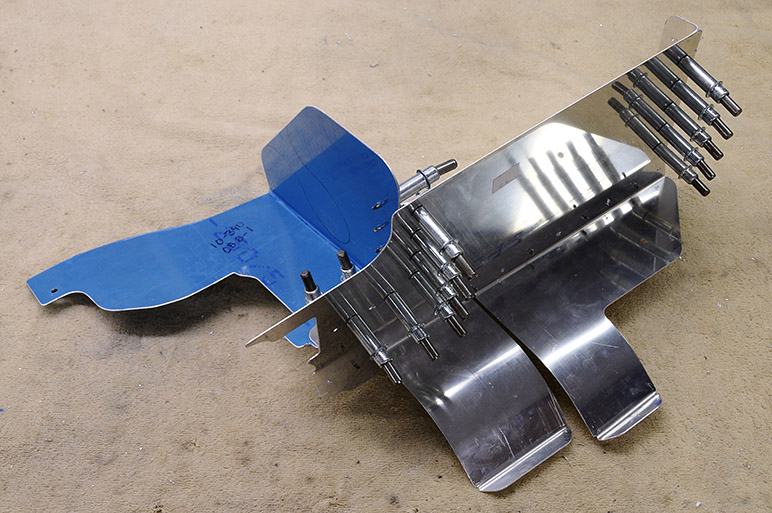

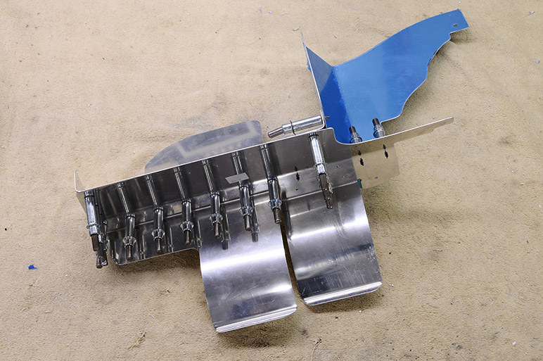

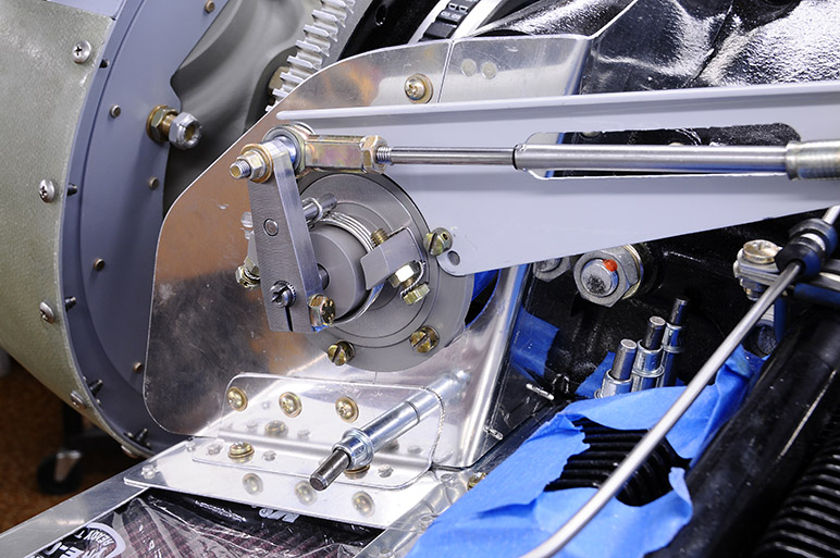

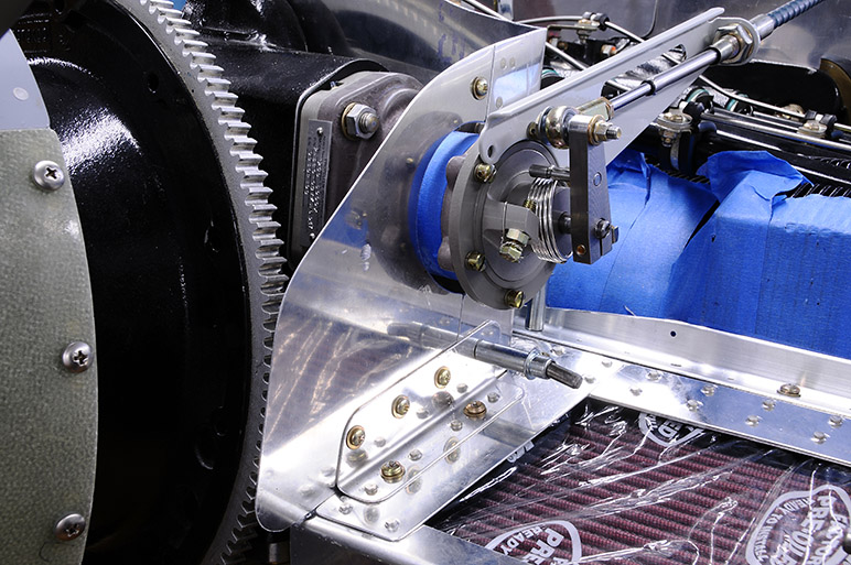

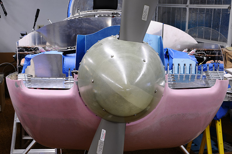

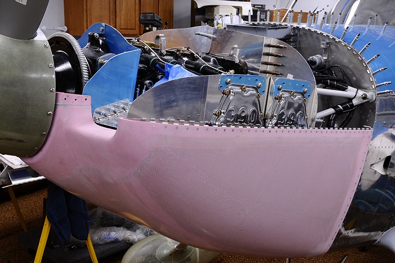

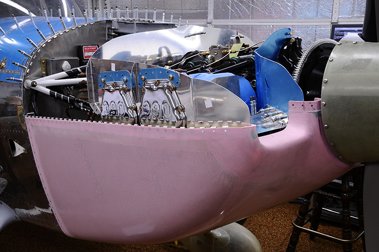

There are many more pictures and descriptions of the installation on my RV-8 website:
http://www.mattsrv8.com/users/category.php?user=MattsRV8&project=638&category=2972
