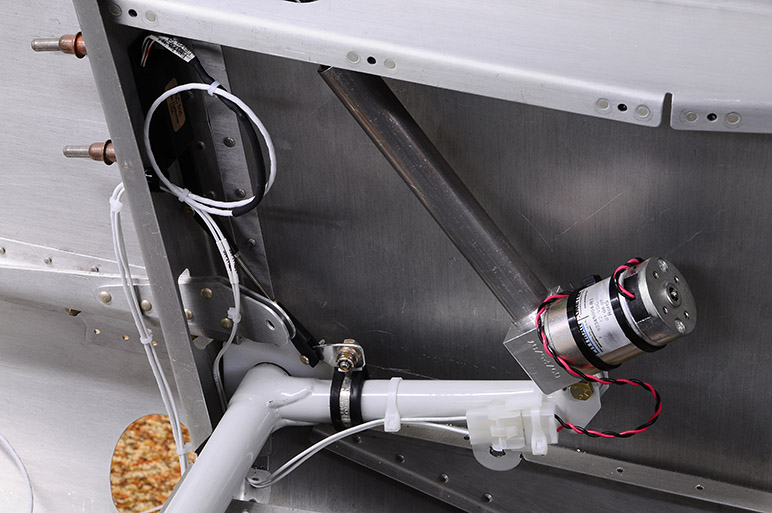

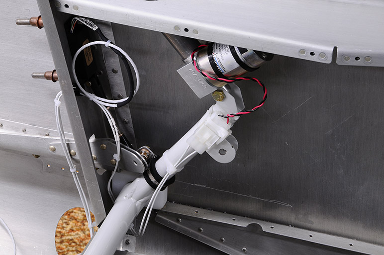

Here are a couple of pictures of how I wired up my RV-8 flap motor. Notice how the attached red/black wires are secured to the motor with a couple of wire ties and that there is a generous service loop going into the connector. With this arrangement, there is never any movement of the wires going to the motor connector when the flap motor is moving. Seems like it should be pretty long-term durable...
Matt Dralle
RV-8 #82880 N998RV

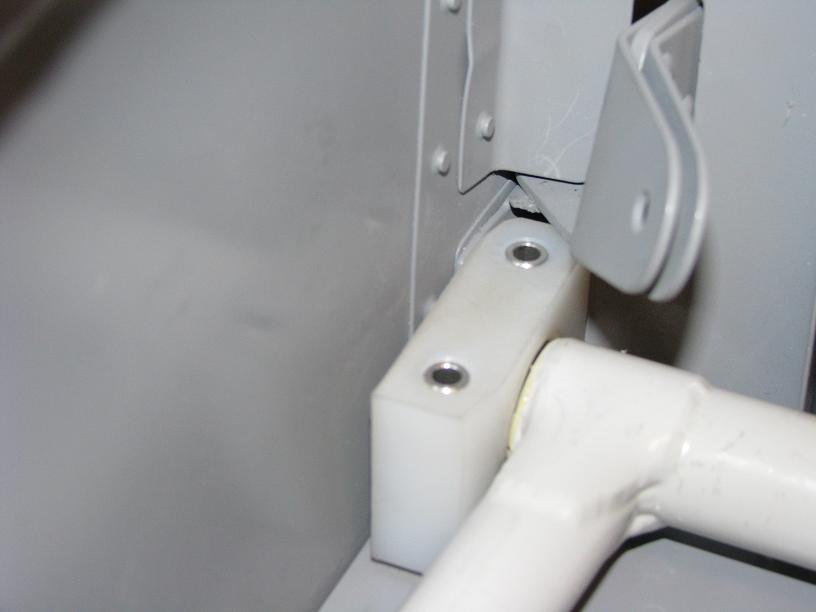

PostPosted: Fri Oct 16, 2009 12:23 pm    Post subject: Flap motor - failure, prevention and request Reply with quote
When I was installing the flap actuator, I could not get the bolts on the nylon bushing tight without the actuator binding. I ended up reaming the holes in the nylon blocks out to 5/16 and making some bushings. I also capped the top of the blocks with a piece of .06 aluminum. This allowed me to torque the bolts properly with no binding of the actuator. I have no idea if this will help the longevity of the flap motor, but it can't hurt. The motor was noticeably quieter with no binding as would be expected. The other thing I did was add two zener diodes back to back at the motor connector hoping to alleviate voltage spikes and arcing of the motor brushes. Again, no data yet as to whether or not this increases motor longevity but again it can't hurt.
Chris Welsh

PostPosted: Sat Oct 17, 2009 5:21 pm    Post subject: Flap motor - failure, prevention and request Reply with quote
Chris,
Great info. I did something similar, but not to the extent you did. I'll relook those issues.
Stan Sutterfield
Chris Welsh
