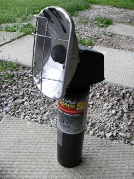

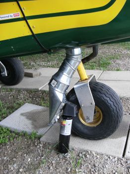

i find my rotax will kick back if it is shut down too hot and running on low octane mogas. not ever when runniing on premium fuel.
i also use a simple heater i assembled myself. easy to use and carry on plane if i must. one bottle will run for hours but i only need to heat for about 30min preflight. . i also have a car battery wrap that is wrapped around oil res. all winter. usually plugged in for the same 30 min or overnight if i know i have an early flight with -01deg C.
just a small camp heater LPG/ propane, a 6"duct pipe for floor register , reducer and a 4" elbow. i fit the heater inside the pipe and prop into position. cool air mixes with heated air as it rises up the pipe. a blanket (skin)over the cowl and leave the cowl vents open to allow air to escape out by the gearbox. you can feel this air and determine when engine is toasted enough. I also have a very large sheepskin at the hanger. I clean the windscreen after every flight. and put it fuzzy side down on the screen to keep road dust off in summer , my hanger backs onto a main gravel road. i use it over the cowl as a insulating blanket in the winter and wrap the legs around prop to keep snow out in the winter, open front hanger. makes a great ground sheet to Neal on to work on the plane. as of yet i have no cabin heat so take the skin with me sometimes to insulate whatever.. also helps as an engine wrap when parked on a cold windy apron while attending early morning winter flyin breakfasts
edit ..... sorry files where too big .... try these

What is in the bottle? Sure would like to be able to see the pictures. Please try again.

PostPosted: Sun Oct 18, 2009 5:55 pm    Post subject: Re: Rotax 912 ULS kicking back! Newbie needs a hand .. Reply with quote
Hi Dashwood,
This is a bad idea.
Probably not a good idea to use a propane type heater around fuel. If you have any vapors under a cowl then you may get a surprise, not to mention Rotax carbs at times leak from the floats not shutting off the fuel completely.
(30 year retired firefighter)
