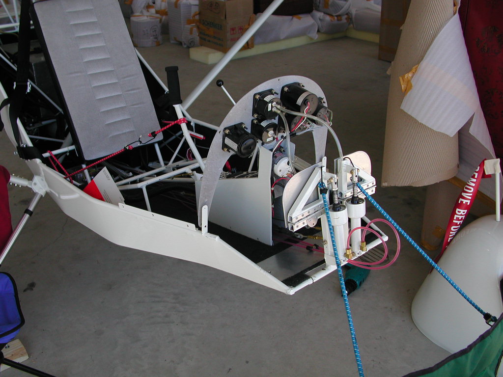

PostPosted: Fri Oct 02, 2009 1:57 pm    Post subject: Re: Heel brakes or ??? Reply with quote
Burt Rutan did not get locked into a world of conforming to what is accepted as standard. Either did Homer Kolb.
I still read the Kolb List even though my FS has a new owner.
Fly safe all,
Jim
My Brake Set Up. Worked fine.
 Filesize:  159.51 KB
 Viewed:  20378 Time(s)
Jim O'Day
Fargo, ND
Fly safe all,
Jim
Jim,
That is a really nice workmanship on your firestar pedals.
As far as Burt Rutan, I would be willing to bet his recent airplanes have toe brakes and a standard set of controls as possible. There is a difference between trying to to do something better, or more efficiently, and taking shortcuts that result in non standard unfriendly controls. Burt Rutans work speaks for itself, he is all about advancing aviation and making things better, not taking shortcuts. Funny that a forum that rejects the aerodynamic facts of properly designed wingtips, and until very recently VG's, would quote Burt Rutan. Most people on this forum have been on the wrong side of what Burt Rutan is all about...
Standardized flight controls is something that has been accepted by the entire aviation world, the fact that you guys are arguing against this just shows that have little interest in discussing aviation subjects, and more interest in discrediting and disagreeing with any point made by me. No wonder the Kolb list has been so quiet lately, its become an unfriendly place that values personal politics over good advice and facts.
Mike

PostPosted: Fri Oct 02, 2009 5:52 pm    Post subject: Heel brakes or ??? Reply with quote
So - do you have any pictures of your heel brakes setup, especially any
from the underside with the skin or the nose bowl off? Maybe you got
something I can copy.
Richard Pike
Rev/Gang:
I probably have some pics of the brakes at home.
I built them per Kolb MKIII plans on the right side of the cockpit.
Used MATCO horizontal master cylinders and a loop of 1/4 clear plastic fuel
line for the reservoir. Drilled a couple 1/8" holes in the top of the loop
which is attached to the tube the rudder pedal springs are attached to.
