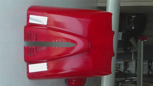

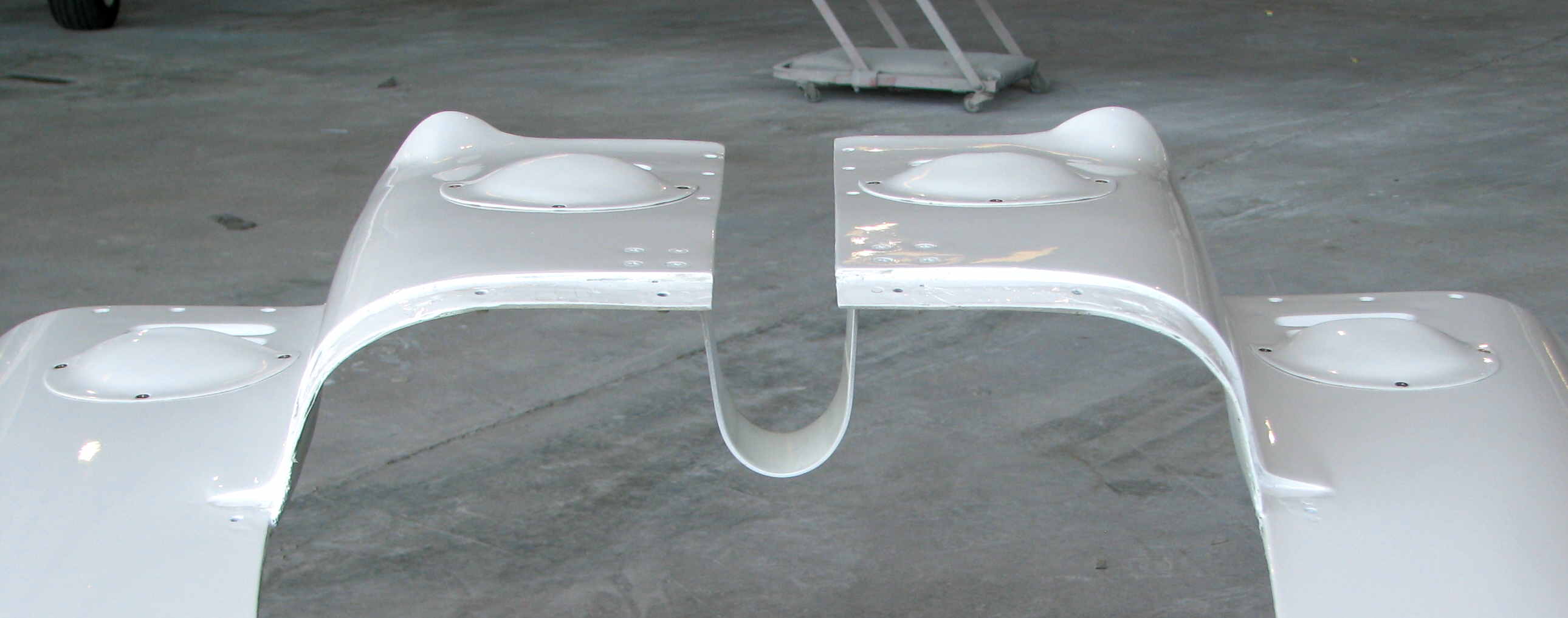

I think I have my high oil temps problem under control finally. I previously
had added another oil cooler on the right side but still was seeing temps
climbing too high. I added 2 non-retractable cowl flaps on the bottom. The
rectangular opening in the cowl is 4 x 9 inches. The opening at the rear is
2 x 4 inches. They are non-retractable because the mufflers would interfere.
This seems to be a final fix. I wish I had added the cowl flaps before I
tried the 2nd oil cooler.

Sure how this does the job Albert. Of course the AZ hot temps are on
their way out, so limited testing wx remaining.
If it proves to be the fix, it sure would point to the original
lacking sufficient exit area.

If the flap is a solution , it needs to be retractable for high altitude/
winter and speed. Those cowl flaps are going to cause lots of drag.

I think the cowl flaps are creating a venturi effect that's sucking some
more of the air out of the lower cowl .... much like the louvers do. I
wonder if widening the ramp would be more effective with less drag.
Maybe a 'lip on the bottom of the ramp would also be beneficial. Just
wondering out loud!!!

FYI we tested the lip under the ramp as you described with no noticeable
temp improvement. This was before we added the louvers so we may have
tried to overcome too much heat with this small mod. Obviously there are
many possible design solutions for this lip but our testing showed no
benefit. Again who knows if we cut back the trailing edge 0.5" or made a
wider lip or, or, or....

At one time I put some angle pieces of aluminum scrap along the bottom
of the cowl in a couple places, trying to make a few vortex generators
that would perhaps pull more air out the cowl. It did seem to me that
this helped. I don't have them on any longer, but I can see putting
them on and trying them again some day. Seemed like a little
easy benefit.

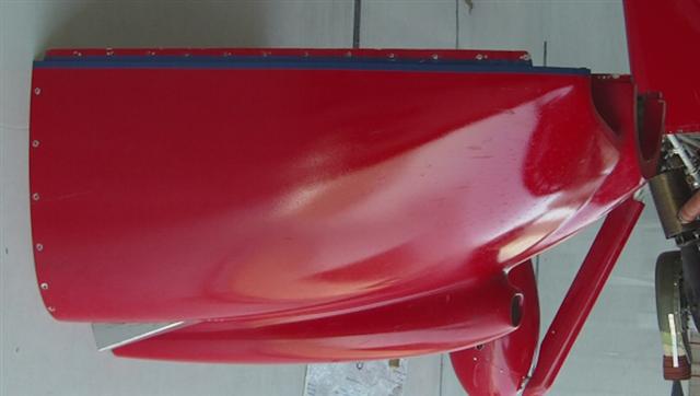

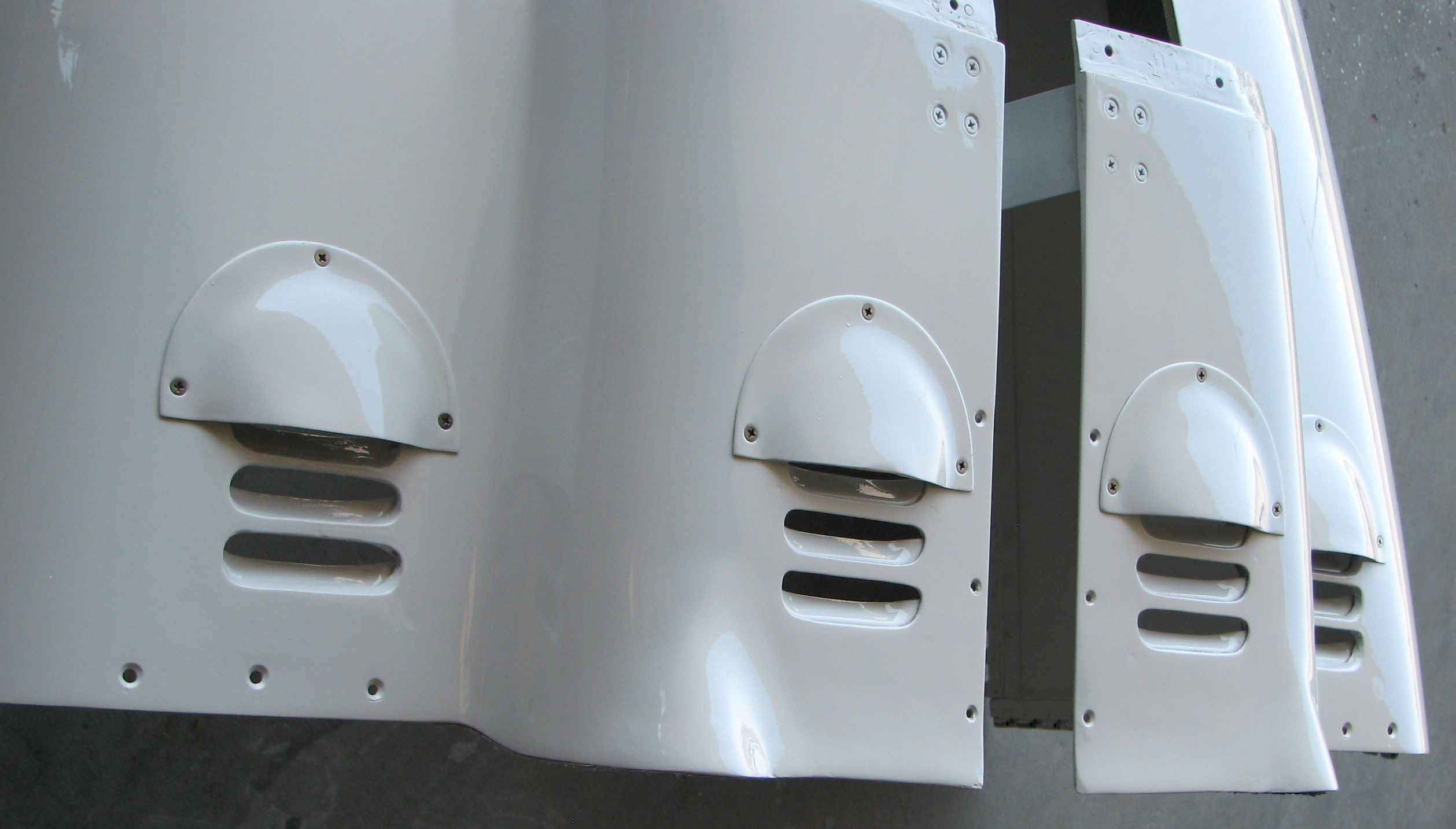

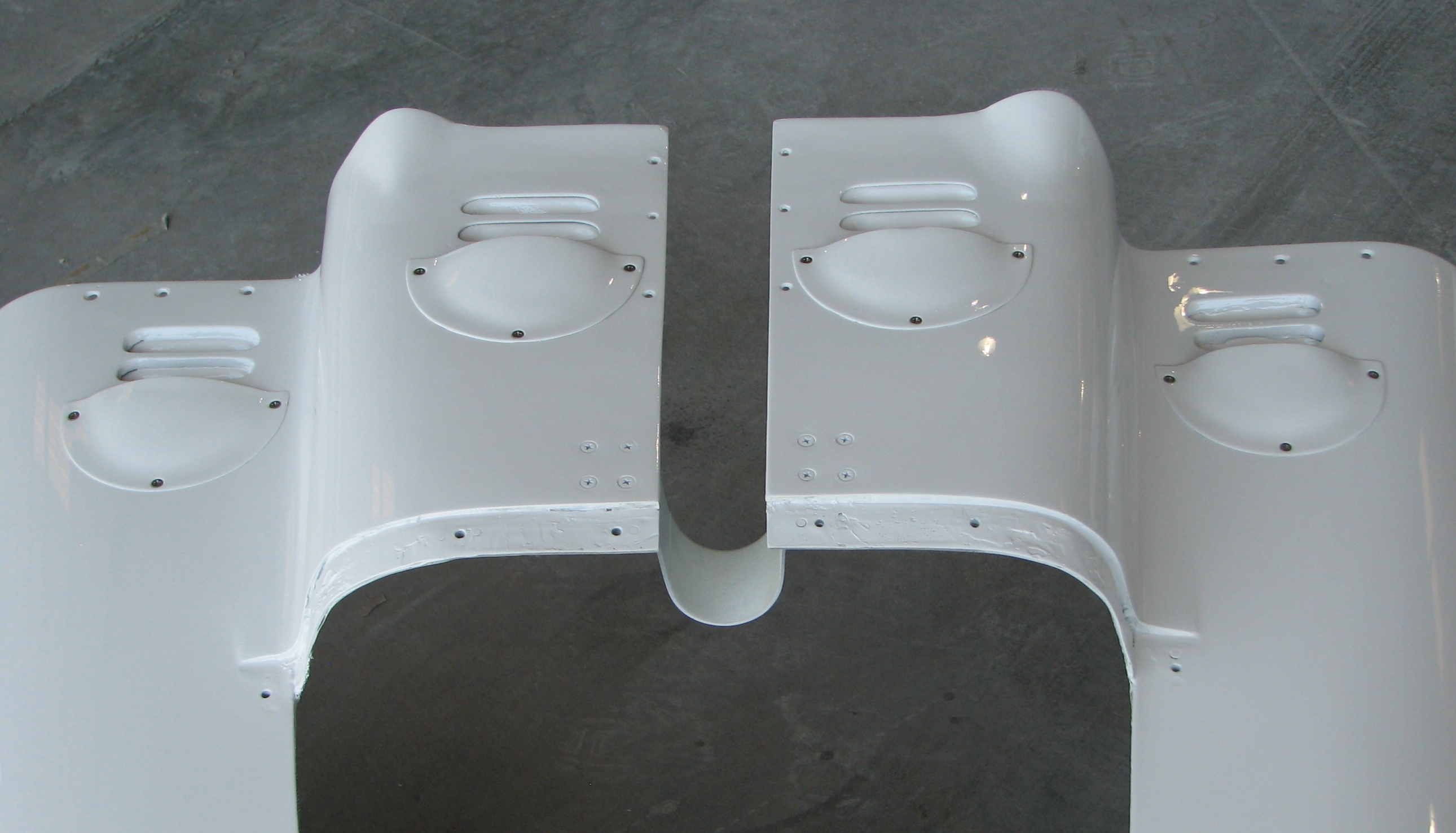

Here's what I did.... pretty sure it helped, but I didn't fly for 3-4 weeks while the plane was being painted. Temps are manageable, but I've got a couple of more ideas up the ole sleeve.
If these pics are too big, please don't open.

To those challenged with high oil temps on your RV-10, Airflow Systems (not Airflow Performance, a common mistake) offers the use of our digital manometer for free for one week to RV-10 owners and others (you pay freight and insurance both ways). This is available even if you do not have one of our 2006X or 2008X oil coolers.
With the help of many RV-10 owners we have found the following from our testing:
The stock RV-10 and James cowl do not have the desired pressure differential for optimum cylinder and oil cooling, as supplied.
Adding louvers on the side of the cowl offers the biggest improvement in pressure differential for the effort, appearance is a personal issue.
The stock Vans inlets are larger than necessary for stock engines, exit area flow needs improvement if you are going to use all of the RV-10s performance potential. We have reduced the inlet area on a -10 in Texas with no adverse effects. It has side louvers and (our) air conditioning.
The biggest problems come from the tightest plenums. The air must have an area to slow down and build pressure to improve the differential.
There is room for improvement in the Vans oil cooler installation which forces the air through 360 degrees of direction changes.
NACA ducts are not optimal for oil coolers.

To add to my previous post, we tried the lips on the cowl exit, with zero benefit, on two different aircraft.
