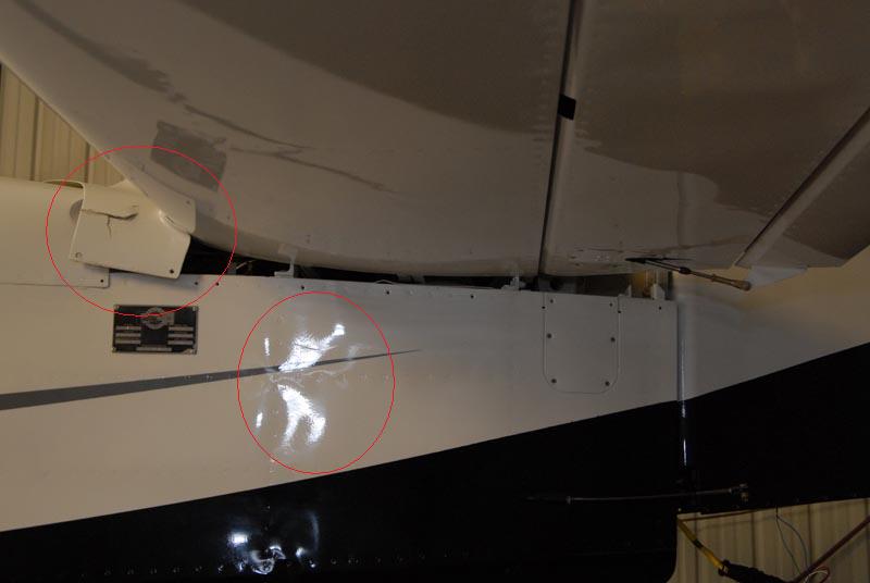

IDENTIFICATION
Regis#: 78MU Make/Model: EXP Description: RV-10
Date: 09/26/2009 Time: 1827
Event Type: Incident Highest Injury: None Mid Air: N Missing: N
Damage: Minor
LOCATION
City: JEFFERSON CITY State: MO Country: US
DESCRIPTION
AIRCRAFT ON TAKEOFF, PASSENGER DOOR SEPARATED FROM AIRCRAFT, LANDED WITHOUT
INCIDENT, JEFFERSON CITY, MO
INJURY DATA Total Fatal: 0
  # Crew: 1 Fat: 0 Ser: 0 Min: 0 Unk:
  # Pass: 1 Fat: 0 Ser: 0 Min: 0 Unk:
  # Grnd: Fat: 0 Ser: 0 Min: 0 Unk:
WEATHER: SCT029 BKN045 260/08G15 10SM A2995

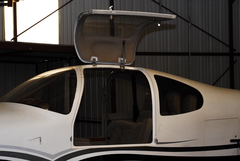

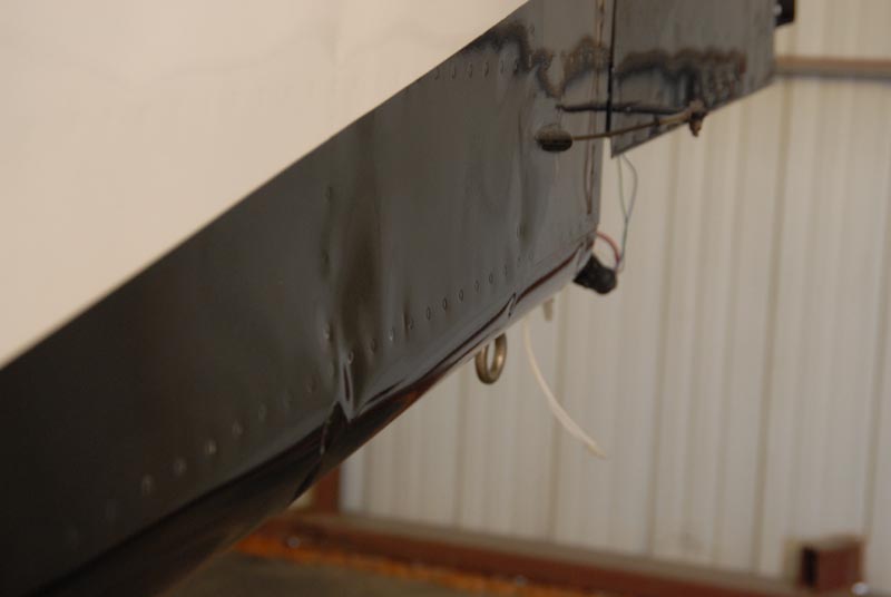

PostPosted: Mon Sep 28, 2009 12:56 pm    Post subject: Re: door Reply with quote
Probably the achilles heal of the 10. We use a secondary strap every time. Simple and reliable--I think. larry

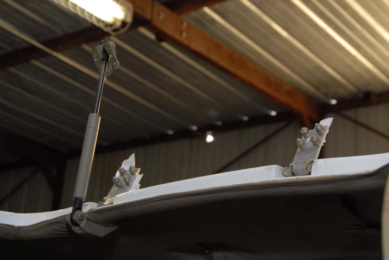

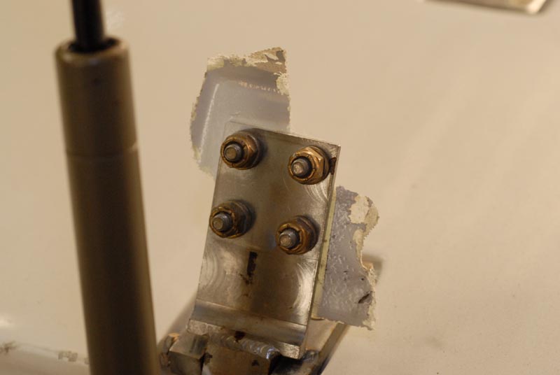

PostPosted: Mon Sep 28, 2009 1:51 pm    Post subject: door Reply with quote
It's really essential that everyone have some improved way of keeping the doors closed:  our metal door blocks are one way, buy you could also make your own, get Rivetheads, use a strap or something.  This is happening a LOT and it's only a matter of time until the results are very bad.

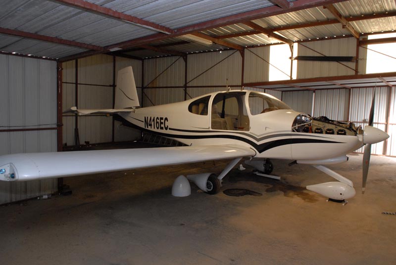

jesse(at)saintaviation.co
PostPosted: Mon Sep 28, 2009 2:07 pm    Post subject: door Reply with quote
Not N416EC. The number has not been changed on that one, nor has it been sold. As was mentioned, that's probably the achilles heal of the RV-10. I recommend that you get a strap or some other safety device so your number doesn't come up.
Jesse Saint

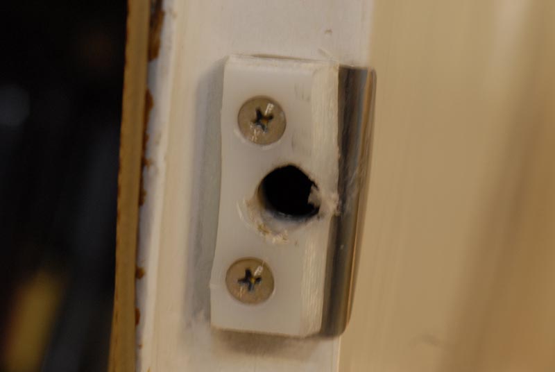

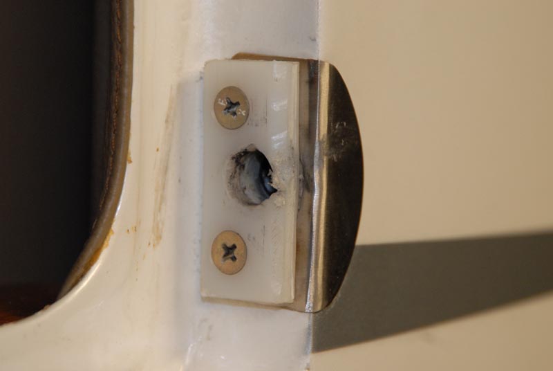

PostPosted: Mon Sep 28, 2009 2:22 pm    Post subject: door Reply with quote
Hi
These door departures are really quite troublesome. It would be interesting to now the following about each of the incidents to date.
  • When did the door departure occur (i.e. on takeoff, during climb out, cruise etc)?
  • Was the Van door warning installed
  • What kind of door blocks were being used (Van’s nylon, Rivethead, IflyRV10 etc)?
  • Were any other “secondary” latches / straps etc being used?

PostPosted: Mon Sep 28, 2009 2:43 pm    Post subject: door Reply with quote
Ok here comes my 2 cents. It appears that there could be some type of design change, better locking longer door pins, longer throw on the pins or a air dam of some kind that forces the door shut and not let it open with a air load in or. Has any Lanceairs lost any doors in flight. Looking at the Cirius doors it is almost impossible to loose on of theirs from the looks of it.
I think when I get to that point I will have to take a harder look at this and see if I can build in more safety into this. I do agree that the door should not come off and cause a major damage or loss of aircraft due to a door opening.
It is time to put some major brain cells into this issue. I think it will take more than metal door blocks to really get this resolved.
I am open to any and all ideas.

PostPosted: Mon Sep 28, 2009 2:54 pm    Post subject: door Reply with quote

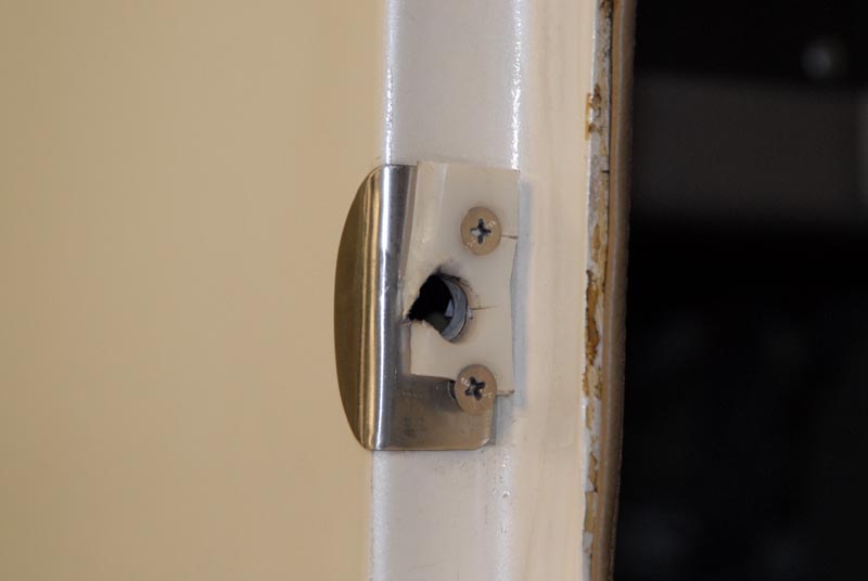

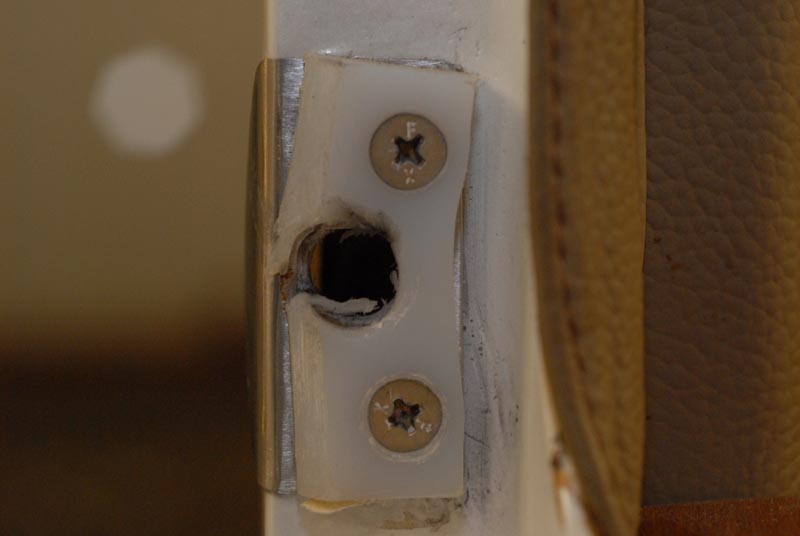

I disagree that it will take more than metal blocks to solve this. I switched to the metal blocks and have very solid latch on mine. Connect the proximity switch circuit to your EFIS alarm system, and it will scream at you when you advance the throttle and don’t have all 4 pins locked. The solution is not difficult or expensive.

PostPosted: Mon Sep 28, 2009 3:23 pm    Post subject: door Reply with quote

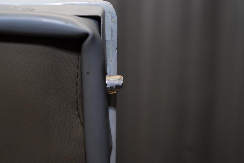

More 2 cents…Remember to make sure the door pins go all the way through the upright F-1005 and F-1042. I have mine such that there is solid pin (with no taper) engaged in the hole in these uprights. That is a lot of strength in shear with this, so as long as the door and latch is closed properly it is not going anywhere. Now if the door can flex in the middle thereby pulling those out such as if the cabin were pressurized that could be a problem.

[quote="speckter(at)comcast.net"]I disagree that it will take more than metal blocks to solve this. I switched to the metal blocks and have very solid latch on mine. Connect the proximity switch circuit to your EFIS alarm system, and it will scream at you when you advance the throttle and don’t have all 4 pins locked. The solution is not difficult or expensive.
Gary Specketer
I agree,
I have the Door Guides and Pins and have been flying my RV10 for a year now without a problem. I have redundant warning switches in my setup. One reed switch is for the DOOR LIGHT warning on the instrument panel. The other is for the Garmin 900X which gives a DOOR OPEN warning above 1800RPM. Plus, in my checklist, when it comes to "DOORS CLOSED and LOCKED" the Pilot is required to physically check both doors closed and locked. Triple checks!
Zack

I disagree that it will take more than metal blocks to solve this.  I switched to the metal blocks and have very solid latch on mine.  Connect the proximity switch circuit to your EFIS alarm system C and it will scream at you when you advance the throttle and don’t have all 4 pins locked.  The solution is not difficult or expensive.
Gary Specketer

On my doors, when the stock Van's handle locks down, both locking pins go THROUGH the phenolic guides and are firmly through metal frame. The phenolic blocks are not designed to hold the door close, merely to guide the locking pin through the metal!
I have warning lights on the aft pins - if the pin does not go through the metal hole, the light does not get turned off.
And part of the before takeoff checklist is to ensure that the handle is locked into position and that you cannot push out on the door.
You must make this check a slow, methodical check every takeoff and not trust your seat-mate to do it correctly.
grumpy

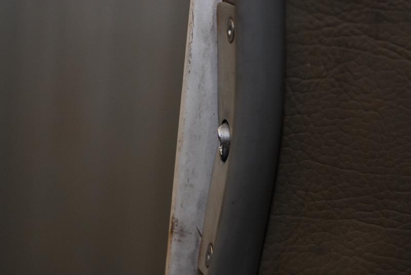

The 416EC incident seems to indicate that the nylon blocks are definitely not the way to go when installing doors.
Anyway, in my not so humble opinion, an improperly unlatched door should not result in a near death experience in a light single.
Cheers
Les

I do not lock the doors when flying solo. Don't want to hinder emergency evacuation.
grumpy

Guys,
On my doors,= when the stock Van's handle locks down, both locking pins go THROUGH the= phenolic guides and are firmly through metal frame. The phenolic bl= ocks are not designed to hold the door close, merely to guide the locking= pin through the metal!
I have warning lights on= the aft pins - if the pin does not go through the metal hole, the light= does not get turned off.
And part of the before= takeoff checklist is to ensure that the handle is locked into position an= d that you cannot push out on the door.
You must= make this check a slow, methodical check every takeoff and not trust your= seat-mate to do it correctly.
grumpy
N= 184JM

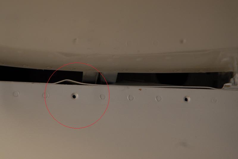

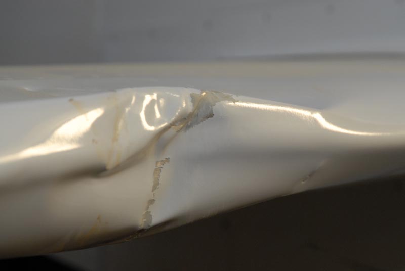

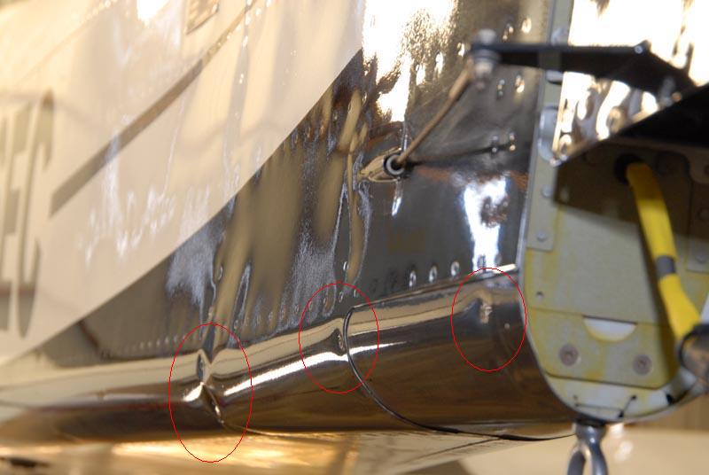

N416EC had the reed switches installed as well and it took no more than10 degrees of motion before the light came on. The problem is that in less than 10 degrees, unless your hand is firmly gripping the door handle, it can (and will) come open due to the pressures acting upon it. Just checking that the lights are off and the handle in the locked position, IMHO, is not enough. No offense, but having flown over a year with no mishap is not an indication of a safe system, but rather possibly a cause to get careless. I would not consider a latching mechanism that does not have a good length of rod passing through (not just nesting into) a structural metal part, as I understand is a feature of one of the aftermarket options. I want as much rod through a solid base as possible, in case the handle latch does decide to break lose in flight (It can happen. Ask me how I know!). A strap, as I have mentioned before, is the easiest way I can imagine to safety the door. It also allows for some air conditioning during taxi without needing a hand on the handle.
Jesse SaintSaint Aviation
